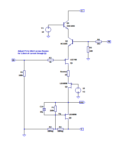

Hi Ricardo,
I've been tinkering with a similar design in simulations. Nothing in real life yet. Similar to your design but with a rush cascode for the feedback and a mu-follower for the load. These two added elements made a significant improvement in performance with a 2nd order dominate monotonically descending distortion profile. In addition, the use of a P type input device provides for negative phase 2nd order harmonics with minimal phase shift from 90 degrees (in simulations at least). This was my goal based on inspirations from Nelson Pass's research on the phase of harmonics.
Note: To achieve this I also used a single transistor VAS based on the the KSC1845 (not shown). This was needed to keep the phase shift to a minimum. The VAS is buffered to keep dissipation down.
The rush cascode is inspired by Juma's thread
25W Class A amp with Lateral MOSFETs. Specifically the design from post #180.
The Q5 is a LSJ689 to allow for rails to approach 50V (I simulated in the 38 to 45 range). Q3 is also a LSJ689, but this is just to make use of the other half. If could also be a BJT. I didn't seem any material differences in simulations.
The Mu follower does make setting the current through Q1 a bit tricky. The value needed for P1 can vary quite a bit with Idss of Q1 and Q3. I added Rsense as a way to measure it and allow P1 to be adjusted to a specific current. 1mA in this example. This current will impact DC offset. A value needs to be selected such that the Servo (or whatever mechanism you are using) has enough authority to address it.
The design looks promising in simulations and I have it on the to-do list to try and actually build it. I can share more details if anyone is interested, but don't want to highjack the thread from Ricardo.

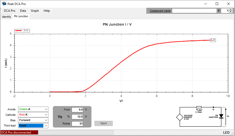

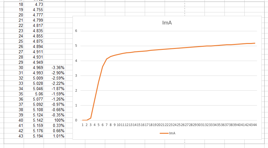

I used an atlas tracer to get the ccs response but the atlas does not go higher than 12V so I used a bench psu and got a better view when powering the ccs up to 43V.
Using 40V as reference...at 39V current is -0.35% lower and at 41V 0.33% higher... not very stiff but it works.
Thank you Mark for showing the way to use the curve tracer 🙂

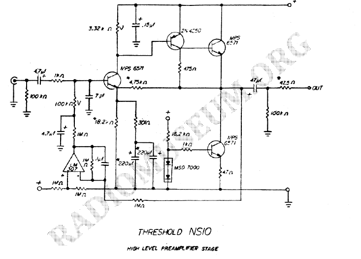

As you are surely aware, with a singleton, DC offset doesn't naturally NULL. So a servo or some other means is needed to keep it in check
The Threshold NS10 preamplifier (designed by Nelson Pass in 1978) uses a singleton input, plus a DC servo to keep it in check. Schematic below. DC servo circuit includes the opamp at bottom left.

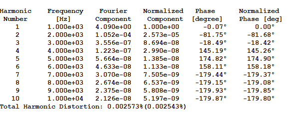

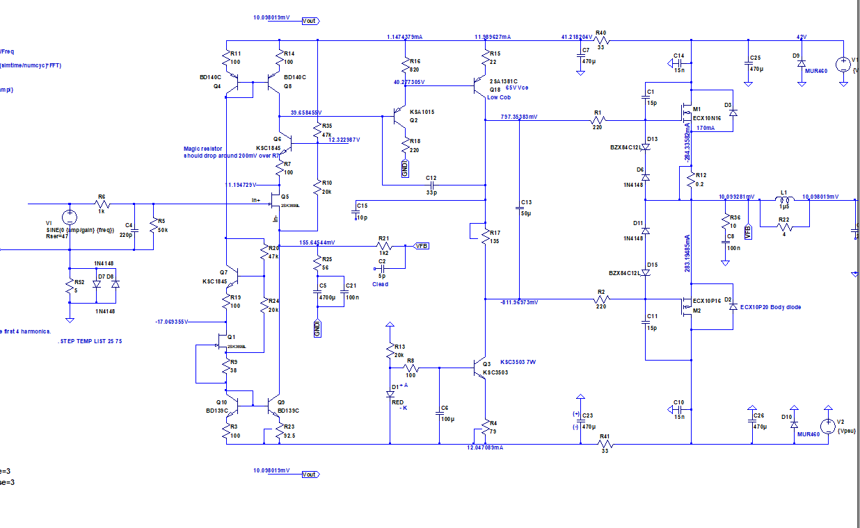

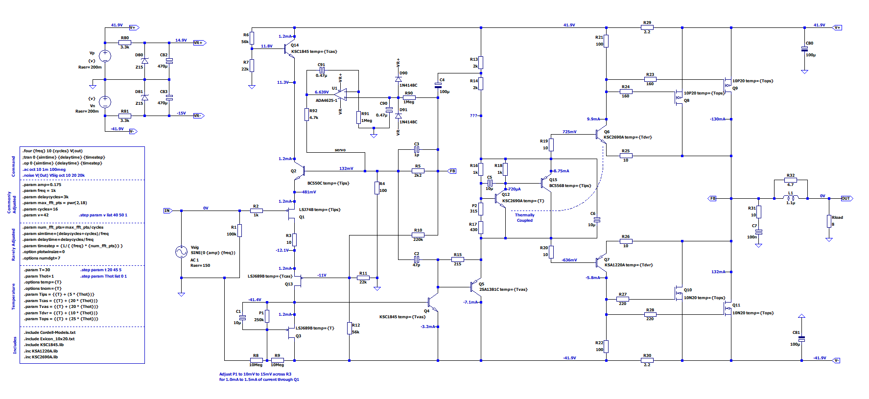

Here's the design I mentioned in post #23. It only exists in simulations 🙁. In this imaginary state, it achieves predominately 2nd order negative phase harmonics (The attached LTSpice error log is 1W into 8Ω at 1kHz)
In real-life, I image it could be a bit tricky to stabilize. It uses a two pair CFP lateral mosfet output stage without emitter resistors. Even with the use of lateral mosfets, the lack of emitter resistors makes the bias settings unstable with a conventional single transistor bias network. Therefore, it uses a CFP bias network. The design is borrowed from user Bonsai's NX amplifiers. With this arrangement, it seems to be much more tolerant of power supply and temperature fluctuations.
To set the bias, you'll need a power supply with a CRC arrangement. Measure the current across the "R" in the CRC of the power supply. Then back out the current across R29/R30 to get the OPS bias current. This assumes the pairs would be Exicon's matched ECX10N20-S / ECX10P20-S devices.
The compensation is Miller Input Compensation (as Bob Cordell refers to it). C3 adds a bit of lead compensation
Q3 is the Mu-follower for the active load on Q1. P1 allows you to set the IPS current which will otherwise vary due to the range of Idss values possible between Q1 and Q3.
Q13 is a driven cascode. When auditioning in real-life, I'd probably want to tinker with removing R10 to see if a cascode vs driven cascode makes any sonic differences.
Q4 is the VAS and Q5 is the buffer since Q4 is only a TO-92 device. This keeps the dissipation in Q4 more manageable. I opted for this arrangement to allow for use of a single device Low Cob transistor. This keeps the overall harmonics predominately 2nd order with minimal phase shift from 90 degrees. I don't know how much this actually matters - but it was the goal of this design after reading a lot of Nelson Pass articles and posts on the phase of harmonics.
I mentioned in post #25 that it had a problem with output impedance. This was an error on my part... forgot to ground the input.
DC Offset is managed with a servo. You could also try a discrete solution without an opamp. Though in simulations, it didn't seem to keep DC nulled when ambient temperature changes were introduced.
Hopefully I'll get around to building it one of these days to see if it actually works 🙂. Which means the Ricardo's design is much better because he's actual build it :worship:
I've attached the LTSpice files if anyone whats to tinker with it.
Thank you Brian
You have really pushed the singleton idea to a new (higher) level.
Food for the mind it is.... will take me a while to grasp all the concepts but for now I already like the servo layout although the injection resistor R92 seems to small....
