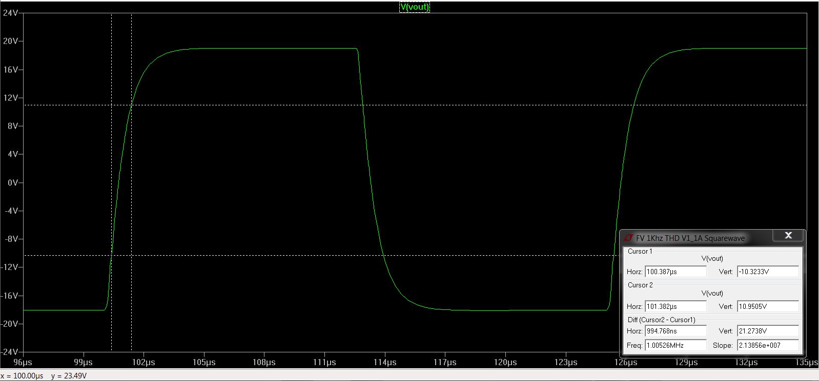

what about slew rate of this amp? how can i see in LTSpice if positive and negative slew rates are equal?
One way is to use the cursors on the output waveform and set them say 1us apart on the upward slope and then repeat on the downward slope.
This (its not your amp) shows the input set to 40 KHz and the cursors approx 1us apart. The slew rate here is just over 21 volts per microsecond.
