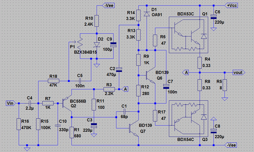

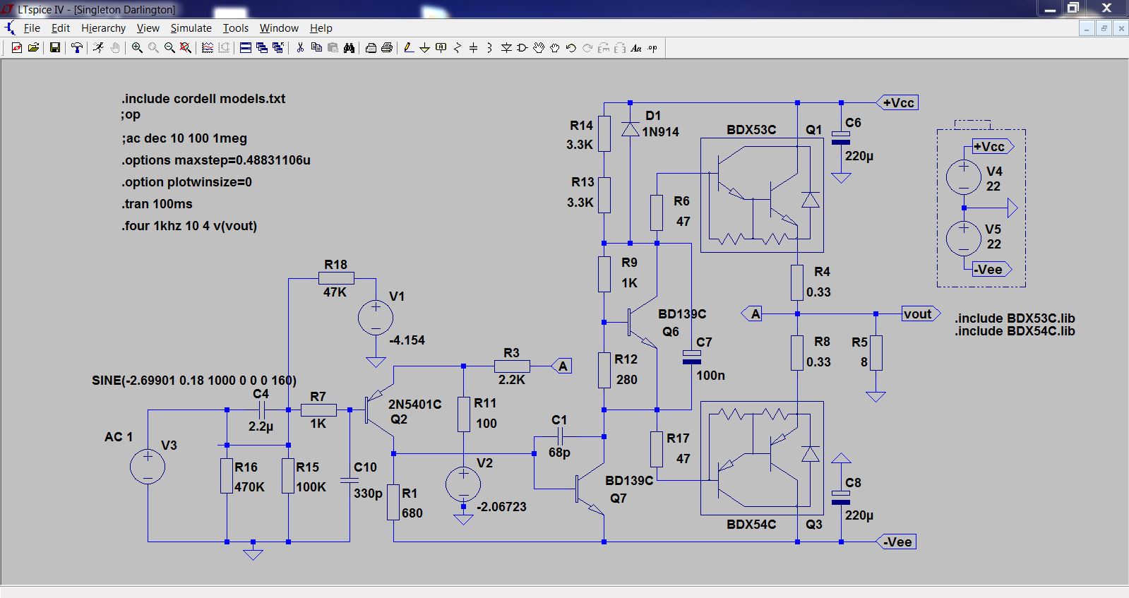

Hello.I had some spare parts and there has been some time since i last built a diy amplifier so i designed this small amplifier with singleton input stage and darlington output. I will be gratefull to read your comments...Supply rails will be about +-20V. D1 diode is a BAV21 and not OA91.
I read here in the forum that this diode helps with bootstrap rail sticking..

Its a classic configuration and looks essentially fine 🙂
Thoughts... the DC offset looks like it will wander without some form of temperature compensation (and that's easier said than done), or without the use of a servo.
Personally, I'm not a fan of power darlingtons. Have you considered FET's or even Lateral Fet's ? That could make a really nice amp. Zobel network on the output maybe.
I think that the DC offset has to do with the changes of Vbe junction of input transistor Q2 due to temperature change.However i dont know what the dc offset range will be.So the best solution is what you suggest,a DC servo.
For the time being i will try these darlingtons because i want to get rid of some parts sitting in my box...I will try it in simulation though.

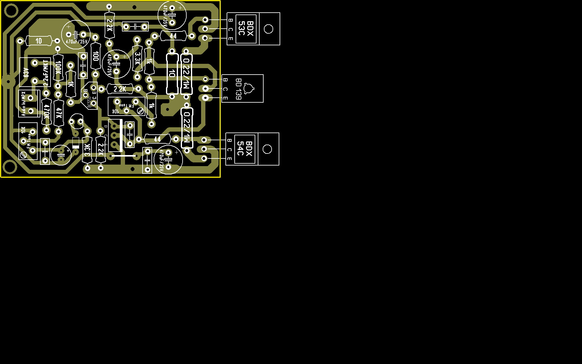

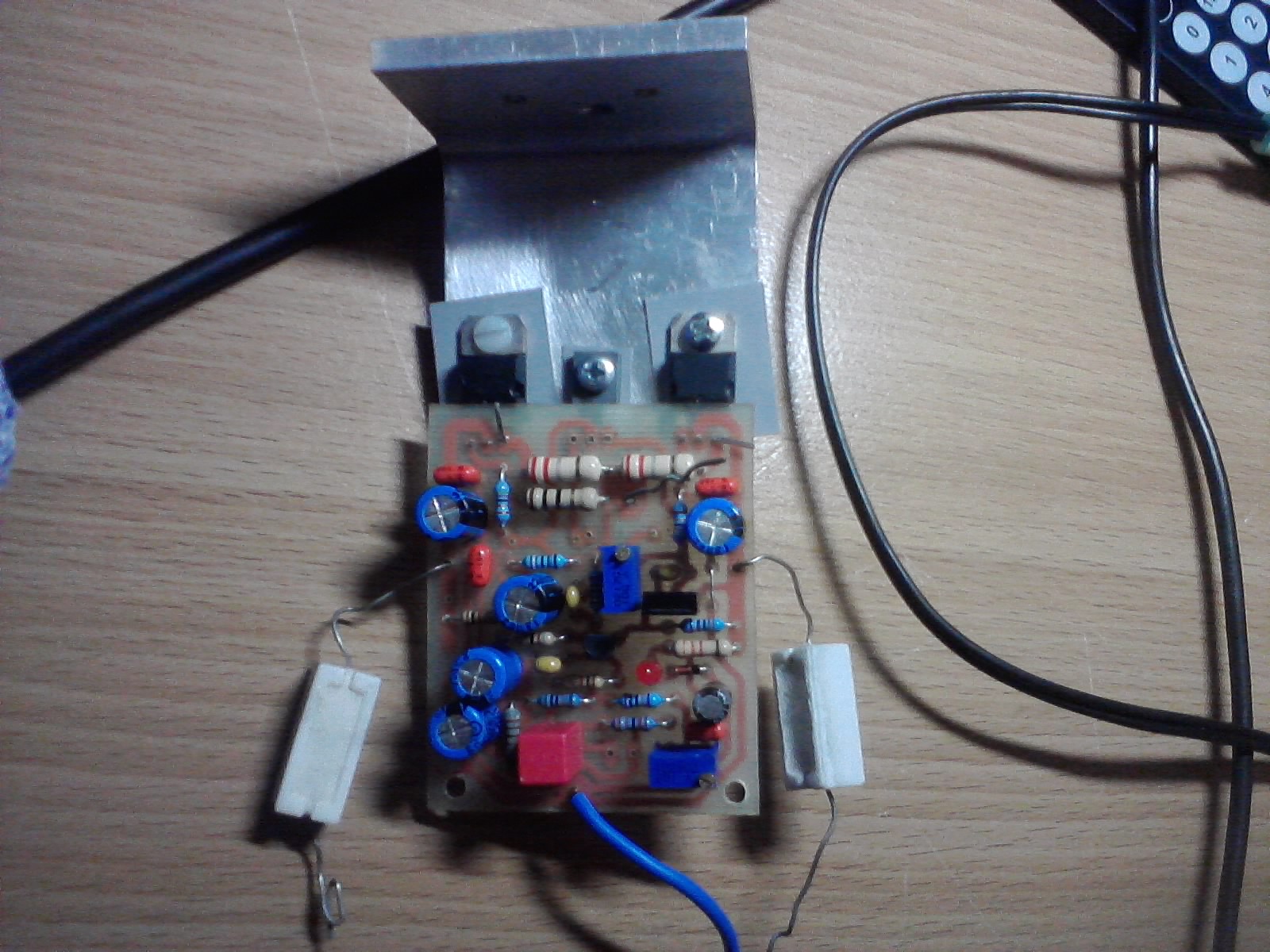

I made a small pcb layout 5x6 cm which includes zobel network. this pcb is just at the beggining and not tested for errors..

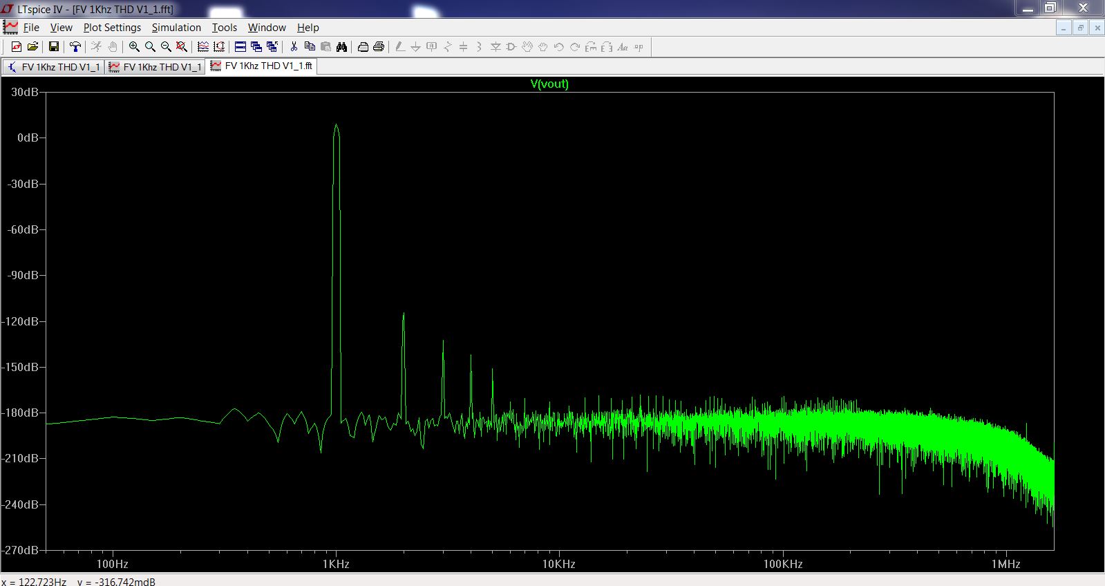

Here are the LTSpice files if anyone is interested.First decompress the zip file so you are able to use the darlington spice models.
Nice amplifier that should work.
You have done a good job.

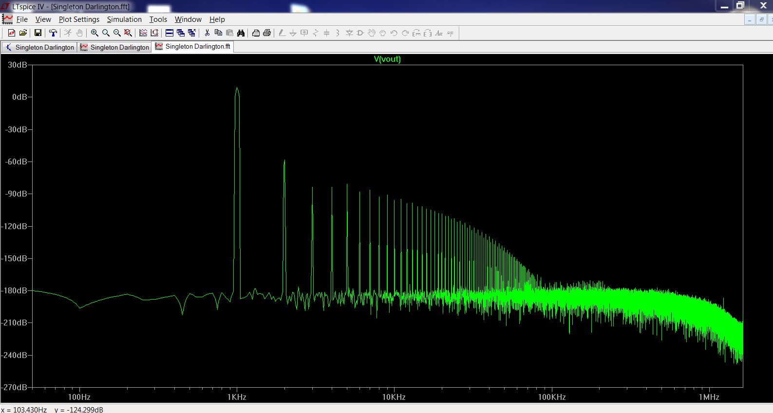

Yes, the 2nd harmonic predominates. I've no doubt it could be tweaked but just how far is hard to say.

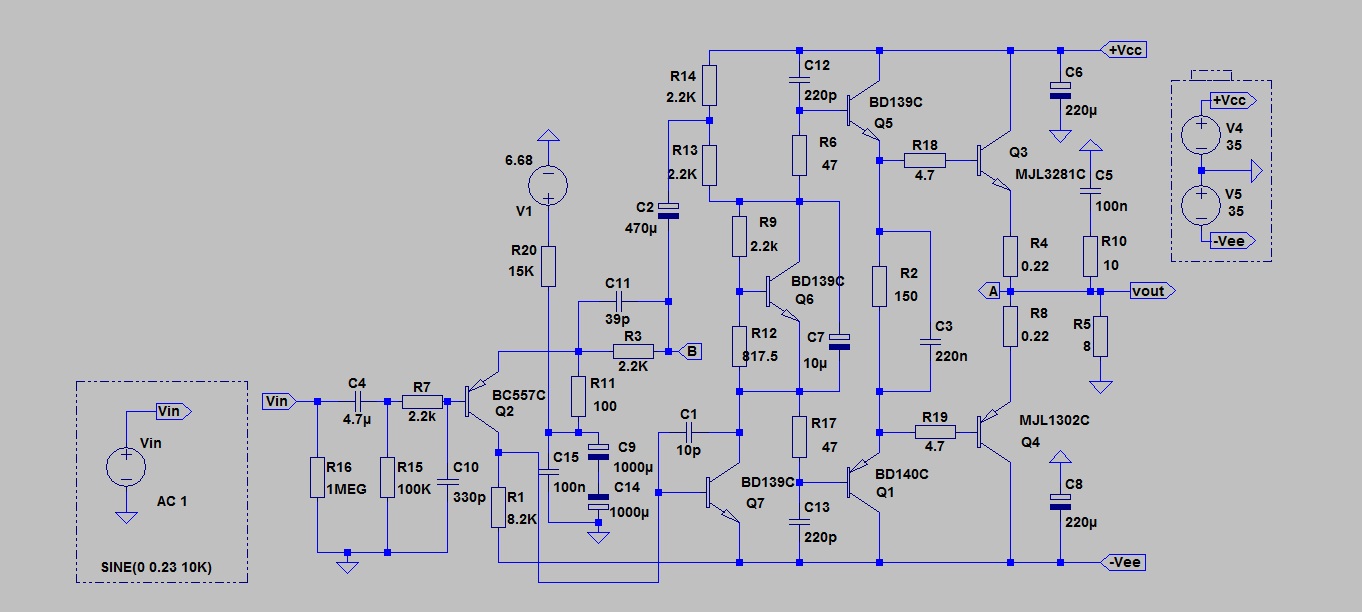

Hello! I built the amp and it worked fine.There was a mistake on the pcb regarding pin layout of BD139 transistors which i noticed after i etched the boards but i overcame it. The amp sounded really nice the poor darlingtons used in the output stage,with strong bass and very clean vocals. I think it is due to dominant 2nd harmonic content.
I decided to move on to a new design based on EF TYPE II Output stage.
I attach the LTSpice file of the new amp.
Any suggestions appreciated!!
If it sounded really nice, why change to a new design ?
In the first design i used BDX53C-54C darlington type transistors which are not linear,have low Ft and dont have an adequate Safe operation area to be used with +-35V power supply and output power of 50-60watt rms / 8ohm.
I'm sure it does sound good I see you changed the input stage biasing around.
Yes i changed it after reading bob cordell's and douglas self's books about dc servos which state that this is a better point for the servo,whether it is a trimpot or an opamp.
i am planning to use 2SC5200/1943 for output and 2SC4793/1837 for drivers as i already have them.
Here are some photos of the initial design
