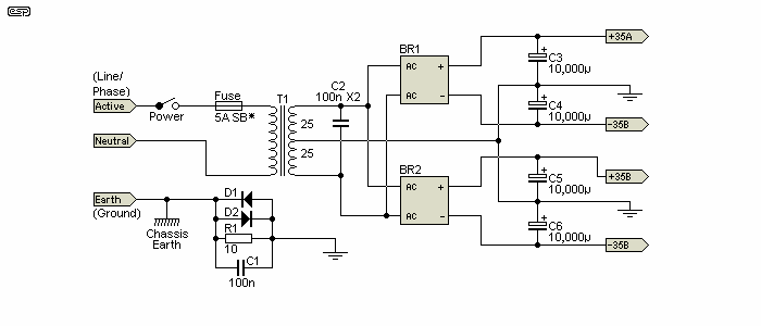

I am building a stereo power amplifier and plan to use a single transformer with dual secondaries.
Each power amp board will have it's onw rectifier bridges and smoothing capacitors.
As the transformer has dual independent secondaries, I am using two bridges (one for V++ and another for V--)
As it is a stereo power amp, I will have four bridges total.
My question relates to the way I am planning to connect the single power amp to feed both amp boards in parallel.
Can I simply parallel the two positive bridges and the two negative bridges in the secondaries of the TX without fear of GND loops ?
I am posting the schematic of the PSU hoping for comments on possible issues and solutions.

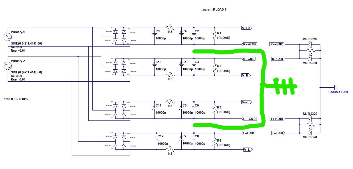

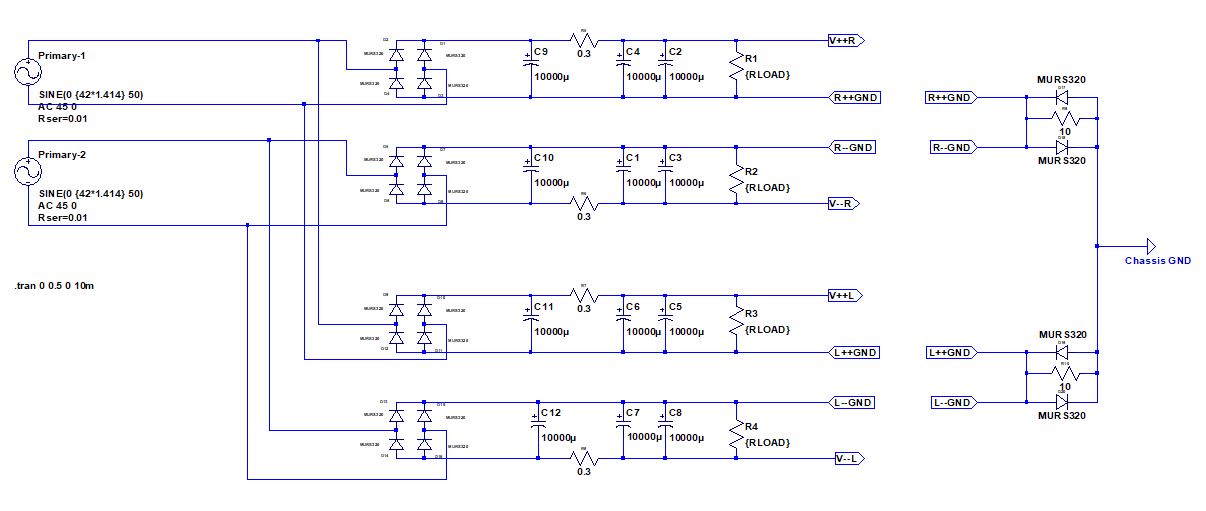

But in fact my drawing had an error.
In reality both R++GND and R--GND only join in the loudspeaker GND return as in the new picture.
I am worried about paralleling the circuits using only one TX.

Thank you bansuri
I can not change my layout... the boards are already etched.
Initially my intention was to use one TX for each channel but I am stuck with only one TX so that is why I posted this schematic
