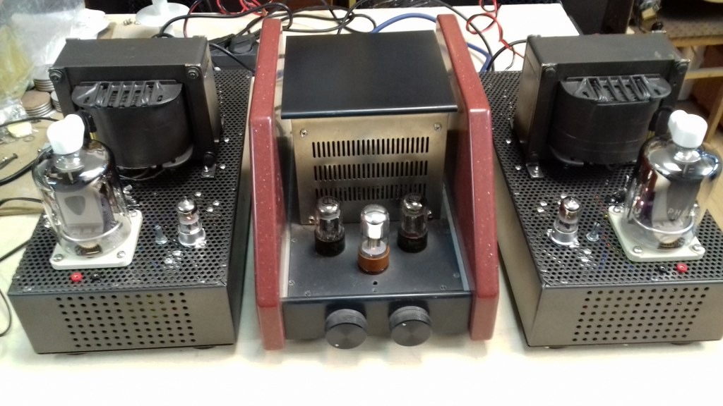

never mind that, look at the 2nd photo in post 31, here we have a naked amp, rated for over 1kV and yet an open bottle of beer - could be dangerous !

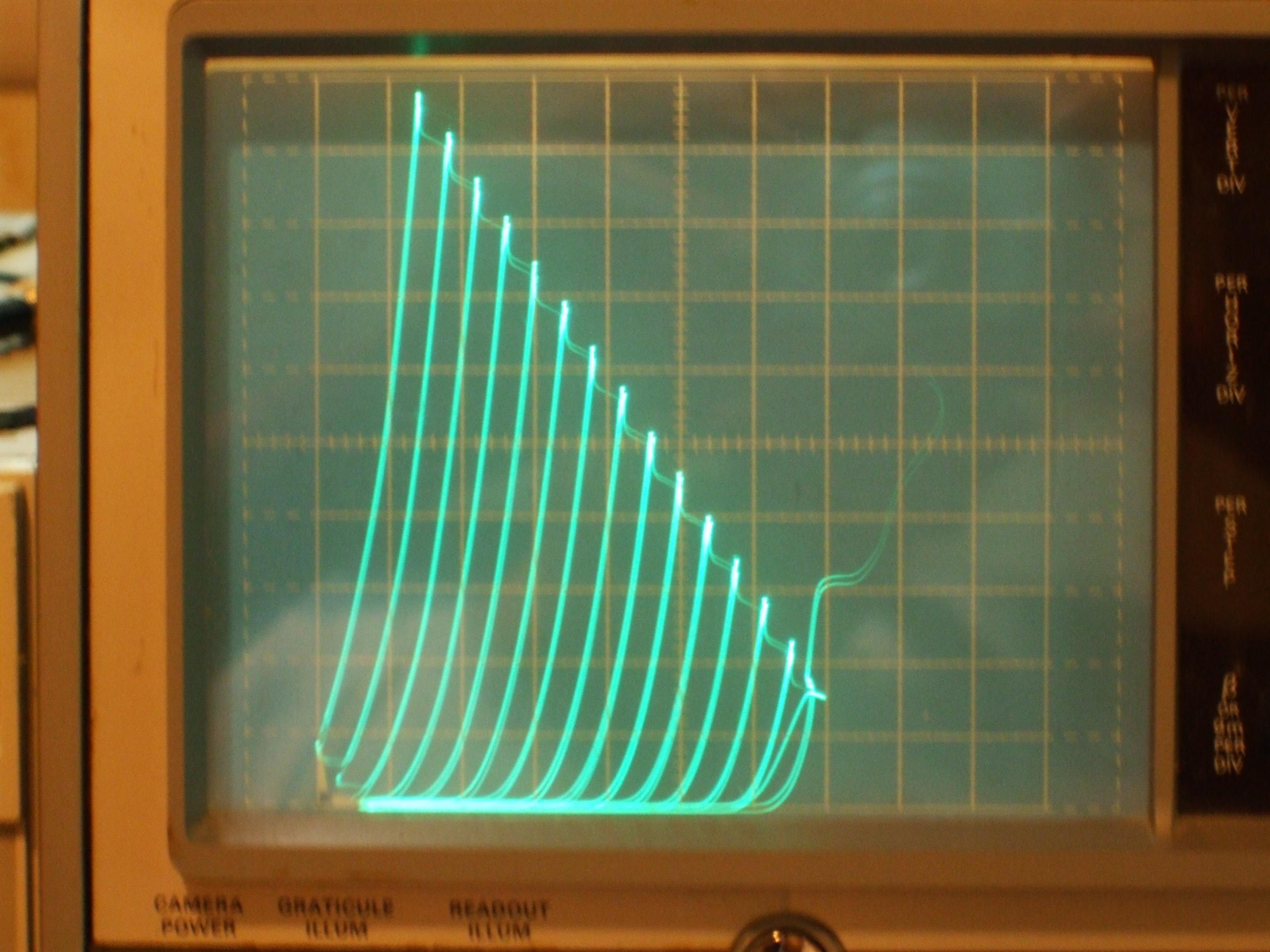

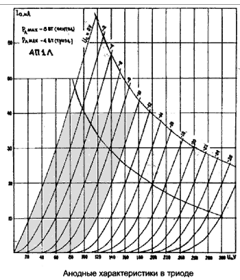

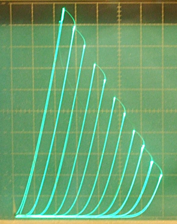

Yup, excellent triode curves for 4P1L. Just need a bunch in parallel. pics 1 & 2

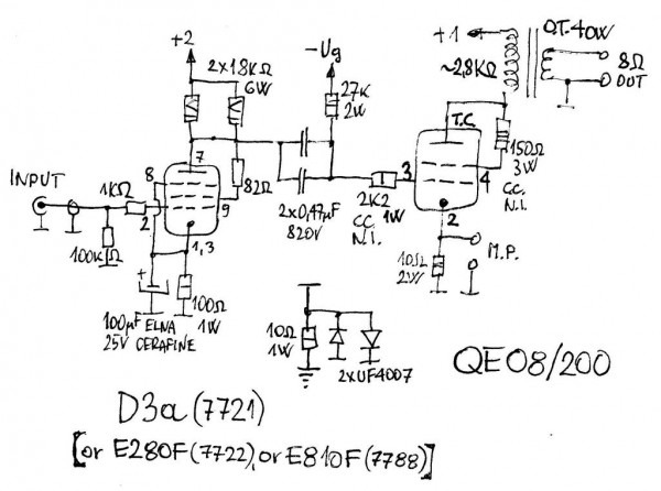

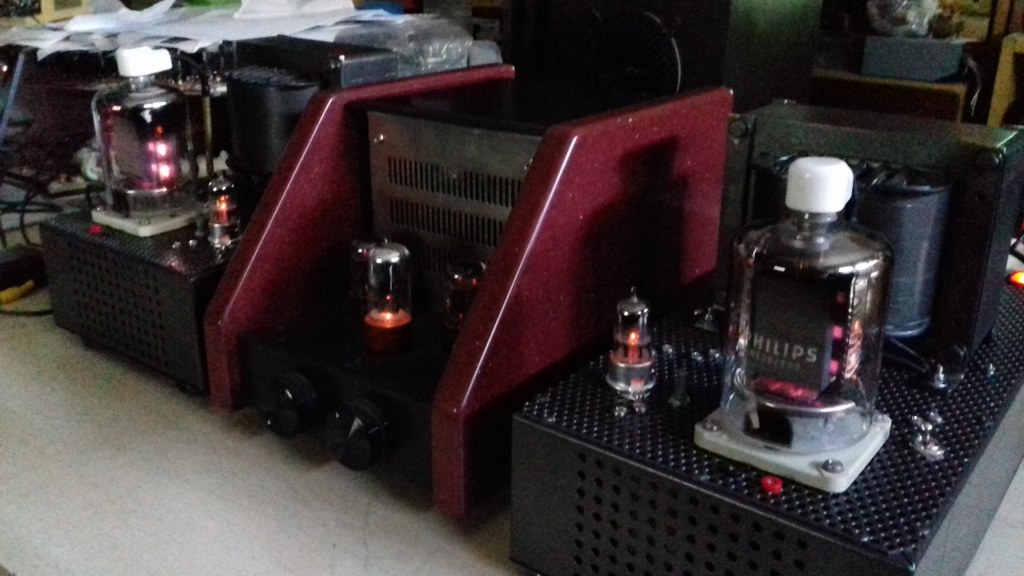

Could also go for a new series Schade N Fdbk on a big beam pentode, like a 36LW6. Pics 3 is using 21HB5A as a similar sample. Looks like a DHT 211 I think.

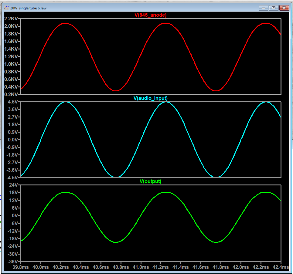

My just for fun contribution.

.SUBCKT 845 A G K
+PARAMS: MU=5.355 ERP=1.5
E8 8 0 VALUE={(V(A,K)-va0)/KP*LN(1+EXP(V_6()))}
Eam am 0 VALUE= {2*Pow(V(8),ERP)/KK1}
GA A K VALUE={V(am)}
D3 5 k DX ; FOR GRID CURRENT
R1 g 5 {RGI} ; FOR GRID CURRENT
Rak A K 1G
Rgk G K 1G
C1 G K {CGK}
C2 G A {CGA}
C3 A K {CAK}
.MODEL DX D(IS=1N RS=1)
.ENDS

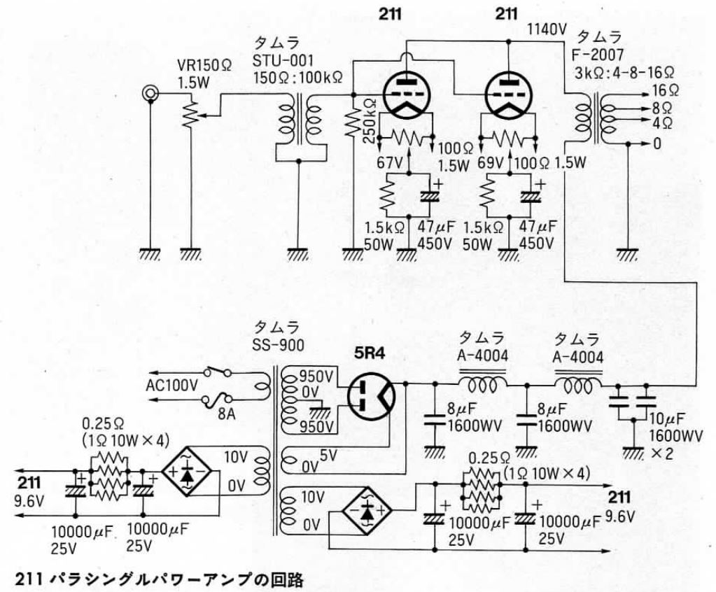

Finding a 150:100k audio step up transformer capably swinging 134 volts p-p: consider switching to bourbon.the input capacitance of this thing
kilovolts of funMy just for fun contribution

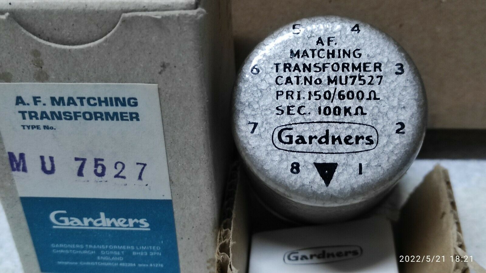

I bought some of these Gardners (new) at a ridiculous price.Trovare un trasformatore step-up audio 150:100k capace di oscillare a 134 volt pp: considera il passaggio al bourbon.
That is not actually the harder part if there is no DC current in it. It's a reverse 26:1 transformer where you can use mumetal, for example, that has got permeability 10+ times better than GO laminations. Enough turns to deal with the voltage and a good winding geometry. The harder part is driving the 845 through such SUT trnaformer...35-40 nF at least up to 20KHz..Finding a 150:100k audio step up transformer capably swinging 134 volts p-p: consider switching to bourbon.
I guess the guy who built that power amp with the 211 was driving it with a preamp using the same transformer in reverse mode: 100K:150R.
