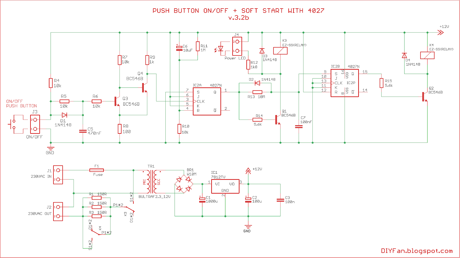

Recently I got this PM,Since I feel it isn't a question to ask via PM so I put it here with a proposal.

Why not use a push on /push off DPDT mechanical switch to activate the relay then use the extra contacts to activate the LEDs?
I cheat. Why re-invent the wheel, right?

Thanks PRR but i dont understand nothing about trigers and how they work. So i need some to help me to fix this circuit to work with 4013 so can some help me ?
