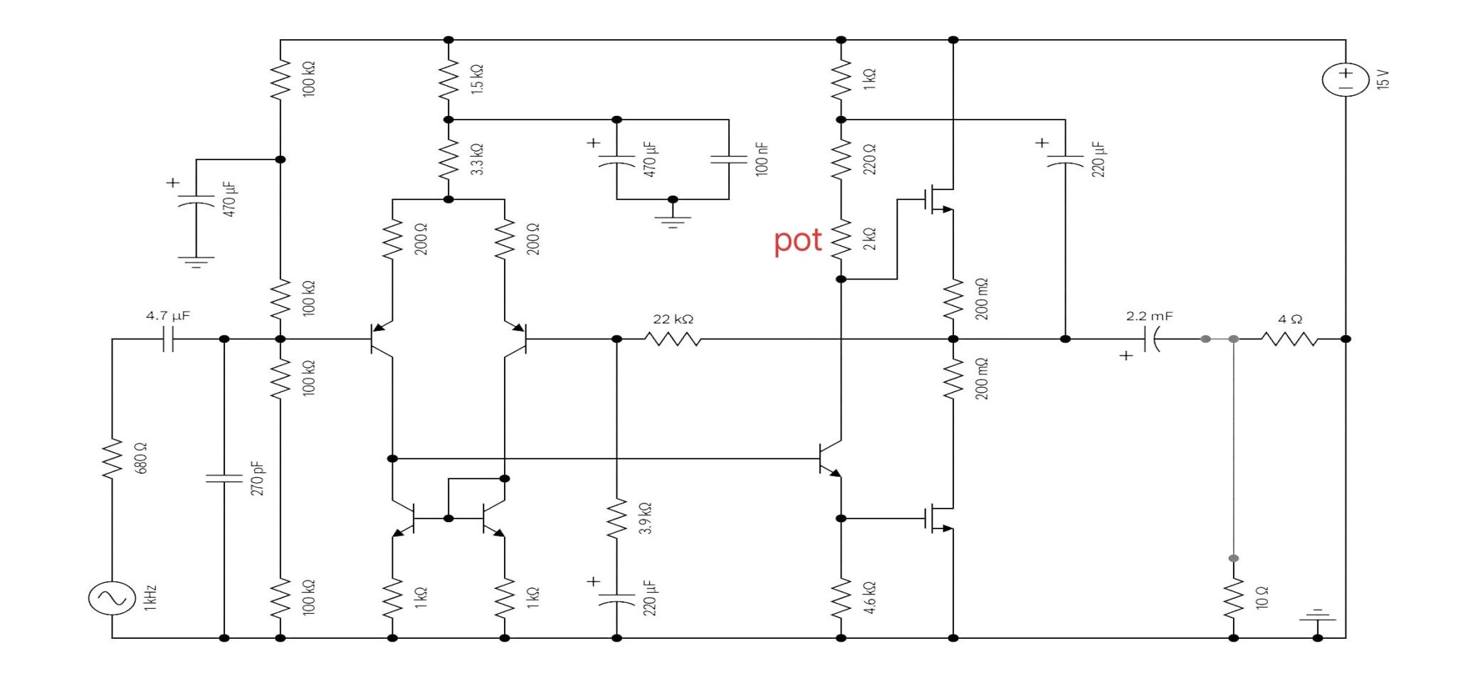

It has to be 15V regulated.
Because you have the input connected to the supply.
If you have unregulated, then will be hum coming from supply direct to the input.
One other solution if you have unregulated, is to have a capacitor between the two 100kOhm resistor to ground.
This will filter the supply and make it clean.
To your question.
I think you need a compensation cap. Across T5.
To your question.

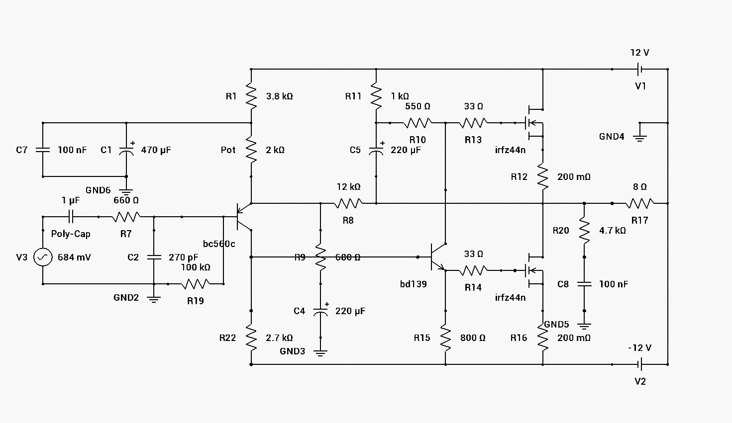

Hi, HAYK, 2days ago I made this jlh 69 mod , everything working fine but my problem is after few minutes of song listening output offset changes , is this just because of MOSFET behaviour or heating causes?? Or need more fine work for more stability? Or this is anykind error?

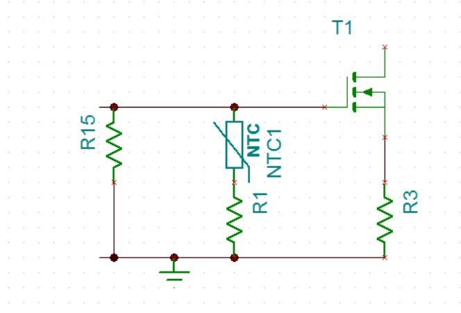

NTCs have 2 parameters, resistance at 25°C and coefficient K.
https://en.wikipedia.org/wiki/Thermistor.
Use Tina simulator (free download from TI) it has models to simulate.

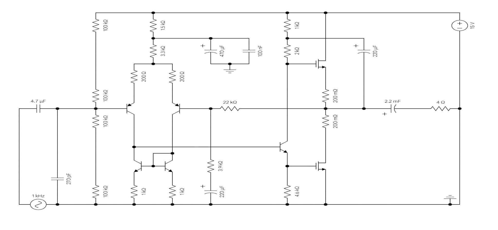

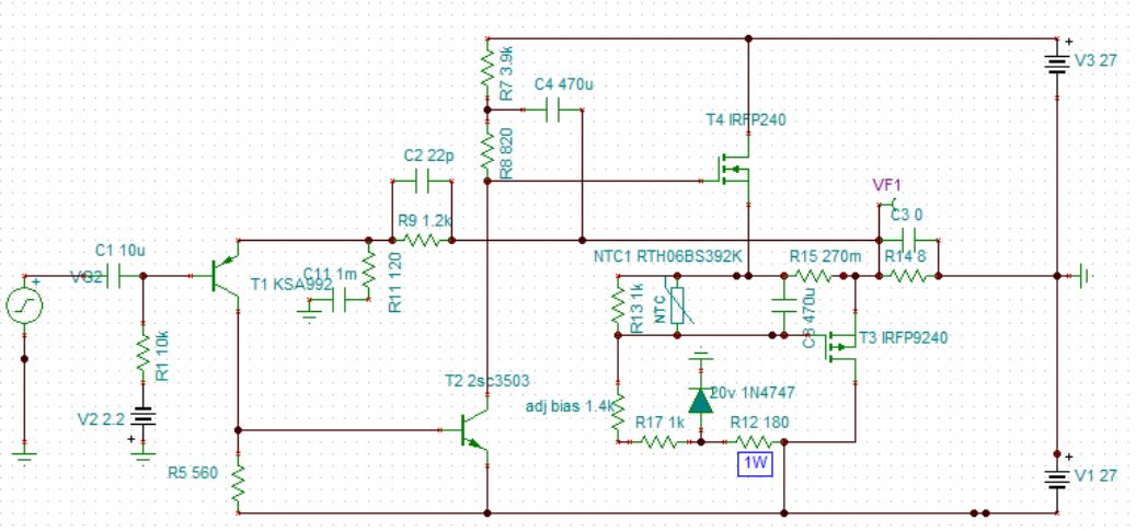

About 2 years ago, I posted a 4 transistor, 40W, 0.0004%THD @7W1khz classA amp on EEVblog website using lm334 as temperature compensation element. The output stage, I have tested it for several months using step up transformer.
I replaced the lm334 by NTC and here is the amp that might interest you. The first 3 transistors have the same circuit as yours, the fourth is an SRPP. The outputs for low power can be replaced with cheaper IRF640/9640.
