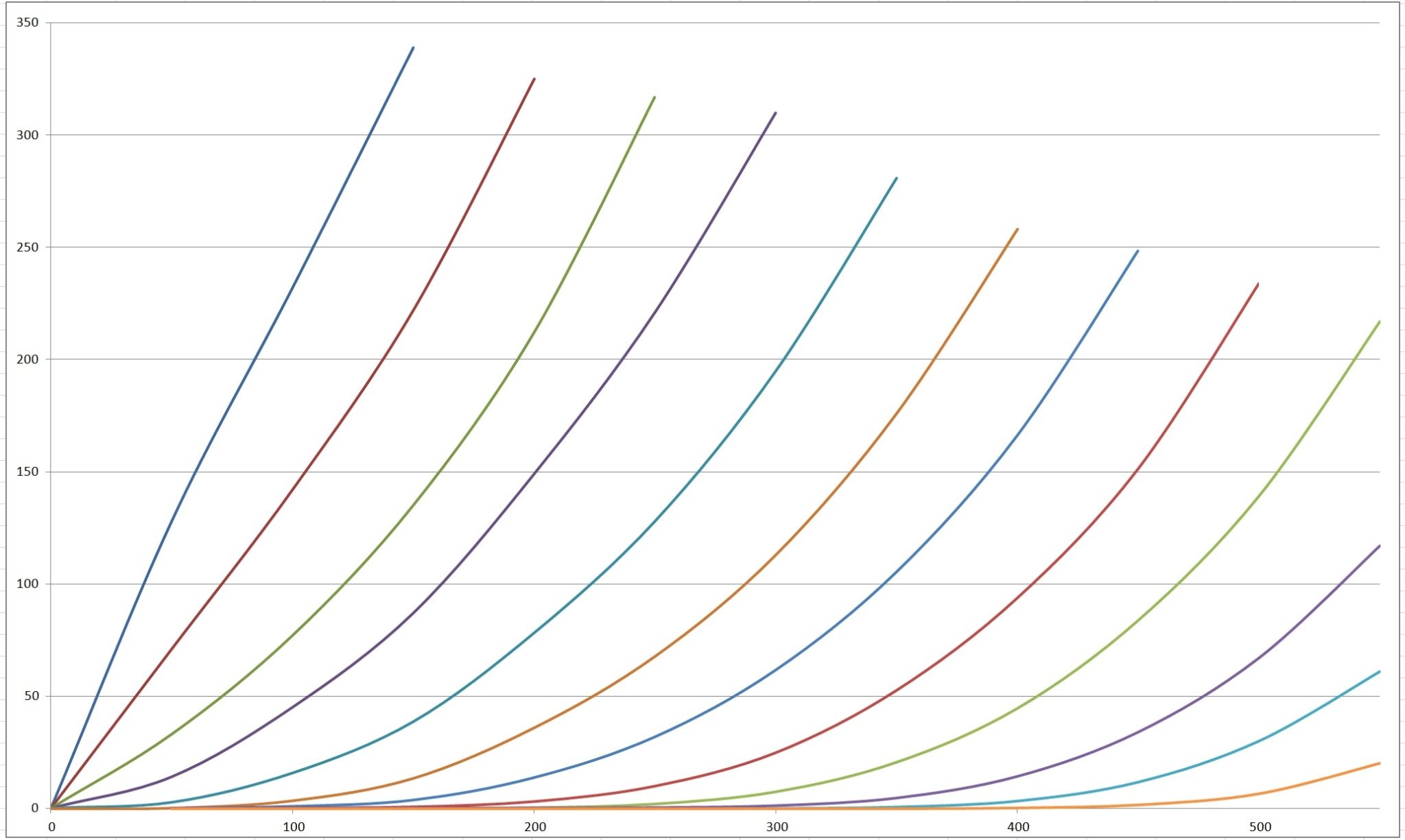

I wonder how George, Tubelab, used it initially.
What is the original circuit of Tubelab?
The original application was a two stage vacuum tube amplifier with each pentode stage turned into pseudo triodes via the cathode drive / plate to grid feedback method. See attached curves traced by hand from a pentode tube in this configuration. The uneven spacing is due to the resolution of the power supply's meters.
The concept was applied to a pure semiconductor design in this thread. My involvement starts on post #597 and continues sporadically. The first working FETSET amp appears in post #872
