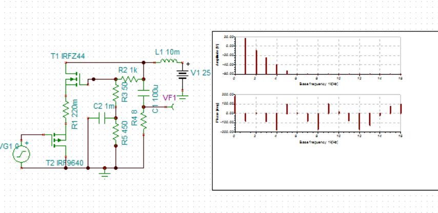

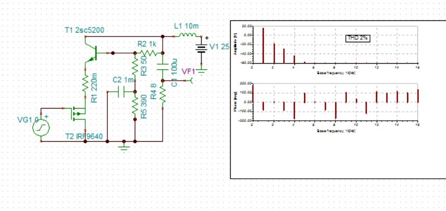

Am I looking at this correctly? It looks like a single stage rush cascode using MOSFETs, with a variable reference point for the top FETs' negative feedback. The LT1178 seems to have many undesirable characteristics in this application, though.
I tried out the rush cascode with pmos and nmos for a gain of 7 biased about 1A. The THD is 7% for 7vp.
With pmos and npn, gain 6, I get 2% for 6vp.
I don't know how the bias is temperature stabilized for nmos, I would use an NTC, with npn, it might not be necessary.

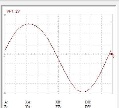

The major problem for me with this output is the phase of the second harmonic. To get front stage sound, the positive going signal should be more amplified then the negative. Here, it is the reverse which results back staged sound.
I've not played that much with simulations, but different pentodes at different working points caused different phases of the 2nd harmonic.
It should be the same with mosfets as well. Have you tried increasing the bias current?
