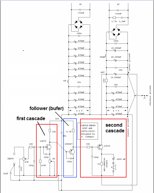

To make a useful service to all who are interested in that type of components (v-fet, sit, power j-fet), comparing their characteristics to use these at the best, i have prepared the following page:
AMPLIMOS one stage amplifiers amplificatori audio monostadio
On this occasion, thank you in advance who will give me more or better documentation (Datasheets) for these categories of audio devices, so i can put on website. 😎
Francesco

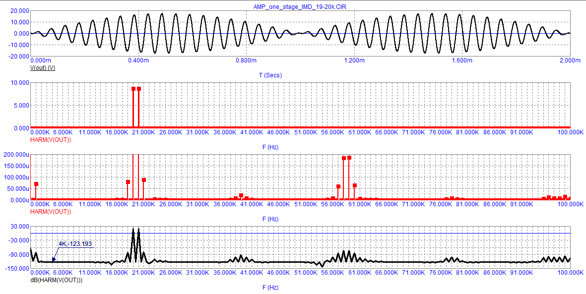

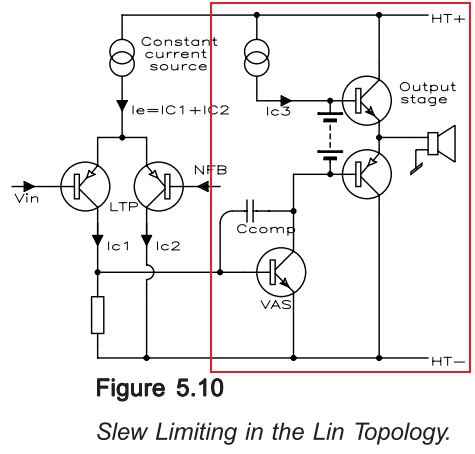

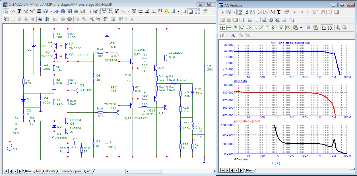

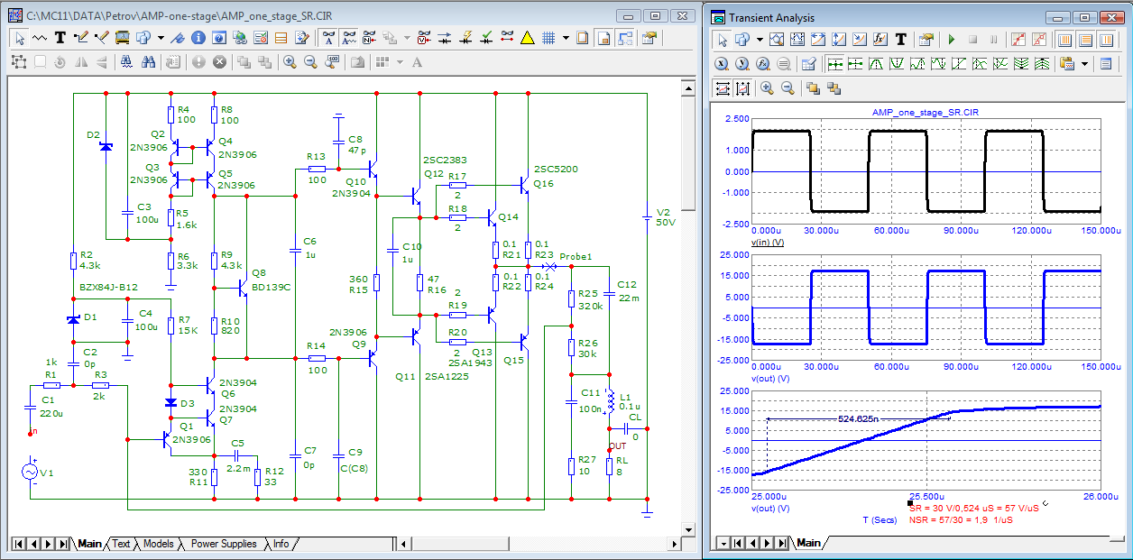

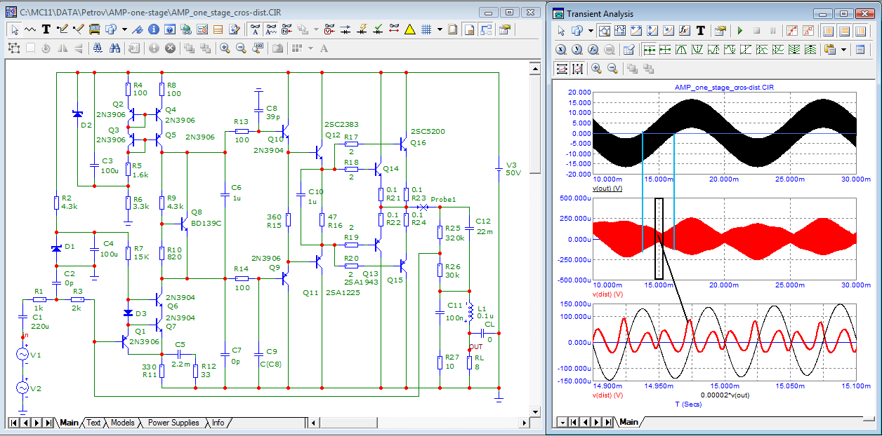

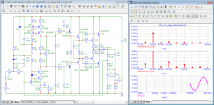

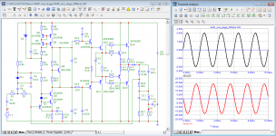

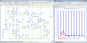

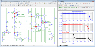

The vast majority of amplifiers (including those described in the books of Douglas Self and Bob Cordell) are made according to the Lin structure (Fig. 01). However, the disadvantage of such amplifiers is a large signal propagation delay time (from 200 ns to 1.5 μs), which leads to poor microdynamics, lifeless sound without emotions.

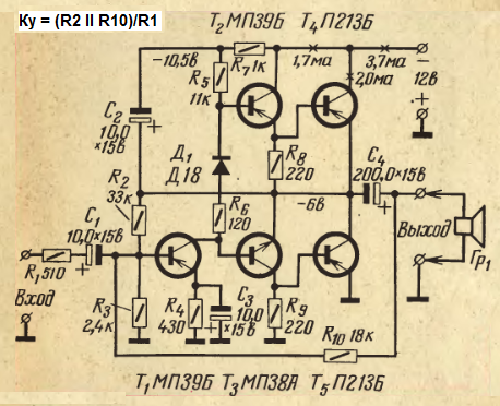

At the beginning of the development of circuitry, simple single-stage amplifiers were popular, the prototype is fig. 02. It should be noted that they sounded quite good. The disadvantage of the vast majority of class AB amplifiers is large crossover distortion. The main reason is the same - poor speed parameters.

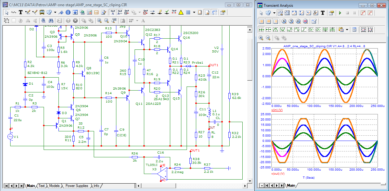

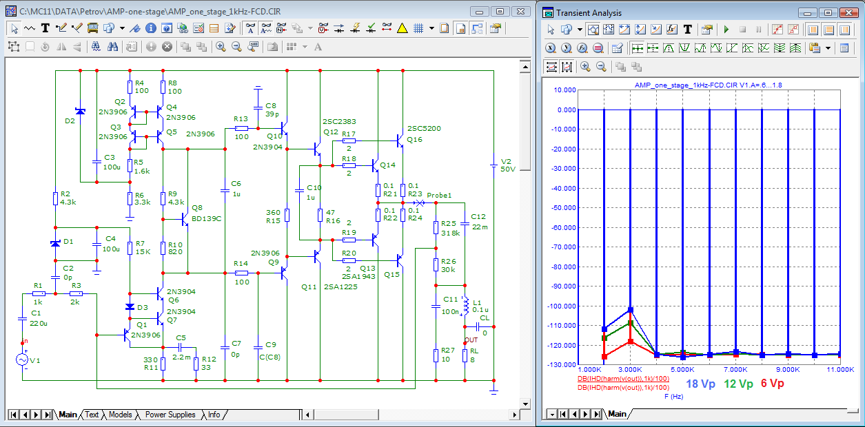

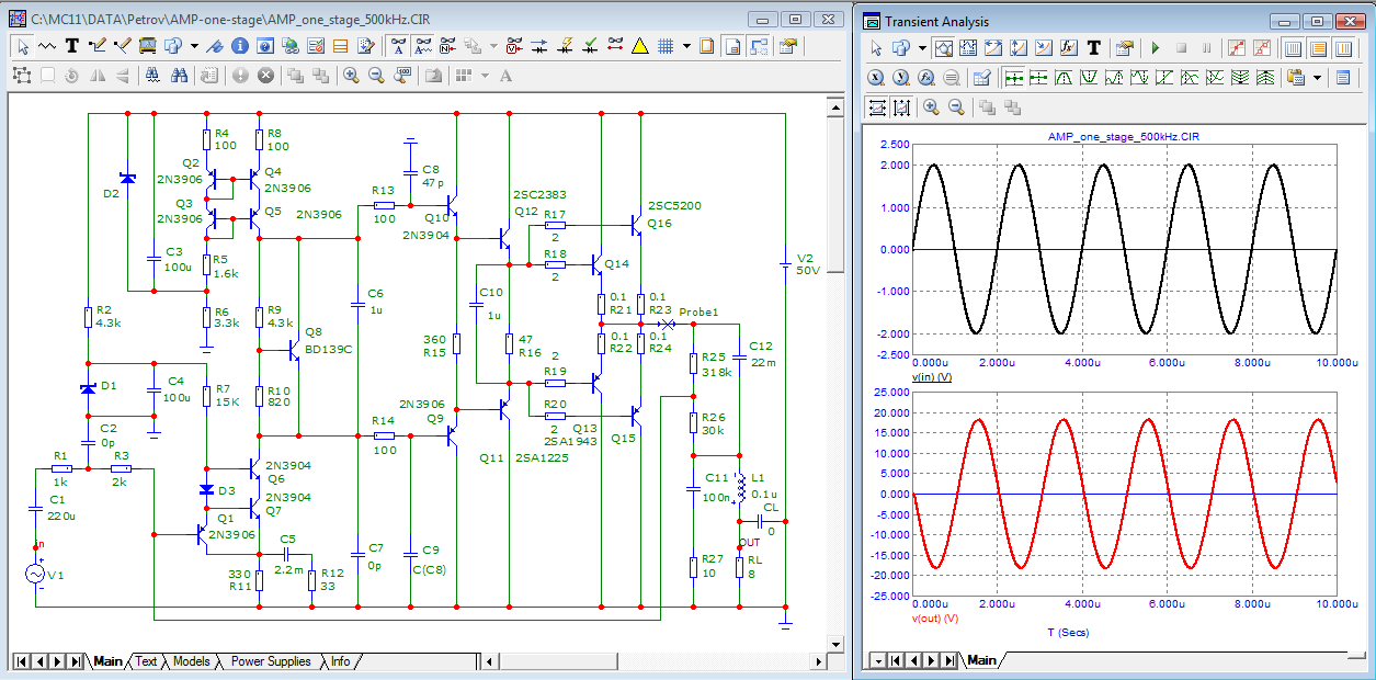

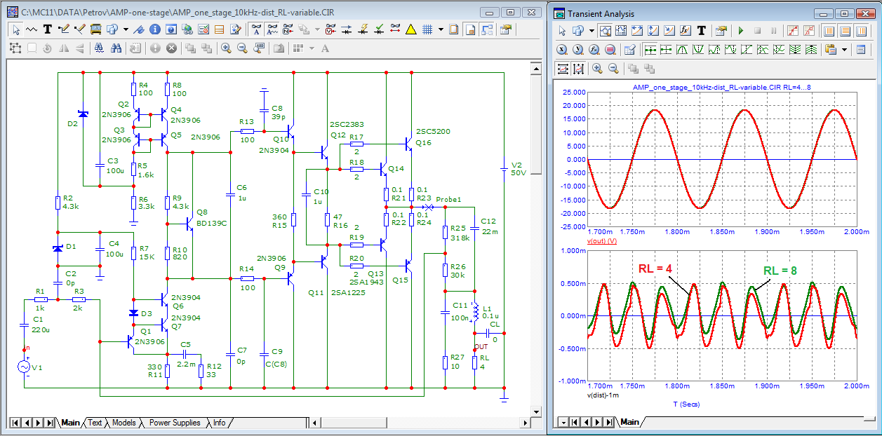

Let's build a model of a single-stage amplifier, taking into account the recommendations of Mati Otala, John Curl, Nelson Pass and other progressive authors, and measure some parameters. The voltage amplifier is made cascode, the load is a cascode current generator. The output stage is made in the form of a typical Darlington triple with paired output transistors and has no special features. The quiescent current per output transistor is 100 + -10 mA.
The amplifier is covered by two NFB circuits (R25 - is responsible for the midpoint at the output, R26 - NFB after the output capacitor - reduces the distortion it introduces). When working on a reactive load, an output inductance of 0.1 μH or more is sufficient. Suffice it to say that the linear inductance of a conductor with a diameter of 1 mm is 1.5 μH. Thus even 10 cm will have an inductance of 0.15 uH. Therefore, in a real amplifier, the inductance L1 may be absent.

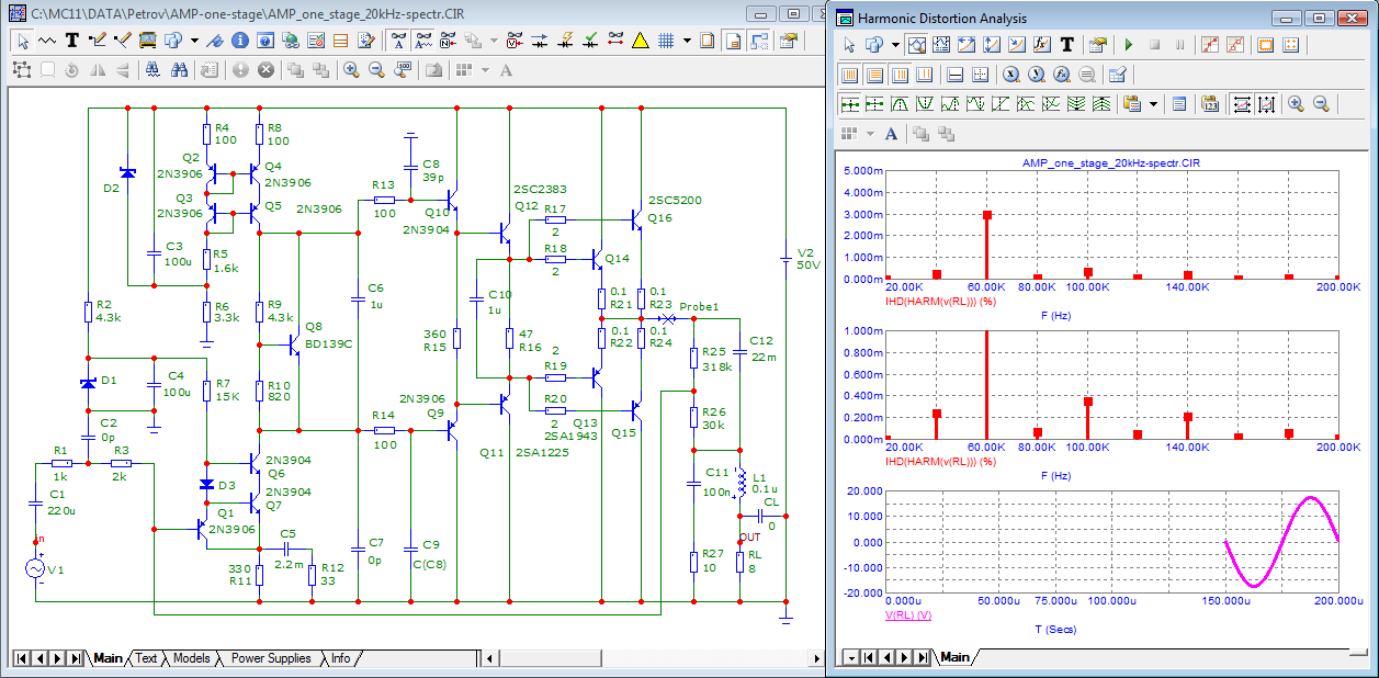

The simulation result showed that the мodel has good speed parameters (the signal propagation delay time is about 50 ns, the normalized output voltage slew rate is 1.9 1/µs). Due to this, high-speed and crossover distortions are completely absent, intermodulation products in the audio band are below -120 dB. The distortion spectrum is decreasing, the distortion products above the third harmonic are negligible.

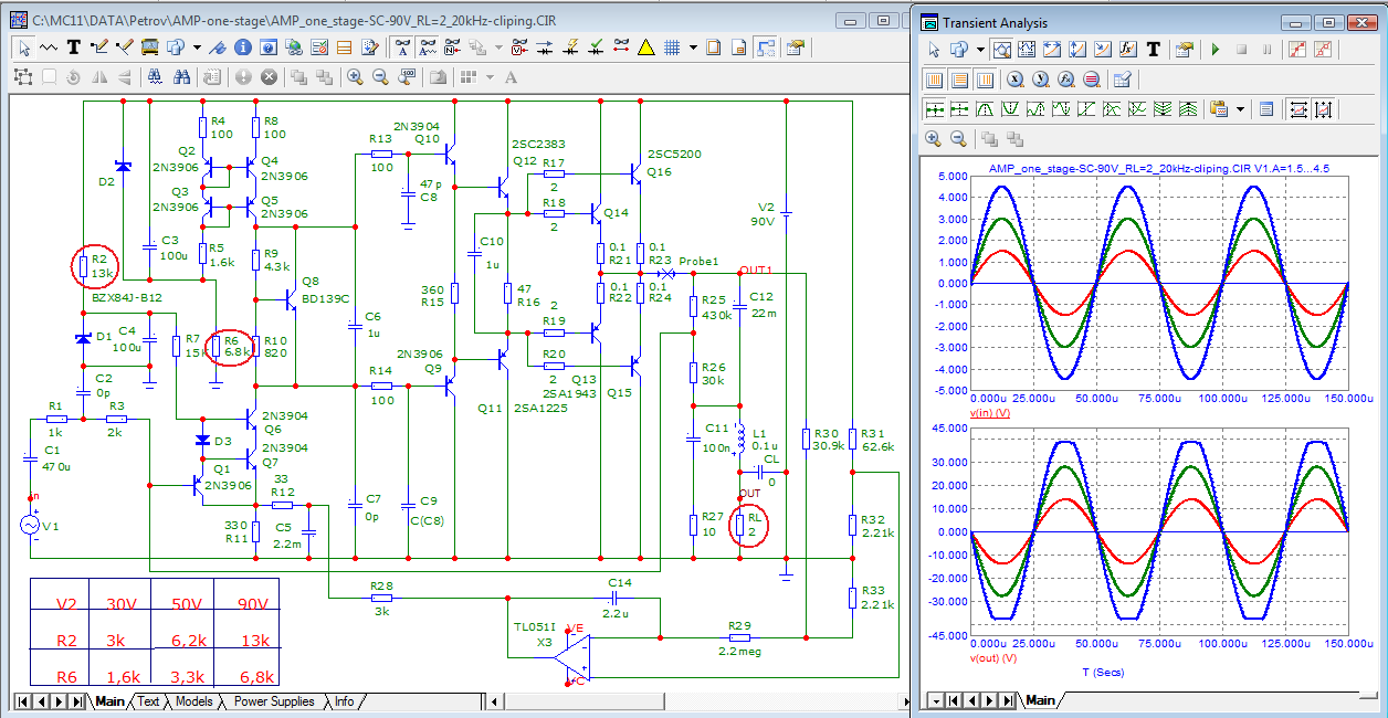

The power supply of the amplifier can be in the range from 30 to 80 volts.

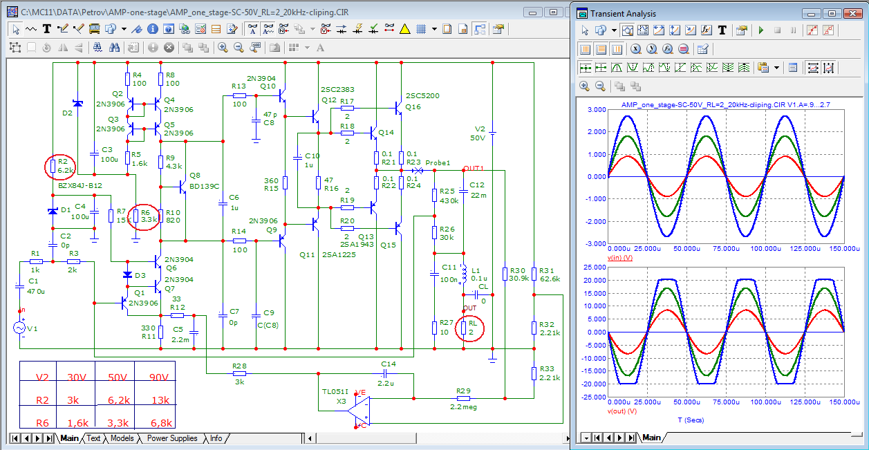

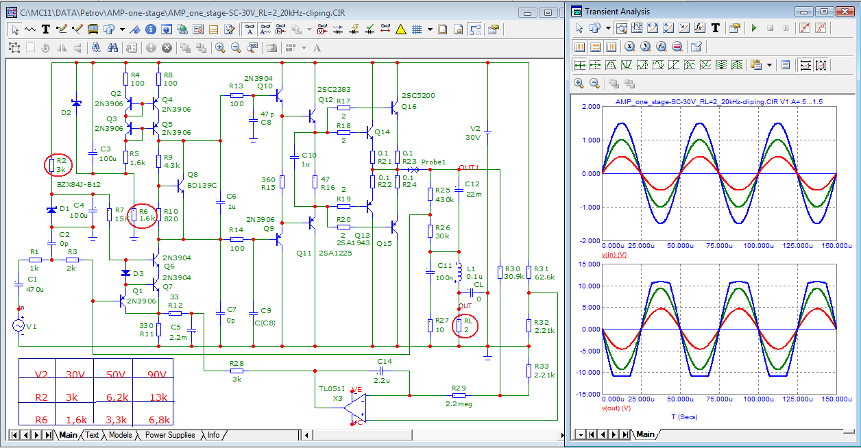

servo control system ensures operability at supply voltage within 30...90 volts
The input capacitor operates at a polarization voltage of 2.2 volts. Since the amplifier is inverting, the AC voltage across it is practically zero (virtual ground input).
If you use a potentiometer with a linear characteristic (X4 = 20 kOhm) as a volume control, then the control becomes logarithmic. With a decrease in volume, the depth of negative feedback increases and distortion decreases even more, as can be seen at the first watt.
It is arguable that a triple darlington is three stages, each
amplifying the current and driving the next stage. If the
technical community wants to call a darlington a single-stage,
then I have lots more single-stage amplifiers than I thought.
Personally, I count the number of stages in an amplifier by the number of voltage amplification stages. In some amplifiers, the output stages are in the form of a Darlington triple with 10 paired output transistors. For me, this does not mean that I have to add 12 more stages to the number of voltage amplification stages. For example, this amplifier, according to my concepts, is two-stage.

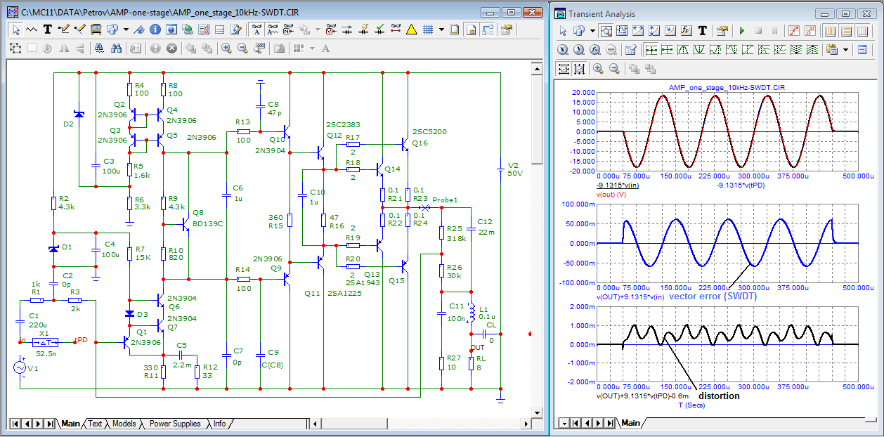

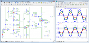

When changing the supply voltage, you should pay attention to 2 resistors, they are circled in red. The clipping mode is given at a load of 2 ohms.

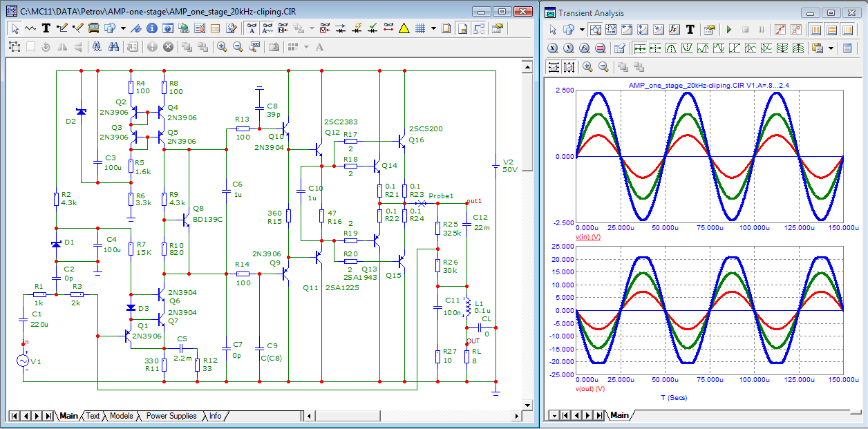

Tests show the efficiency of the servo control system, the clipping voltage is symmetrical.
