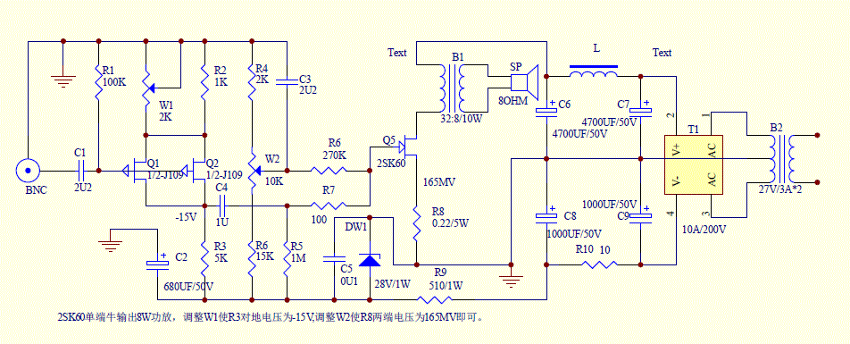

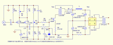

Single stage amplifier
In DC amplifiers, there are no problems with amplifying signals in the low-frequency region.
Let's check the operation of the servo control system in this area. To do this, we use signals with a frequency of 20 Hz (burst and rectangular).
According to my concepts, the faster the constant component on the load is restored at the end of the signal and the smaller the slopes of the rectangular signal shelves, the better.
As the test showed, the initially selected values of the capacitor and resistor in the integrator are not optimal.
For comparison, the same test of an amplifier made according to Lin's typical circuit.

For those who do not want to mess with JFET transistors, I can offer this buffer option.
If the volume control is turned on in front of the buffer, then even with a potentiometer with a resistance of 120 kOhm, the resistance of the signal source will not exceed 30 kOhm.
