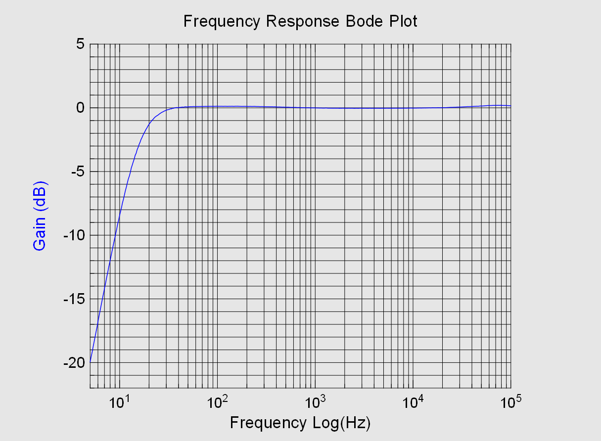

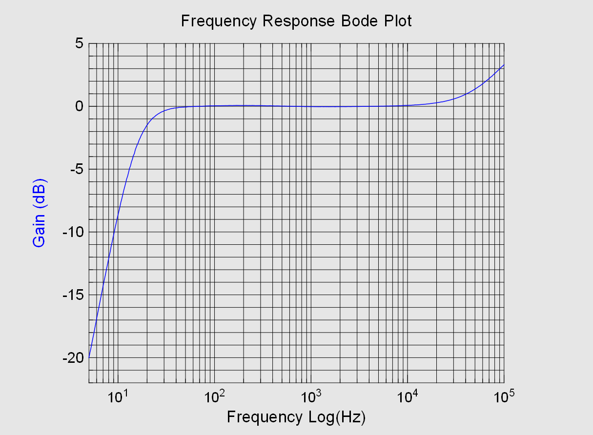

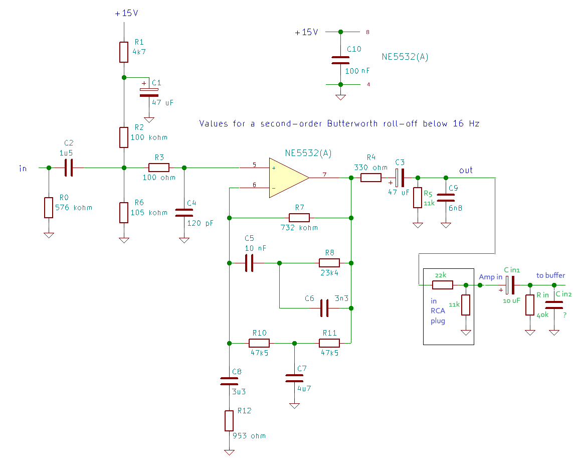

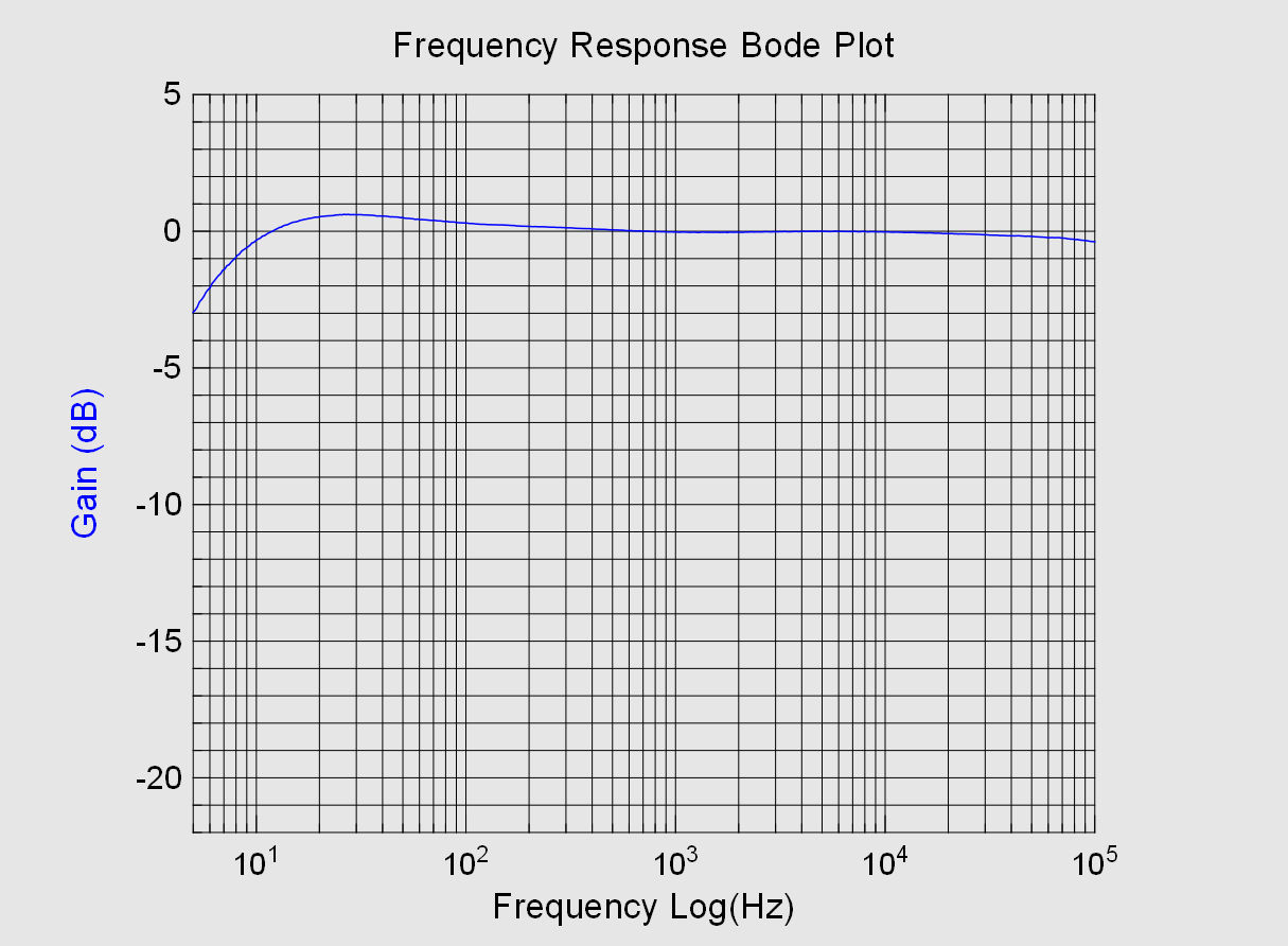

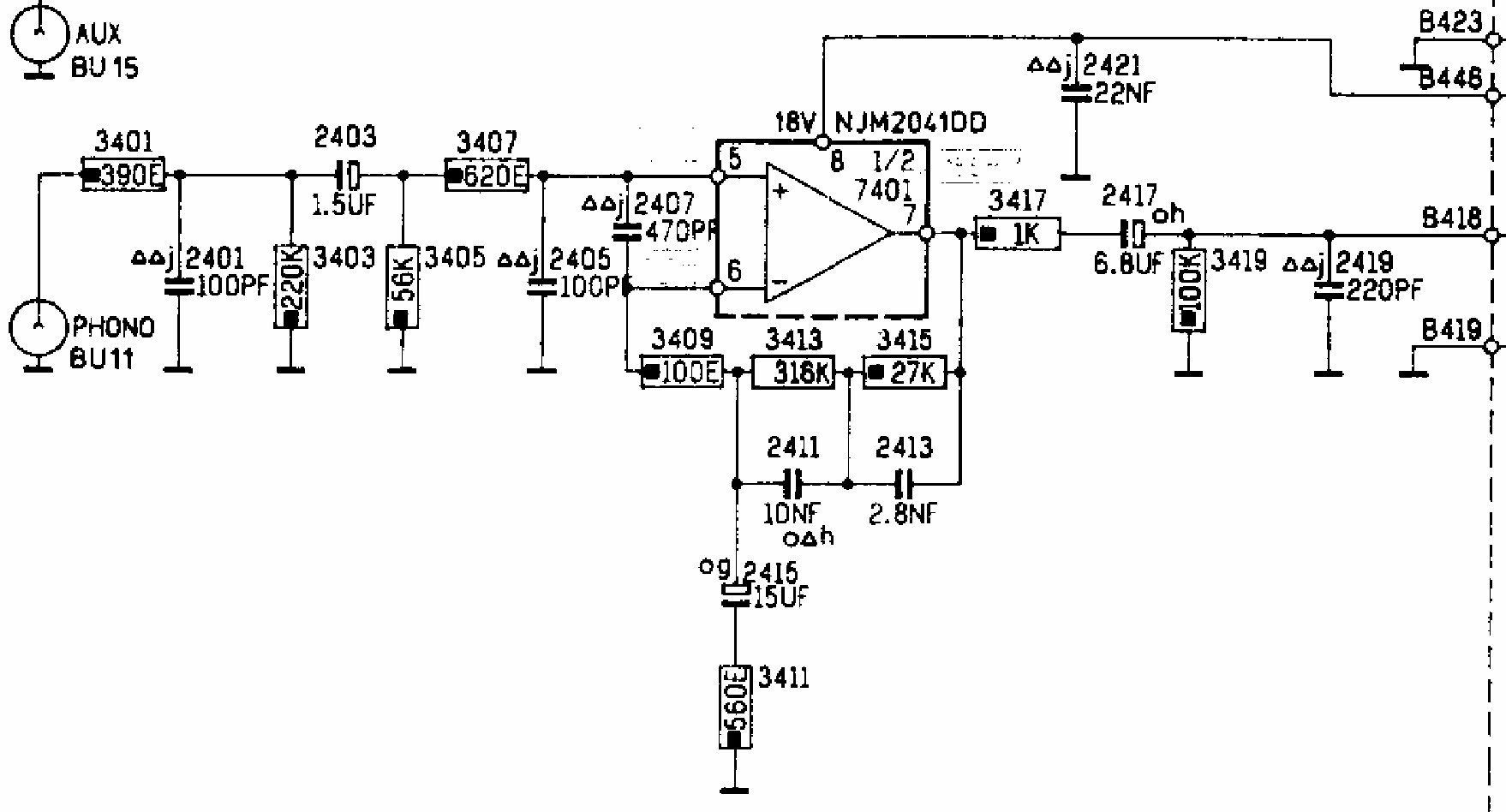

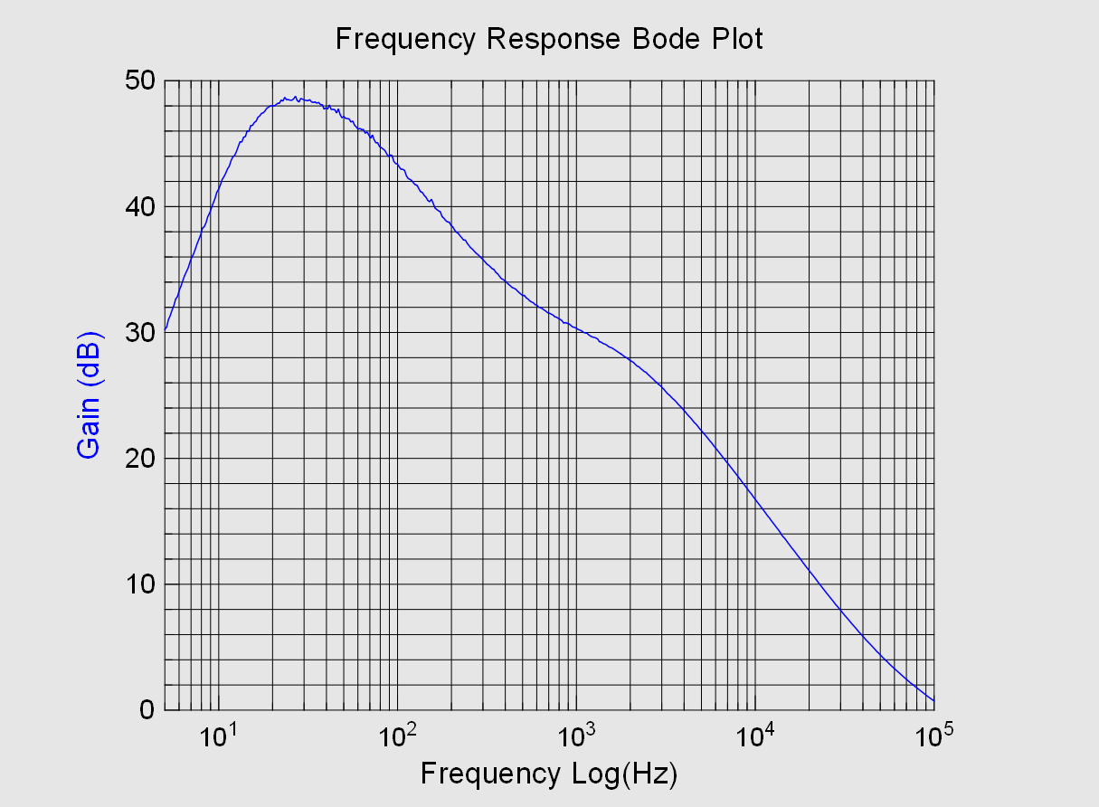

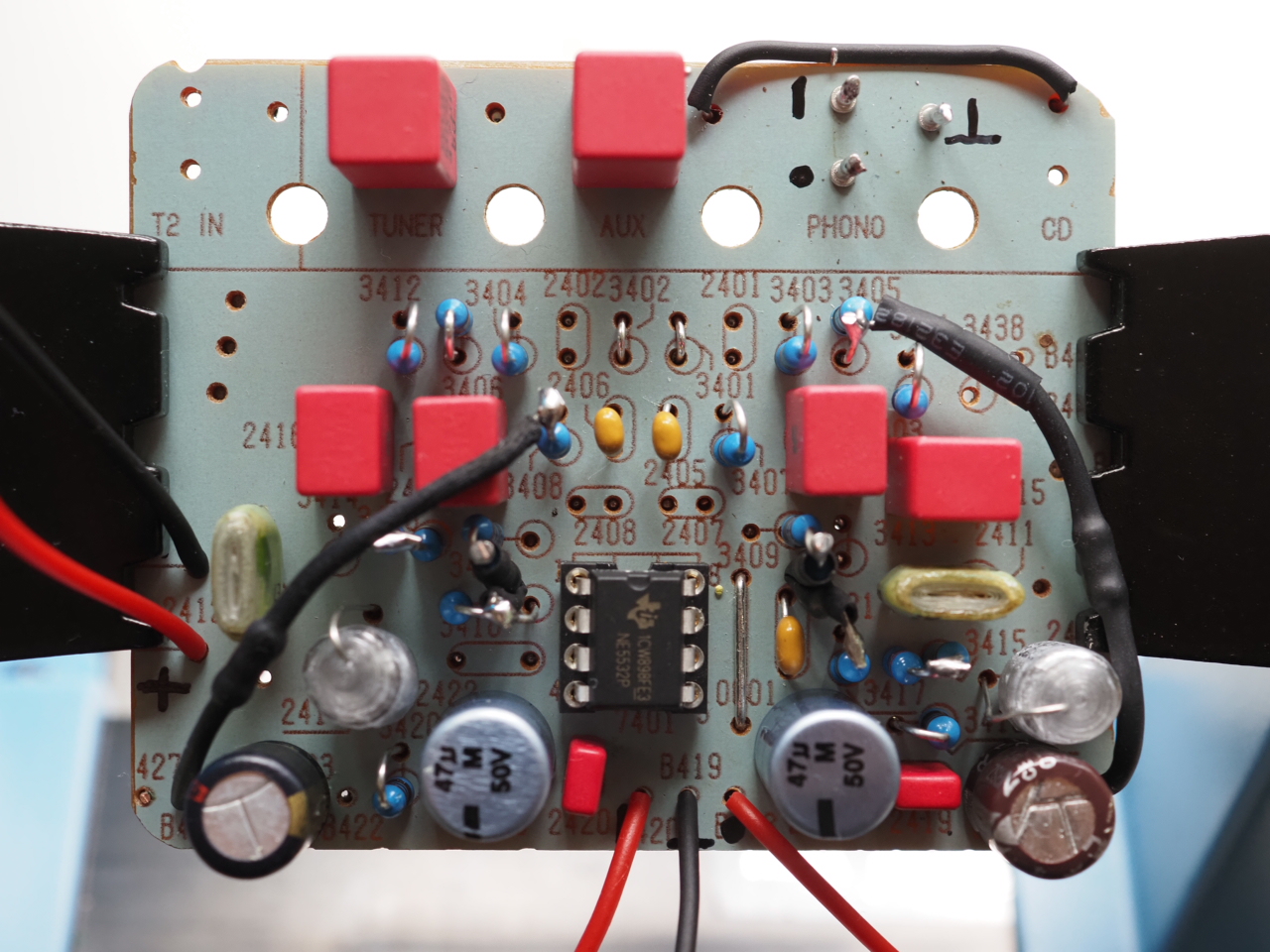

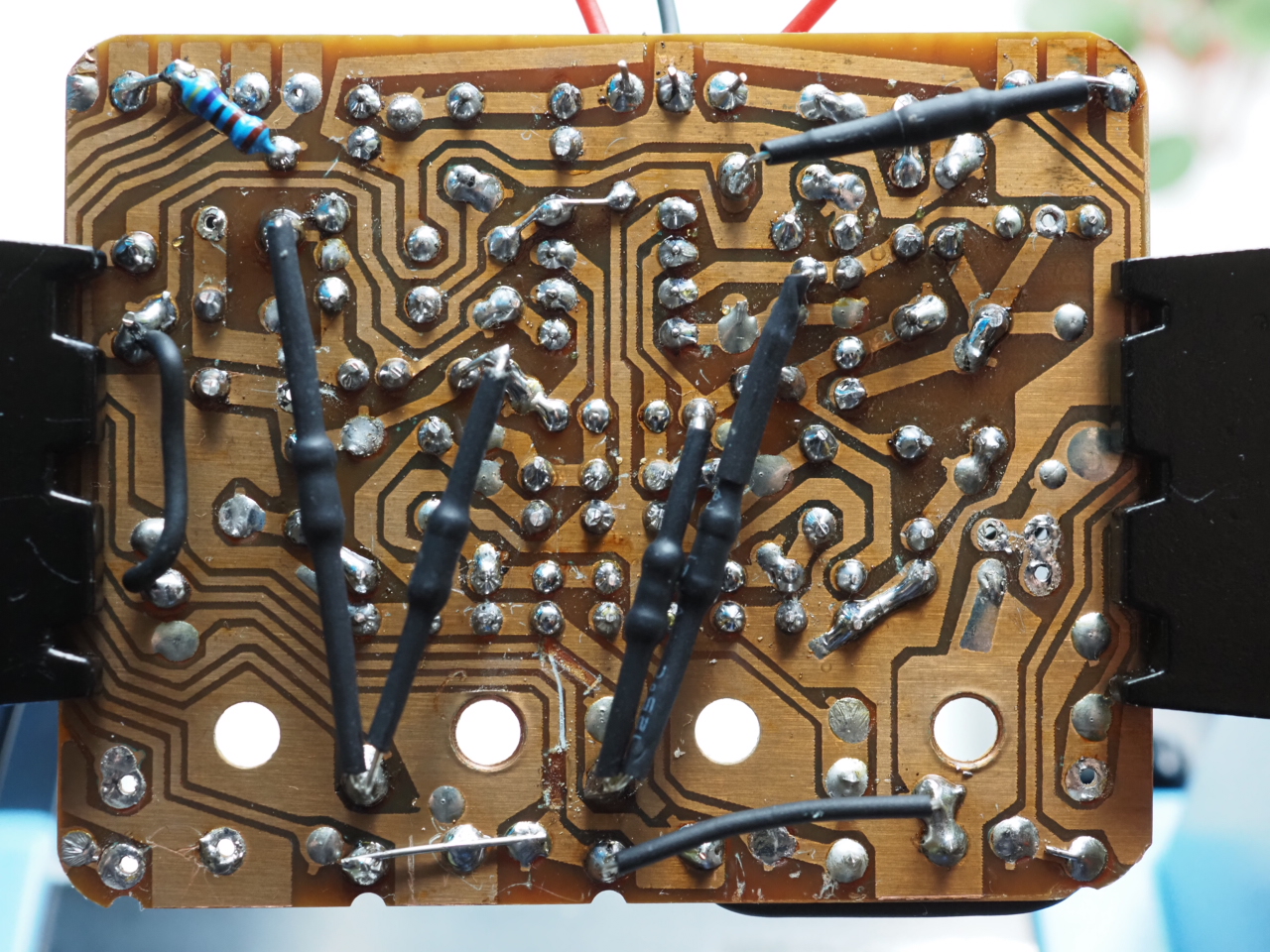

I have built the design in post #158. Because of size constraints, I have recycled the PCB from a commercial Philips amplifier I had kept. The schematic resembled the design in post #158 well enough for that. I just had to piggy-back R1, R2, R10 & R11. Below is the schematic as I have implemented it, the original Philips design and a few photo's of my project. The issue is that measurements using my inverse RIAA circuit shows that the frequency response starts to rise after 10 kHz (on both channels, L + R). To rule out that this wasn't a measurement error, I've measured an old Pioneer A-110 amplifier that I have lying around. This does not show the rise in amplitude, so my thoughts are it must either have something to do with the design or the PCB layout. Since the issue is on both L & R channels, I am not thinking that it is a wiring issue (for now).
All Inverse RIAA plots have been normalized to 0 dB at 1 kHz.
The direct measurement (input to output) have not. There it can be seen that the amplification is 30 dB @ 1 kHz, which was the design criterion.
Any thoughts on this issue are welcomed.
Schematic as built

Inverse RIAA plot normalized
Bode plot showing gain @ 1 kHz

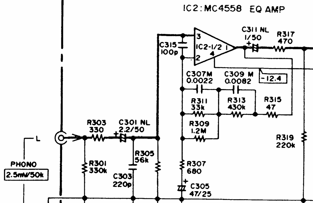

Pioneer A-110 RIAA Amp circuit
Pioneer A-110 Inverse RIAA plot normalized
R4 is too small, 120 ohm instead of 300 ohm...332 ohm.
The problem with single-loop active RIAA correction amplifiers with a low gain is that because the gain drops to 1 instead of 0, you get some extra treble (the ultrasonic zero, in transfer function jargon). You can correct for that with a first-order low-pass after the amplifier. The +3 dB point lies at approximately 2122 Hz times the gain at 1 kHz, about 67 kHz in your case. It's higher in your measurement because with the too low R4, you still partly correct for it.

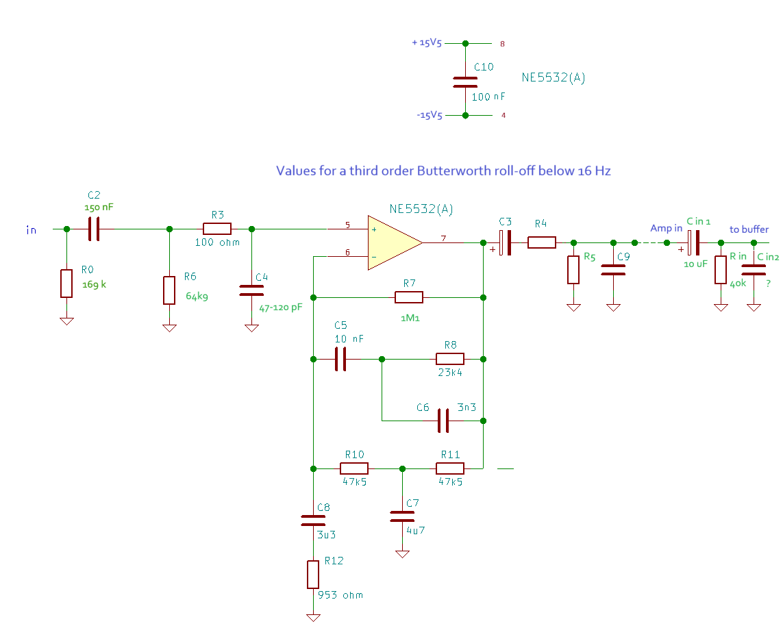

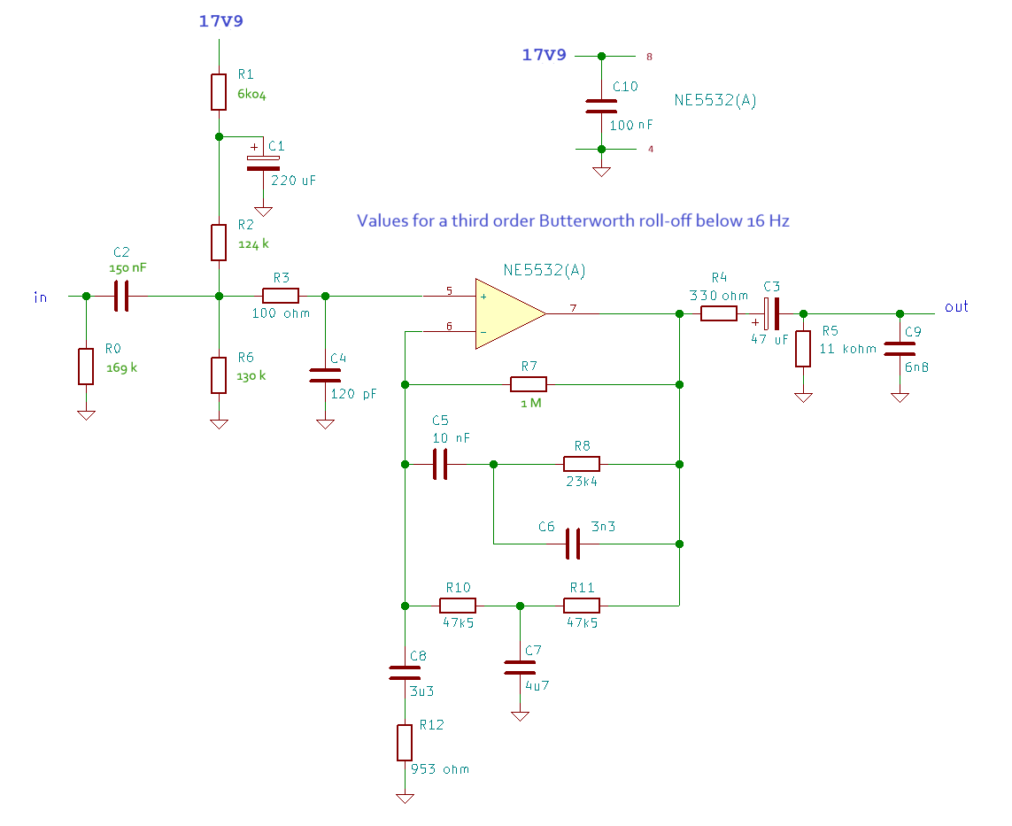

If I want to change my amp's roll-off to 3rd order, are the below values for R0, R1, R2, R6, R7 and C2 correct?
I followed the formulae in your document.
Rcart = 1k3 (my carts spec)
Fsub = 16 Hz, C5 = 10 nF -> L = 1/(4pi^2 * Fsub^2 * C5) = 9895,2 H
R7 = SQR(L/C5) = 994 k -> 1 Mohm
C2 = (1/2*pi*Fsub) / (R6+Rcart//R0) -> R6 = (1/2*pi*Fsub)/C2 - Rcart//R0
Since R0 >> Rcart -> Rcart//R0 = Rcart
Take C2 = 150 nF -> R6 = (1/2*pi*16)/150nF - 1k3 = 65 kohm
R6 consists of R6//(R1+R2) ->
R6 = 130 kohm
R2 = 124 kohm
R1 = 6k04 ohm
In your last equation, R6//(R1+R2) should be R6//R2, as R1 is practically shorted by C1 for frequencies of the order of 16 Hz. The equations are only approximate, so I will run the values through LINDA.
The PSRR at 100 Hz would become somewhat worse with the smaller C2, but you made the time constant R1 C1 larger, which improves it again.

I've run your values through LINDA. My simplified equations always underestimate the required R7, as I neglect a bunch of damping terms. R7 = 1.1 Mohm works better than 1 Mohm.
Besides, if you want to be perfectionistic about it, C3 can best be reduced to 10 uF and R5 changed to whatever value results in 7334.6 ohm when you connect the amplifier input impedance in parallel with it. The time constant of the output AC coupling then becomes 76.646 ms, which is what you need to compensate for a zero that should be in the origin but isn't. (In the second-order version, that's done with the input AC coupling.)

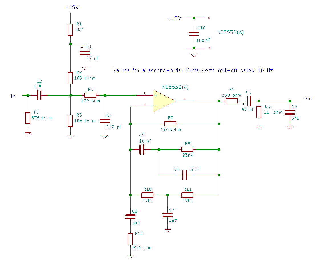

At the moment the RIAA amp (2nd order HPF) is installed in the turntable. As I've mentioned before, I have attenuated the output by -11 dB in the RCA plug at the power amp's input. See the first schematic of what the complete set-up looks like.
Now I am looking at integrating the RIAA amp (as 3rd order HPF) into my integrated amp. I would like to use R4/R5 to drop the sensitivity by 11 dB. See the second schematic of what this would look like. The order of C3, R4, R5 and C9 is as they are on the PCB of my integrated amp.
I could use R4 = 22 k and R5 = 11 k again to drop the sensitivity, but then I run into issues with correcting for the zero at 2122 Hz * A (@1 kHz) = 2122 Hz * 33.1 = 70.2 kHz. C9 would become 100 pF (1/(2*pi*f*R4)) and that is hard to manage since I don't know C in2 of my amp.
I could lower the combination of R4/R5. If I would drop the total load seen by the Opamp to around 6 kOhm (10 times the minimum load of 600 Ohm),
then R4 = 4k2 and R5 = 1k8. Then C9 would become 540 pF. If I allow around 50-100 pF for C in2, then I could use 470 pF for C6 and expect some accuracy for correcting the zero at 70.2 kHz.
My question is what I can (or should) do with C3. It has to do with correcting the HPF around 1 Hz and I have read it is not critical. Since I have C in1 in my amp, can I not just remove it? What is wise?
Current situation. RIAA amp in turntable. Attenuation in RCA plug
Proposed new situation. RIAA amp integrated in amp.
