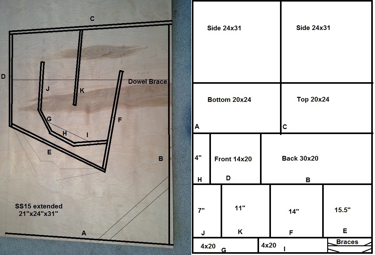

Ok, so my friend DJIM gently got me to act on this.... I haven't touched the ss15 design in months -- it just works so well.
The only downside for me, is that it is not a 'flat to 40' box. And I'm big on flat to 40.
So, a bit of 'S2 cone correction' instead of a compression plate.
1" taller and 1" narrower...
and the SS15 can now hit with authority an honest to goodness 40hz.
This is still on paper and hornresp only, and it'll be a week or so before I can build/test... But I do have assembled 'original' SS15 cabinets, and I can do an A-->B comparison.
It "should" eliminate the one glaring weakness I see in the ss15. And it still does it from a single sheet, but this time you really do have nothing but sawdust left over... You even have to use the driver disk cut out from the baffle board as bracing.
Hey Jim, I'm having some trouble reading your measurements describing what distances from the edges the boards are to be placed. I've played around with a sketchup model, trying to get the most linear possible expansion, but I have to say my results look quite different from yours.
DISCLAIMER FOR ANYONE BROWSING THIS THREAD: THIS IS NOT THE OFFICIAL JBELL LAYOUT
As you can see, my path divider coming from the top of the horn is perpendicular to the top, and not angled like yours. However observing the cross sections, this seems to yield a good expansion on paper. It would be great if you could write your measurements more legibly for me

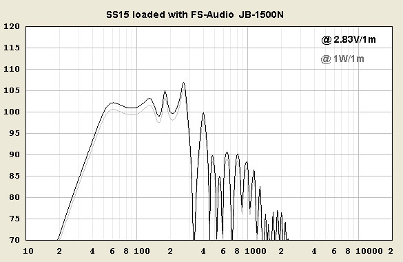

i didnt read through all 32 pages, but im just about to go ahead and purchase a pair of JBL drivers for my SS15 cabs and just wanted to confirm what im seeing here..
before i go on, i must say i LOVE my SS15 cabs. i was using a pair of china brand 200w drivers and they sounded absolutely incredible and now theyre dead so i want more! better!
i just cant justify spending $130 freight on a $166 item. but, have found a JBL driver that i can get for $159 freight free in my country. its a JB1500N rated at 600wrms so will be fine for me when i rearrange my amp wiring.
here is my hornresp response sim. black = Kappa15lf pro grey= JB1500N
can someone please confirm what my brain does not believe my eyes are seeing.

Hi Klampykixx,can someone please confirm what my brain does not believe my eyes are seeing.
I am not qualified to confirming anything about the state of your brain 🙂 but it looks like you made a small error in your input parameter page. Anyway, it looks like a good pick for the SS15 on paper...

Hi klampykixx,
Your sim of post#1568 is not a sim of a standard SS15. That is why I showed the sim of a SS15 loaded with a JB-1500N in post#1571.
Tapped horns have excursions dips in the frequency range that you can describe as points where there cone excursion is minimum. At these points the driver is suffering from thermal power compression. It means that the input power is not transferred into movement but into heat. These excursion dips can be found in the “Diaphragm Displacement” page in the window menu of HornResp. If you compare the excursion with the impedance you can see at the excursion minimums there are also impedance minimums (see red arrows in the picture). That means the most power runs trough the Voice coil at frequencies of the excursion minimums.
