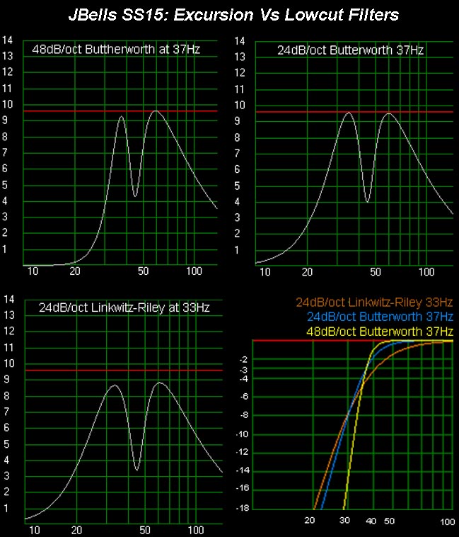

Looks like you're using WinISD. I'd like to experiment with modeling filters in TH's. Are you modeling your examples with vented enclosures? (I didn't see TH as an option)
Hi Crescendo,
Yes, I use WinISD for quick excursion analyses for setting out filters (all tools for that are provided in WinISD). If you want more accuracy try 6th order bandpass and try to align the impedance and excursion to that of the TH in HornResp. But basreflex is most time close enough for TH’s with an 1/4WL above 30Hz.

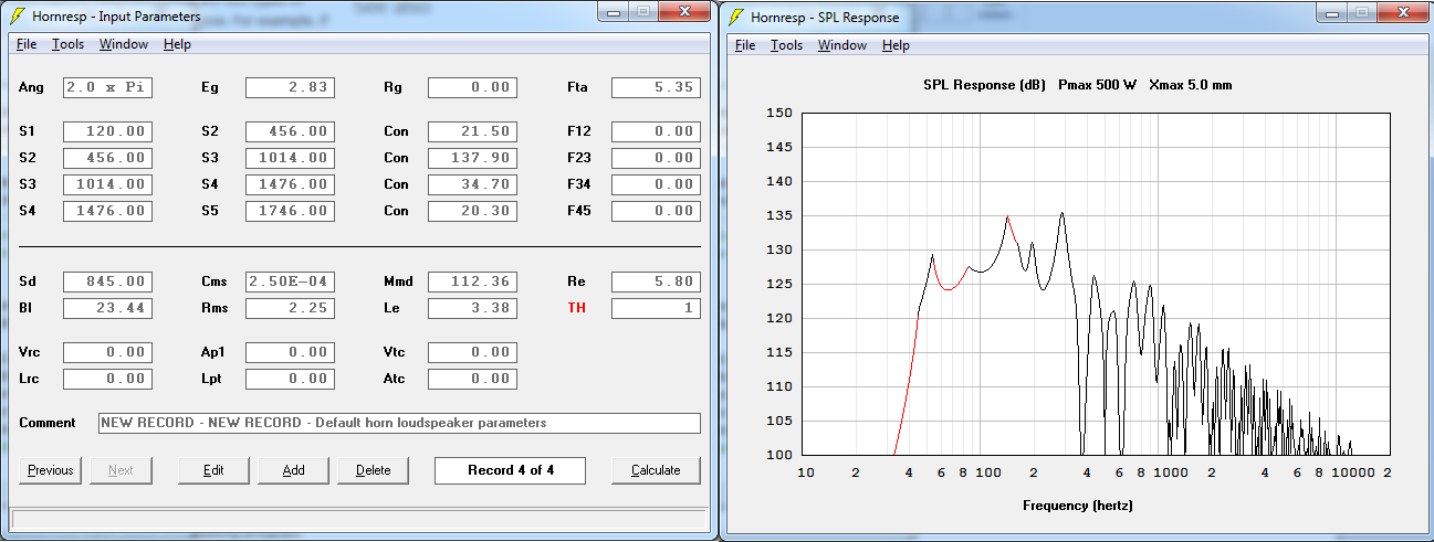

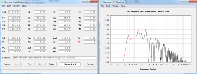

Here's my attempt at substituting the Dayton driver; this is my first HornResp simulation, so please feel free to check my work. Given the $85 pricetag, it seems to offer good value for money.

As far as I can tell, 130 dB is achieved using 4 of these cabinets. The line for the single cabinet is fainter and may be harder to see on some old lcd screens ( I speak from experience).
Regards, Ben
I have a fairly recent LCD monitor - maybe I did not calibrate it correctly? Time to go find the gamma controls....
In any case, I'm not too worried about max SPL; to be honest, I doubt I'll even need the second. 120dB down to 50hz for about $110 including plywood is pretty bonkers.
