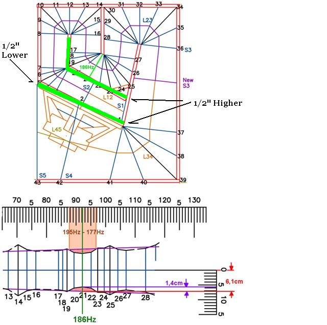

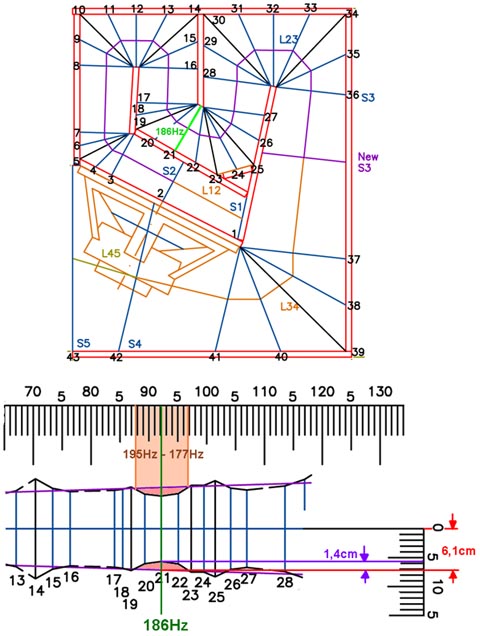

so I make the front panel 1/2" longer and the vertical panel attached to point one, 1/2" shorter to raise the rear of the driver, and things are better?
It would make point 21 bigger, but also point 10-14...

Jbell, can you make quick drawing of your changes over the cab as it is? You don’t need to worry to much about expanding corner 10 and 14 cause you can always use corner correction if needed.djim:

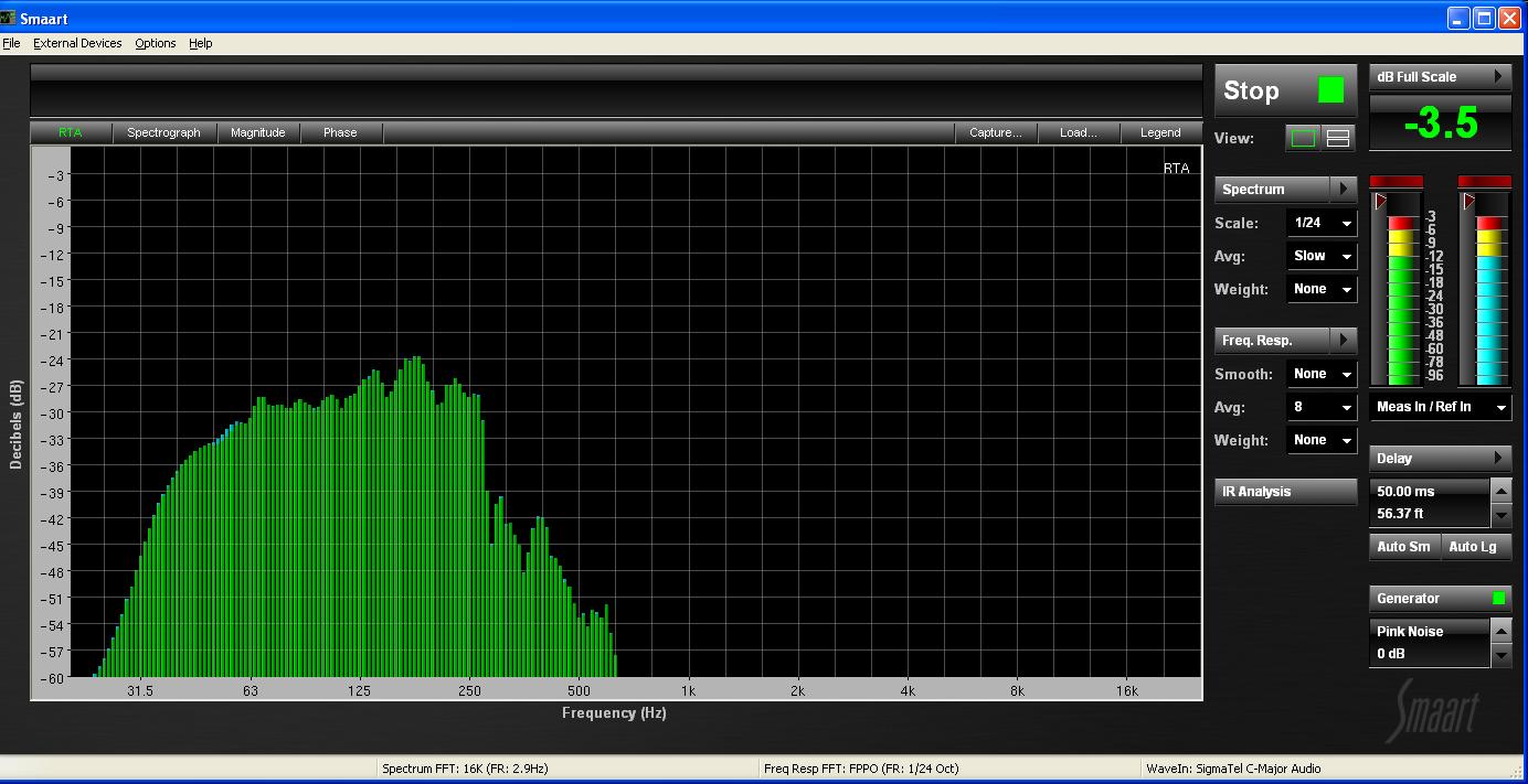

Btw, do you have measurements above 120Hz?

Let’s check how accurate Oliver is:
Total path length = 2,4118 meter
1/3 wavelenght = 47Hz (below this point you should see a drop in SPL)
2/3 wavelenght = 94Hz (above this point the design/driver reaches is max efficiency)
Measuring results from JBell & Runrod1948:
40hz 98.5.............40hz 101db
45hz 100.5...........45hz 104db
50hz 102..............50hz 108db
55hz 103.5...........55hz 109db
60hz 105..............60hz 111db
65hz 105..............65hz 111db
70hz 105..............70hz 112db
75hz 104.5...........75hz 112db
80hz 104.2...........80hz 110db
85hz 104..............85hz 112db
90hz 104..............90hz 113db
95hz 104..............95hz 112db
100hz 104.5..........100hz 113db
105hz 105............105hz 112db
110hz 105............110hz 112db
115hz 105.5..........115hz 113db
120hz 106.5..........120hz 113db
Or should I say how accurate the builders are?
To me it proves the SS15 is one of the best balanced cabs around and it will be very difficult to get a few dB's extra without losing its low-end. But I still think you can optimise its design, but how far that will result in real dB's???

I'm not sure if I kept measurements above 120, I know I did up through 200hz and it was basically flat, but that's from (faulty) memory -- so take that with a grain of salt... It also snowed last night / this morning, so I'm not doing any outdoor tests just yet....
Here's what I was thinking of. Keep in mind that the 8" board with the angle on it, is the last board cut against the baffle -- and the baffle has zero give in it's dimension, so it is never quite 8", usually it's about 7.75 or so at it's longest.
When I assemble these I always use the 'swinging gate' method. I find point 32-36, and then make the baffle/vertical board fit so that it lines up with that point and the front panel. Everything else is a piece of cake once that is done.

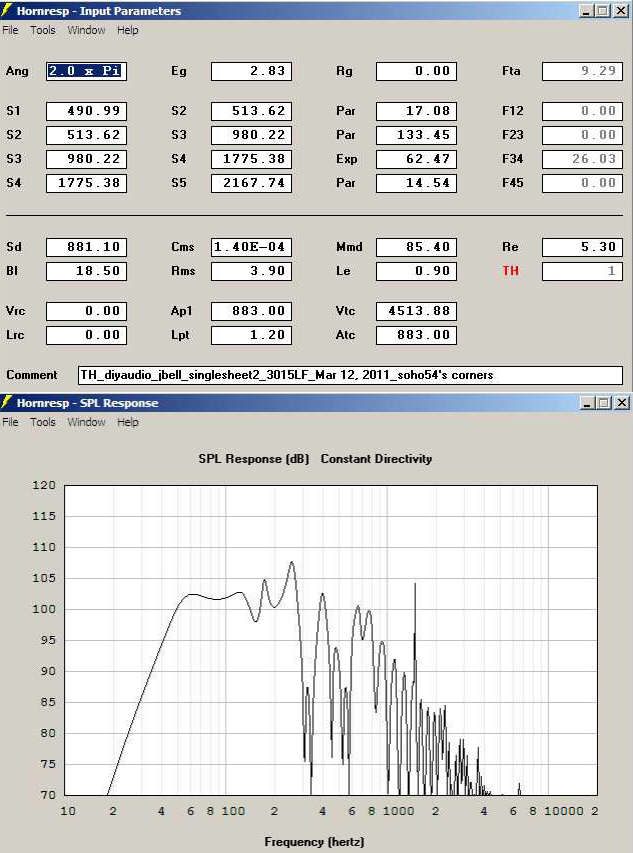

JBell, when I compare it with Oliver’s’ latest HornResp your point 21 is getting even more narrow. But when I look to Oliver’s prediction you see a peak around this freq. So they can equalize each other and maybe that’s why you measured a flat response around this area (in my earlier statement I thought there was a dip in HornResp like in most TH's but that isn’t the case, sorry for that).
My worry is about the dip in prediction of HornResp, so that's why I asked for >120Hz responses.
The ½ inch (12,7mm) rise of the driver-panel brings the narrowing between points 40 and 41 back to 1/8 of the horn path. This means the narrowing now falls with “acceptable tolerances”
By rotating the driver panel just by half that inch and the slightly rotation of the panel above should raise the S2. That would explain why your ‘dip’ around the 90Hz is just 1dB. Did Runrod1948 use your ‘changes’ also?
It looks like you already did changes for the better. But I think we should seriously look at Oliver's suggestion earlier on this threat.
