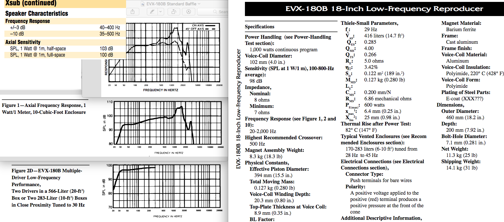

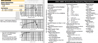

Your SS15 response curve in post #2227 indicates 105dB 1w1m sensitivity at 100 Hz, dropping to about 98 dB at 40Hz.
The Xsub uses a pair of EVX180B. EV’s EVX180B spec sheet indicates 100-800Hz average sensitivity at 98dB, this includes it’s +5dB peak between 500-800Hz. At 100Hz and below, sensitivity for a single EVX180B is below 95dB.
Considering the Xsub’s relatively small (for a dual 18”) net volume, and Fb around 40Hz, would be surprised if it’s sensitivity at any frequency below 100Hz exceeds 98dB, which would indicate your sensitivity measurements may be high, considering you wrote the Xsub has about the same sensitivity as your SS15.

weltersys: there's some issues with your assessment of the EV sub.
1. the sensitivity figure of 98 dB SPL 1w / 1m from 100 to 800 Hz provided in the EVX 180B datasheet you referenced is given without data on space or enclosure.
2. the closest enclosure to the Xsub in the EVX 180B datasheet (though somewhat larger net volume and lower tuning) is figure 2D, which we might assume (not specified) is the 1w / 1m / 2pi value.
The SPL values given in that chart are abysmally low and I know of no double 18 BR that would yield such a poor sensitivity - even a L'Acoustics KS28 with a similar tuning (31 Hz), but much smaller volume and inefficient drivers with large moving masses does on average 98 dB 1w / 1m / 2pi from 30 to 100 Hz.
So basically figure 2D cannot be the 1w / 1m / 2pi response for a double 18 with relatively efficient chassis in such a large enclosure.
3. you ignored the sensitivity value EV itself cited for the Xsub in the Xsub datasheet, which is 103 dB 1w / 1m / 2pi, down to a -3 dB point of 40 Hz - meaning 40 Hz = 100 dB. This is actually exactly what I measured. It however does stand in stark contrast to the values provided in the datasheet of the chassis, which surely does not help to clarify things.
The sensitivity value for the Xsub which was posted with the rest of the EVX 180B information is inconsistent, stating 103dB half space, 100dB full space. One of those specifications must be 3dB off, as we know there should be a 6dB difference.
Including response to 400 Hz on the Xsub spec would indicate that the +3dB response in that frequency range shown in the EVX180B specifications would make most of the output below 100 Hz 100dB half space, -3dB puts 40Hz at 97dB, consistent with the dual EVX180B box sensitivity of around 98dB in larger boxes.
Looking at other dual 18” specification sheets:
The EV TX2181 (Fb around 35Hz) 40Hz 96dB half space /2pi.
The EAW SB1001 (Fb around 35Hz) 40Hz 96dB 2pi.
The Fulcrum Acoustic Sub218L (Fb around 32Hz) 98dB 2/pi.
The JBL SRX728S (Fb around 35Hz) 96dB half space.
As Mark suggests, your measurements appear to be 3dB high, possibly due to measuring at only 1 meter, at 2 meters the test mic would be out of the “mouth bubble”.
