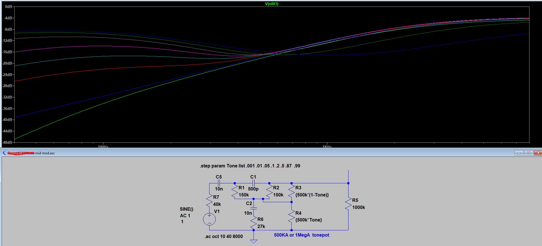

A simple variation of the single-knob tone found in the Princeton can be made so it is not interactive. If the tone stack sees a relatively constant impedance, which would be the top of a volume potentiometer instead of into the wiper of the volume potentiometer, it is not interactive, and works well.
The pic on the right is the modified version. Here the first little cap (220p - 470pF) also serves as coupling cap, so save a few pennies as well.

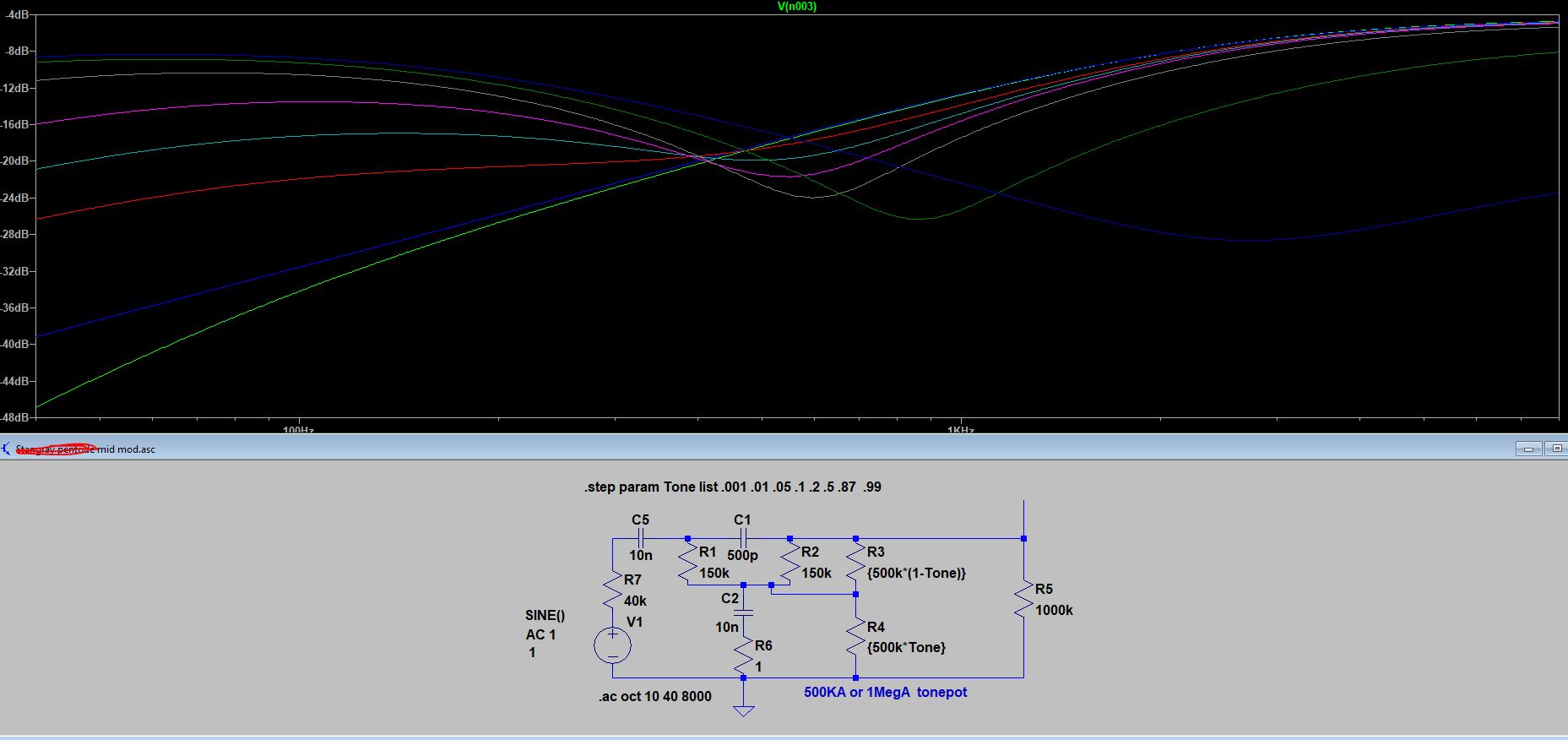

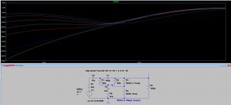

The modified control seems to be the treble half of a passive Baxandall. It looks like the modified (improved) treble control does come with a lot more insertion loss, though.
Looking at the 10:1 ratio of cap values on the two ends, I would expect this modified tone control will have its "flat" setting at roughly 20 dB insertion loss (pot one-tenth of the way up from ground, which also happens to be half-rotation in a log pot.)
-Gnobuddy
Yes it does drop 20dB when set 'flat' but in my version of single 6V6 wimpy amp the gain is more than enough. Besides most gitarst tend to have the tone about 3/4 up so the attenuation is not so bad. More than enough gain for complete crunch and easy to get feeding between gitar and speaker.
One might experiment a little and use other ratios of 1:10 cap values. For instance 220p and 1nF. A single knob tone control is mostly a rough trim anyways.
