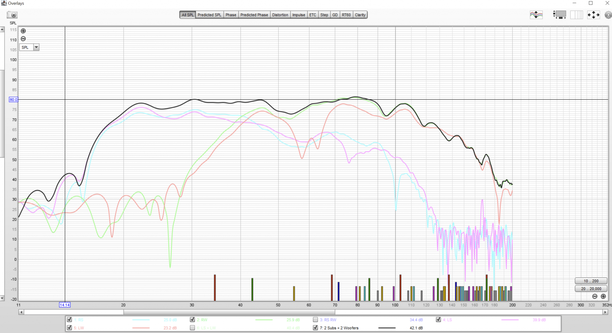

I understand the principle, but I'm pretty sure the rule of drivers placing drivers within 1/4 the wavelength of the crossover frequency is not the whole story.
Using your example of 50hz, that gives me 4 drivers that are within 1/4" wavelength of each other. They should all respond the same? But the graph I attached above demonstrates that when played individually, they do not measure the same. They are not hugely different at 50hz, but they are not the same.
Here is an interesting anecdote from Geddes. He was asked about getting "room gain" by placing a sub in a corner or by a wall, and his answer is that room gain does not exist. Instead, he said you excite different room modes by placing a sub against a wall or in a corner. And he said a sub in a corner excites more room modes, but total energy is the same.
We all know that room modes exist, and they are dependent on the location of the speaker and the listening position. Multiple subwoofer theory leverages this principle, using the interaction of the different room modes from different subwoofers to control each other. And I'm demonstrating that drivers that are close together can be used to the same effect. I don't know about you guys, but I find that fascinating. I mean, most people would say it can't work...but I sort of disagree.
If your data is good, it shows that there is a difference between driving one woofer, and driving several. But we don't know that the difference is caused by path length differences, do we?
I suspect the reason is something else - not path length differences, but something else.
A preamble: the reason why our loudspeakers are so terribly inefficient, is because it's hard to couple energy from a small vibrating diaphragm (speaker cone) into this very low-density medium.
When you put two identical woofers side by side, and drive each of them with the same power as before, it seems reasonable to expect a 3 dB increase in SPL. (Double the power in, double the acoustic power out.)
Some years ago, diyAudio member Printer2 did this measurement - and he found that he got 6 dB more SPL, not 3 dB! This was repeatable, not a fluke.
When the speaker cone diameter is much less than the wavelength of the emitted sound, coupling to the air is poor. The strength of the coupling is proportional to the ratio of wavelength/(speaker diameter). At any one frequency in this range, doubling the speaker cone area would double the efficiency of the coupling from mechanical motion to actual acoustic energy in the sound wave.
I think the reason Printer2 saw a 6 dB increase in SPL is because of this. Doubling the effective cone area (two woofers) also doubled the coupling efficiency to the air. So now you had twice as much electrical power (+3dB), but also twice the efficiency at putting that electrical power into the air (another +3dB). Net result: a +6dB gain.
I wonder if this effect is what you're seeing with those woofer measurements.
Room modes are an entire can of worms on their own. I don't know enough about that to say anything useful. 🙂
-Gnobuddy

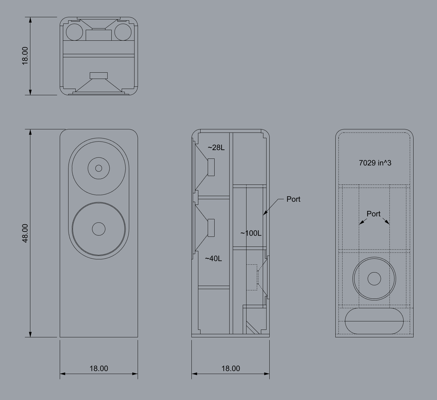

I built the new cabinet. The port design seems to work quite well! It has good output at 20hz, no issues with the 90 degree turn at the bottom of the ports. And my measurements say the distortion I was seeing at 20-30hz is practically gone! Before it was as much as 10%. It was 2.5% @80dB, and I bet most of that is the first cabinet I built with a slot port.
I'm happy with performance, but not sure about size. It's quite big. 18"x18"x48". It'll look smaller with 2" radius corners, but I don't know if that's enough. I am considering making it narrower, reducing the subwoofer portion and tuning a bit higher. I could reduce the subwoofer by 20% and still have an F3 of 22hz...
Below are a few pictures showing the internal construction. Keep in mind this is still a prototype. I'll do a proper build thread when I make a finished version.
