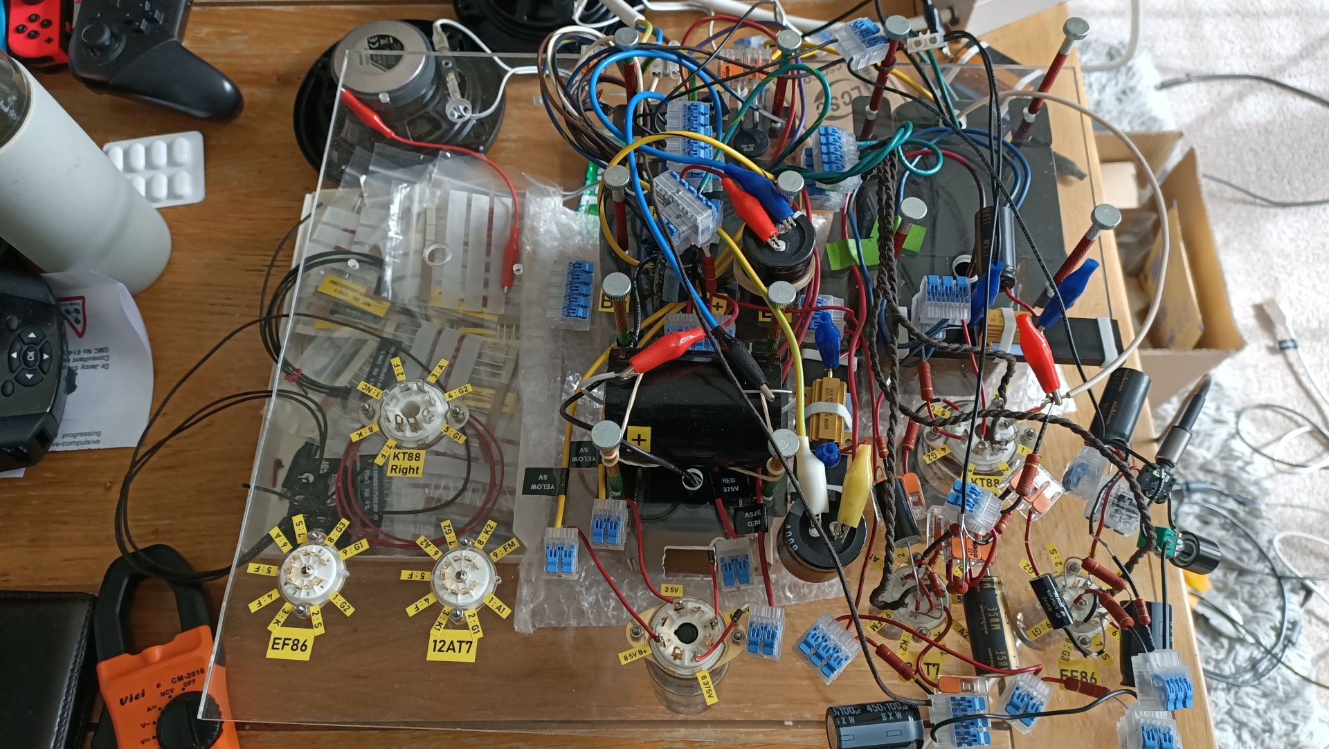

Update:
I built the prototype, left channel only and all the phase stuff is as expected.
Due to the phase being flipped I have to apply NFB to the 2nd stage.
I got 6W RMS before any NFB, I then added a 5.6K resistor from the 16ohm output to the R6 resistor after splitting it in 2.
It seems adding NFB to the 2nd stage allows me to get 9W RMS before distortion.
No feedback: 0.22VPP input = 19.6VPP out
Feedback: 0.3VPP input = 24.4VPP out

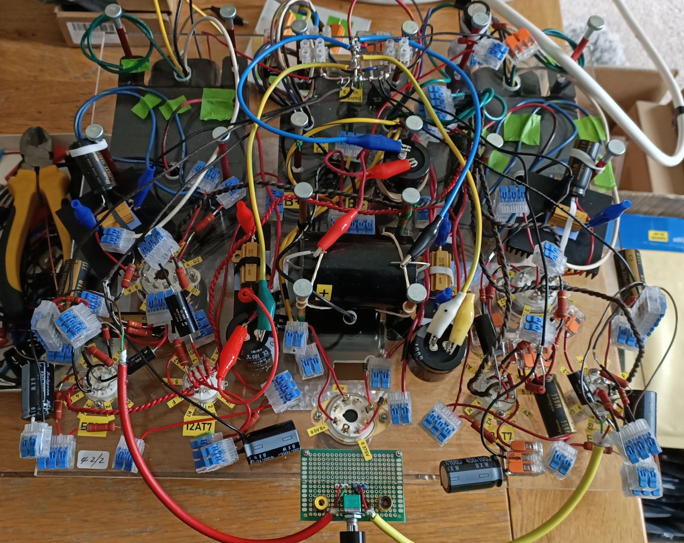

Here's my ratnests build, I have created multiple star grounds as it's just a test prototype.
Sounds great, however I think the EF86 is making a hissing sound, you have to put your ears to the speakers.
Amp currently running in UL mode. KT88 bias voltage of 41V and plate is 406V. Bias resistor is 560ohm.
Dang these things get bloody hot, first time building something like this.

Not a rats nest it’s more of an alligator farm! Putting the feedback to the second stage works but it’s technically not global feedback anymore! It’s multistage feedback As global is output to input. Feedback can be useful but too much is a bad thing too. Listen to various levels of it before deciding what you like.
Haha yes. It allows me to try different components easily. I've removed some of the clips and used soldered connections since.
Also second channel is now done.
I'm surprised how well it works like this.
I will play about with the feedback resistor, I manged it get it to oscillate, might need a mica capacitor across the resistor.

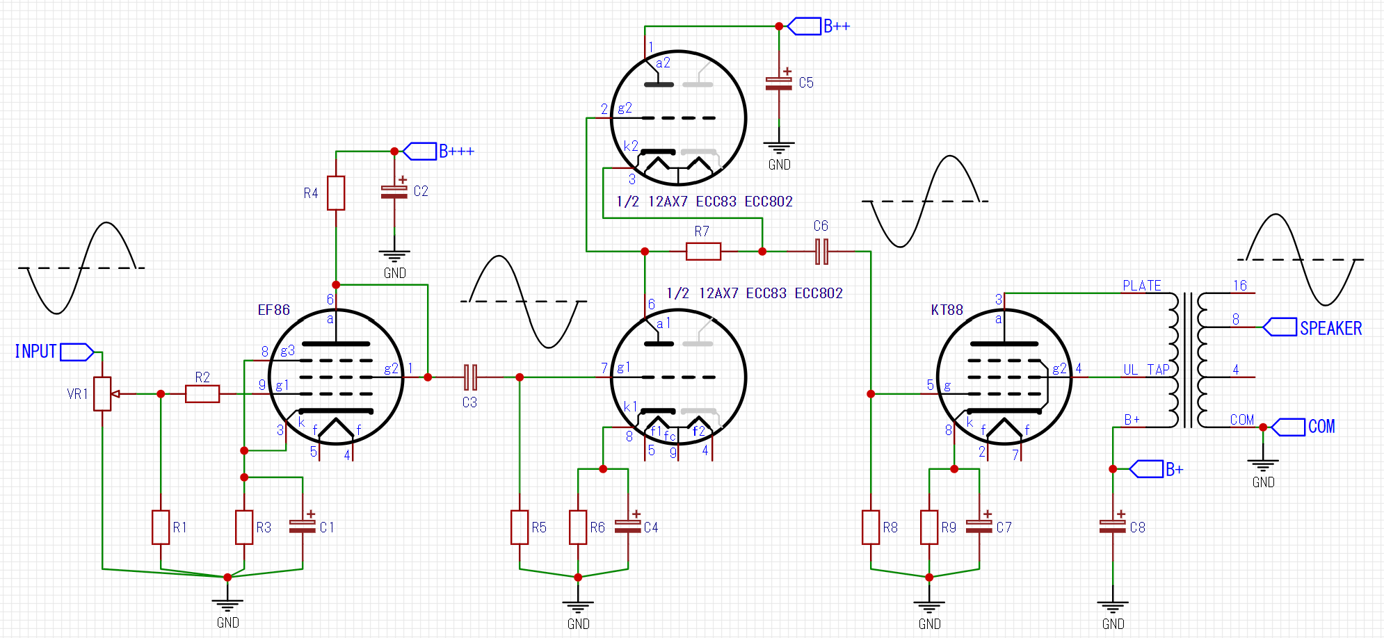

This is not so complicated.I'm hoping to get some clarification on the phase of single ended tube amplifiers with multiple stages.
I've seen a few different variations of this design, the middle section I believe is a MU Follower:
The way I understand tubes, is when a signal is taken from the anode side, the phase is inverted.
If that is the case why do I see this design come up a few times, isn't the output phase inverted when compared to the original input.
1. You have oposite phase at the input ! This is first issue,
2. Every amplifying stage doing 180deg phase shift - make the opposite phase that one at the input.
3. In this example You have 3 amlifinig stages. So the signal eill be inverted with 0deg at the input.
4. Last amplifing stage has transformer load.
5. Just reverse output polarity @ transformer secondary. COM pin is going to speaker +. And SPEKER pin going to - speaker terminal, AND optionaly to ground.
.Thats all to have in this 3 stage ampifing unit to have phase in = phase out.
cheers

Just one thing:
What is the value of negative grid bias for ouput tube?
What is the measured +V value @ R9/C7 point to katode of KT88?
I am asking that because I think that You can rearrange the circuit it can be as 2 stages?
Example:
persume that the +V@K of KT88 is +40V
that alowing smaler value of input signal to the output tube to be less than 2x40Vp-p
IF the input signal is say 6Vp-p
Then You will need input stage amplification of 80/6=13.3 times?
That is little bit smaller than say ECC82 as input tube.
You have many others too to choose.
Than You can have phase in = phase out and with that connection of the speaker terminals as You sketc first?
Cheers.

And even few hunderds of mV IF You employ ECC83 in the SRPP stage before output tube.
One is obvious - it is huge mistake to state ecc82/ecc83 in that design as "option"
ECC82 has mju factor of 18cca and ECC83 has mju of 100... 🙁
Example:
Cheers.
I dont know precisly, but
i think in this version You will have small sensitivity, maybe less than 1Vp-p for max power.
@Zoran
KT88 bias is 39V, I'm trying 470 - 560 ohms, the higher the loadline the lower the distortion.
I purposely decided to go with this design. The EF86 is configured as a triode so the gain is reduced as well as the distortion.
I'm not too worried about not having GFNB.
I'm trying to drive this to peak with a low level input, this design achives this. 0.3VPP gets me the full 9W per channel output.
I need to try some different non Russian EF86's, the ones I have are definately microphonic.
If only I had an audio analyser to verify what my ears can hear.
You probably have one, a sound card with line input can be used as an audio analyser using freely available software like REW.If only I had an audio analyser to verify what my ears can hear.
