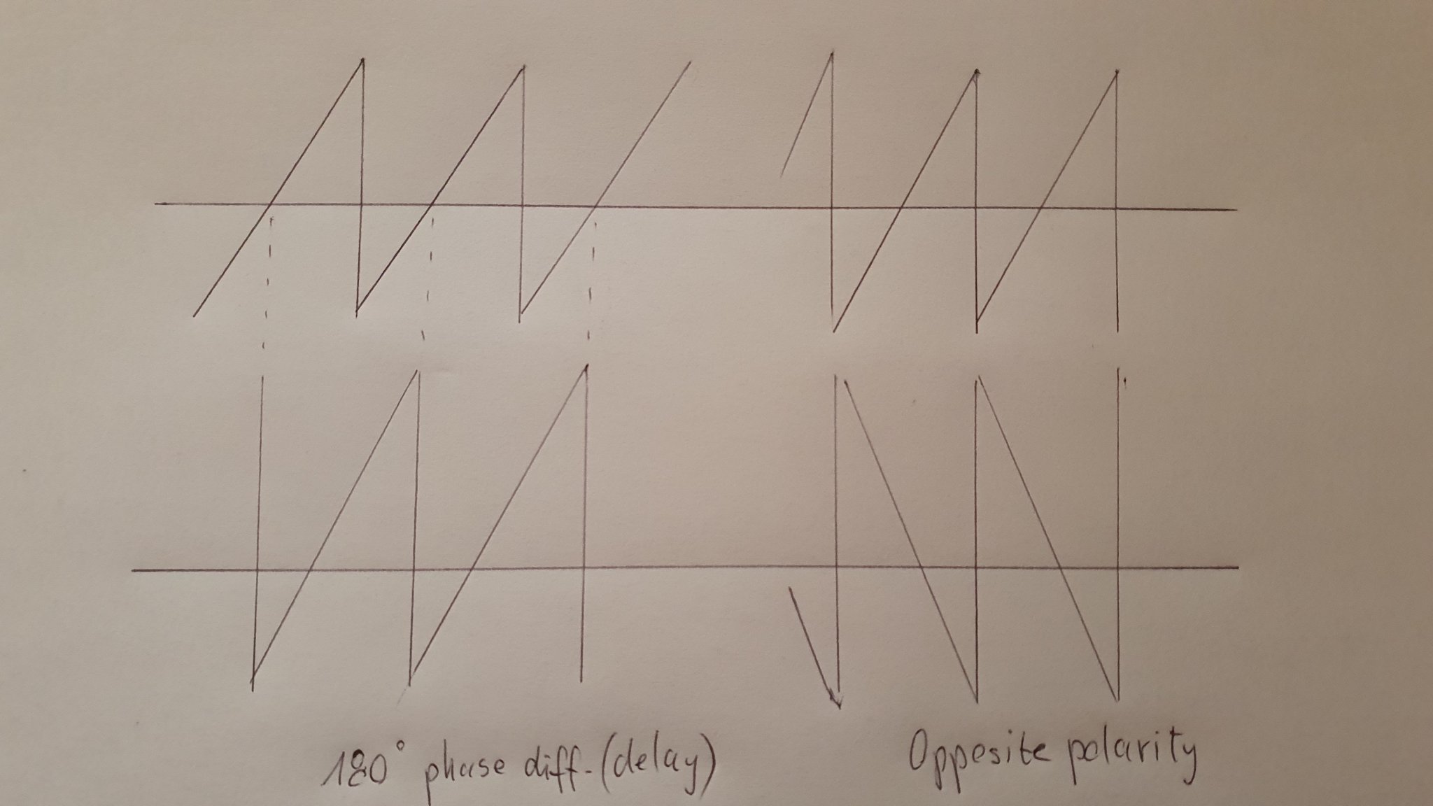

1962? We must be almost exactly the same age, fellow Geezer. Maybe the best part of Geezerhood is the freedom to argue arcane topics at all hours. A luxury we couldn't have imagined for most of a (seriously) working life.
Let me put my argument two ways: First, time is unidirectional, so it's not possible to have a negative phase difference between a point in an amplifier causally downstream from another point. Whether we were taught it correctly or not (and I certainly wasn't) phase angle can only increase as signal passes through an amplifier. Each stage, each series'd reactive element adds phase angle, each unto its nature. It's not physically possible to subtract angle because time is unidirectional (unless you're a photon, then everything happens at the same time. must be confusing).
Second, we're taught rotating vectors and their basic trig in a context of simple repetitive single frequency waveforms that started at the Big Bang and will last forever (both actually required for them to be repetitive). In this model, time doesn't matter so can be abstracted out. And from this model, we all grew up conflating 180 deg phase difference with an inversion of polarity, because it's true in that model. But actual amplifiers don't have internal 180 deg phase differences (meaning the sum of all phase angles though the amplifier and back through the feedback network if used), except at frequency extremes where loop gain must be less than 1 for stability) and do have causality and an arrow of time.
Polarity is an abstract that depends completely on how you choose to connect your metering contacts to the measured point. Put the red on one side, the black on the other, or reverse them, you haven't changed anything. It's true independent of time or "phase" or anything else.

Quick sketch
Thank you for providing a better example, and still framed within a time vs. magnitude model. Although these two waveforms are based on a continuous (time invariant) model, they still show, better than I could explain, the difference. The conflation is deeply engraved into all of us, so a hard sell. Maybe thinking in terms of an impulse might be a useful approach, but your example is better.
All good fortune, and thank you for your insight,
Chris
