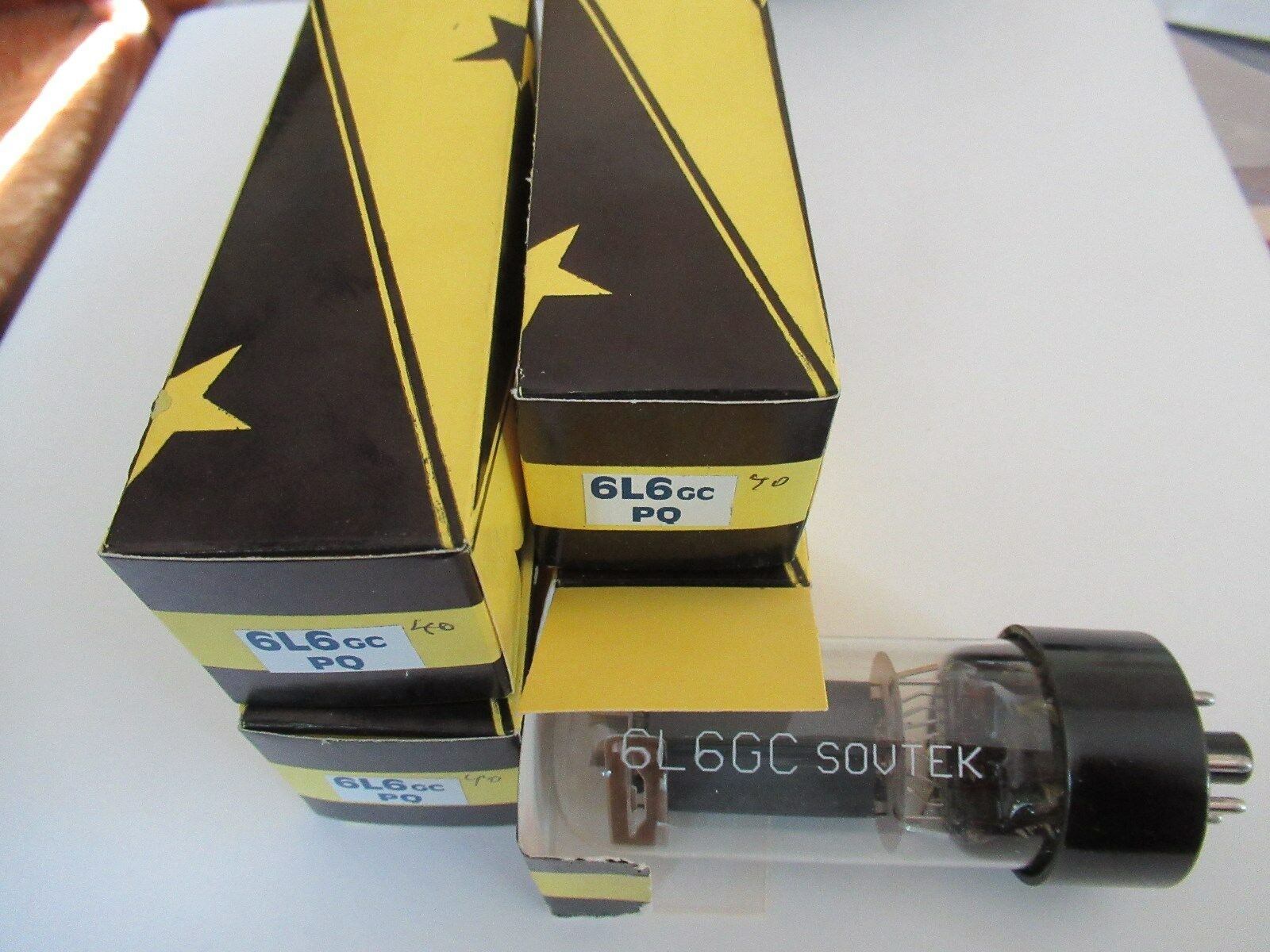

As for Sovtek 6L6GC it is a different kind of a beast. Those are NOS I got off of ebay for a ridiculous price of 20EUR a pair. I know they like higher impedance on the plates than the EL34 (the outputs being at 3.5K) but that didn't seem to be an issue, especially when triode strapped. However at a first listen I thought they were worthless! They sounded very thin and glassy and broke up quite quickly. I never dreamed about how they were gonna creep onto my ears during the next 100hours of burn in. There is something incredibly sweet to the vocals and wind instruments on those 6L6s, the highs are just so juicy, so feathery and soft to the ear yet so nicely defined at the same time.

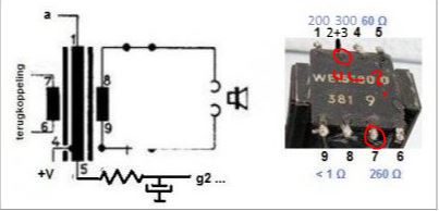

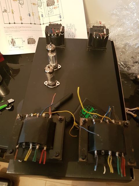

This is what the outputs look like:
But what are those OTs, and what is that weirdooh feedback network soldered between those terminals anyway !??

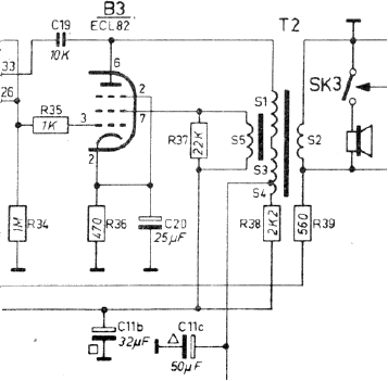

However I have the schematic from that Dutch forum and it's really exciting to have the trannies! Just can't wait to start working around them.

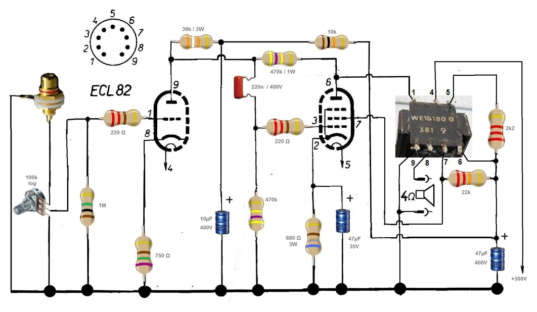

Here's the schematic:
I really appreciate simple designs and I strongly share the belief that the simpler you go the less things can go wrong, hence better linearity, etc. A good example is how phase splitting in badly build PP configs can mess things up, or the fact that it sounds too clean because of inherent noise and third order harmonics cancellation (which we find desirable in SET configurations).
I am not a fan of that feedback going to the preamp plate at all. I have read not long ago that SET configurations do not benefit from any kind of feedback whatsoever.

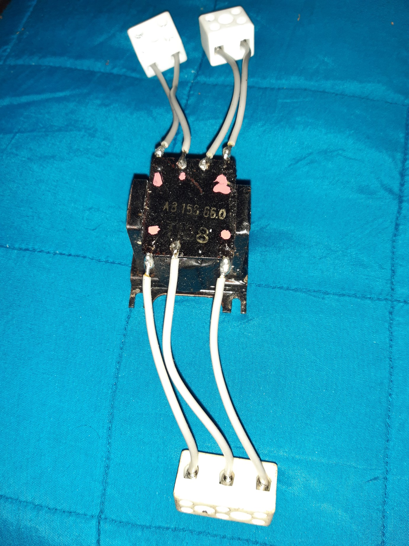

Those trannies are specced for EL84 and the such but wanting something more unique I took the bait and ordered a lot of 6P1Ps from off of ebay + some russain 6N2Ps for the preamp (they seem like an excellent 12AX7 equivalent with a slighltly lower mu of 80 or 84).
Yet, being impatient to work with those things I actually found some tubes on the bottom of a box with markings completely erased on them. After some digging I found that I have two noval bases that came with the rectifier tubes for the trannies, a single TUNGSRAM EL84 that looks very very burned in lol, and a pair of also very burned in Ei ECH81s heptodes (HEP--wait whatt !?).
Yep, here it is LOL:

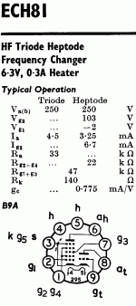

I've seen some ppl online mess with those to build some funky preamp circuits and sure it sounds fun. But, I knew what I wanted. I just decided to ignore the HEPTOFUNK mess and use triode part of the tube and built the circuit around it's specs. I also triode strapped the one EL84 I've had, built a pretty straightforward solid state power supply, wired everything up with an older 4ohm speaker first and I was purely blown away with the highs and vocals! I cannot beleive this. This little mess of an amp sounds even juicier and more open in MONO than my SET EL34 one!! Is it possible that this is all due to the output trannies !? Wutt is goinn onnn ??

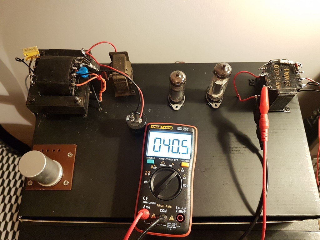

After some testing I decided to wire this less than 3W output thingy to my 93dB 8ohm 100W power handling klipsches in parallel!! Now I'm ever more confused! I was always aware of the importance and of the beauty of the first watt, but this ? I never expected this!!! Also, the solid state rectifier seems to be very nice with a SET config as it helps tighten the low end just a notch up.
Here is what the whole mess looks like:
Yes! That is a cardboard box ! But I can't stop listening to it! In mixed mono yes! Just cannot believe it!
What do you think of the power section pplz ? Any opinion on those Y caps for the zener bridge operational coupling ? I used a bridge on two 250V taps there and when capacitor coupling the negative rectfier lead to the tranny ground the DC voltages stabilize at 250, when the bridge is grounded directly however the voltages add up to about 370V. I'm wondering if I should have probably done half wave rectification there, but I did get a stable 250 for the B+ this way.

That is a popular belief, but quite untrue. True that the less there is the less to go wrong; false that this leads to better linearity. For good linearity you need the right amount of stuff present; too little or too much can lead to problems.operater said:I really appreciate simple designs and I strongly share the belief that the simpler you go the less things can go wrong, hence better linearity, etc.

You're right, not linearity - I kinda messed the phrasing there. Rather, musicality and "naturality" for the lack of a better word. Nothing can beat the relaxed and musical nature of the triode, the soft tone, the sweet soft distortion... Yes, it's all except linear.
But as for the simplicity, I have read some strong arguments backed by some science, against any kind of feedback in single ended designs. I'll try to look those up and link them here eventually.
So, once you get rid of feedback and UL it's as simple as it gets. I'm curious as to what else could be done better ? Really open for ideas. As for that schematic I added a couple of cathode 220uF bypass caps on both stages and that's it.

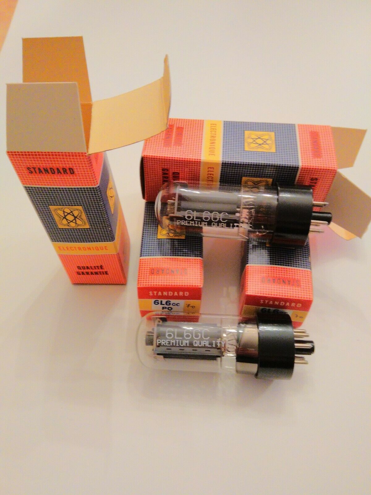

I also got some pairs of JJs EL34s and a pair of NOS Sovtek 6L6GCs in the meantime...
Huh? Hard to believe that NOS 6L6GC's were made anywhere outside the U.S.
Btw, these old Philips radio output transformers can be called mediocre, at it's very best. But if you like their sound...

@Kay, as for the tubes you can check them in the photos attached. I have the orange packed ones which were french market versions of the ones to the right. I didn't manage to find any additional information on them, maybe they are more recent production but I don't think from this century. For the price they went, they are marvelous.
Indeed, these OP are optimized for the table radio or taperecorder they were originally in. Philips was inventive, offering lower priced goods to the masses. Do not try to squeeze an extra watt out or to give full bass down to 40Hz, they weren't designed for that purpose.
The extra winding is used to prohibit core saturation as opposed currents cancel out. There are several versions of these small outputs, some having a winding that can be applied for cathode feedback with ECL82 EL41 EL821. I made one this way with an ECF80, ca 1W but great fun. It takes an excellent loudspeaker to get the most out of them, like the old Jordan Watts. Enjoy!

I dared using it with EL84 as it's about the same plate load as the tubes this was designed for. Same will go for 6p1p I am most curios about.
Could it be that the extra winding on those outputs is meant for the cathode feedback besides for preventing core saturation ? If you look at the original schematic, those windings are attached to the screen grid at the tap 7, but that is not UL operation from what it looks like.
What appears to be the pure UL tap is the unused one between the taps 1 and 4 but there was never any solder on it.

The g2 tap or the other primary tap could be some sort of hum bucker. This was fairly common in cheap valve radios. UL with a cheap small transformer is likely to cause problems, so was rarely used in valve radios.
There is no reason why feedback cannot be used with single-ended stages, apart from the problem that sometimes the distortion can be so high without feedback that you get lots of re-entrant distortion with feedback.

I have a pair of those OPTs, or very similar, from a Phillips reel to reel tape player.
I believe there is both UL and CFB windings on them.
However, for an 8R resistor load, they werent much good in the bass, without output dropping by 300Hz (the built in speakers in tape decks cant have been that good anyway)
Originaly the winding S5 was used for UL.Not a tap on S1-S3 because the screen current and from the rest of the circuit goes though the anti hum S4.I have a pair of those OPTs, or very similar, from a Philips reel to reel tape player.
If not used for UL it could be for CFB or other FB ways.
But the screen current still has to go via S4 for (partly)DC canceling.

Mona, can you please post the complete circuit .Originaly the winding S5 was used for UL.Not a tap on S1-S3 because the screen current and from the rest of the circuit goes though the anti hum S4.
By no way these tubes are real 6L6GC's. Despite their printing they don't even resemble them. These tubes show the old fashioned and outdated pinch stem construction, while a real 6L6GC has a Bantal envelope. I severely doubt that your tubes, most probably relabelled 6P3-E's, can handle the 6L6GC's plate dissipation of 30 watts. 19 or 22 watts are more probably.
This is a real NOS 6L6GC:
Note: The construction is directly welded to the pin leads, as with EL34's.
Best regards!
Ouch. Sounds really suspicious. They do resemble 6P3s more, which are indeed lower dissipation but they do sound great.
