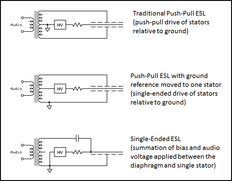

And the picture i was looking for posted by Bolsert, noone mentions the type of coating trough.
Any one know if you need a a low resistive coating to be able to use this concept ?
There is is also a capacitor in the schematic ? is it needed ? and what kind of should i use

weird i dont get any sound using the schematic 🙁 wtf am i doing 🙂
is the resistor in series with the bias of importance ? i mean it is not for the push pull to work at least 🙂
Yes, for single ended operation it is important....is the resistor in series with the bias of importance ?
Try R in the 1Mohm to 10Mohm range and C in the 0.01uF to 0.05uF range and you should get output.
Yes, a low resistance coating is required....Any one know if you need a a low resistive coating to be able to use this concept ?

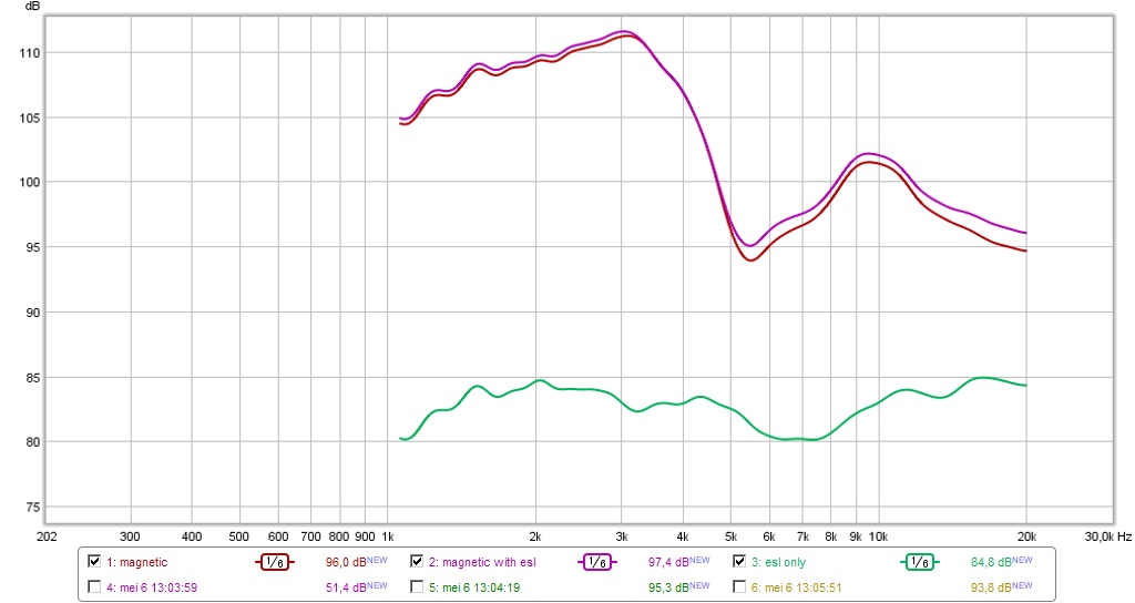

Ok i got sound out of it 🙂 be is compared to the magnetpic planar on the same foil, 15 db down or so 🙂 not very usefull 🙂 haha
as coating i used graphite measuring somewhere in the region of 12K Ohm, or is that even to high ? if so then only metalized mylar is an option 🙁
well always good to try 🙂 but i dont think i will use this idea haha
here a dirty measurement dB scale is not calibrated, so only differences are correct 🙂
Oh i forgot these test panels where only 0.9 ohm :O haha so it is not at all fair to compare to be honest 🙂
Another thing, i got rather ok sound then it is sounding weirder and weirder and then allot of distortion... 🙁 single end is harder to do then a normal one wtf 🙂
Ok so i noticed ticks and plops coming from the cap. so i guess it has to be a high voltage cap ? a 250volt 0.047uF wont cut it 🙂 it sparks over apparently 🙂
i think the problem is i use a spacing of 1mm so have to have some bias on the foil to be of any use. this cap is connected to the bias trough the resistors to one of the transformer output... my guess in most designs they used a bias of only 300-400volt and a really small spacing (for efficiency )so the cap is fine with that,but with 2kv bias .... not so much 🙂 haha

Yeah...I probably should have mentioned that, sorry.Ok so i noticed ticks and plops coming from the cap. so i guess it has to be a high voltage cap ?
Oh well, you figured it out, it only cost you a capacitor, and now you are less likely to forget 😉
