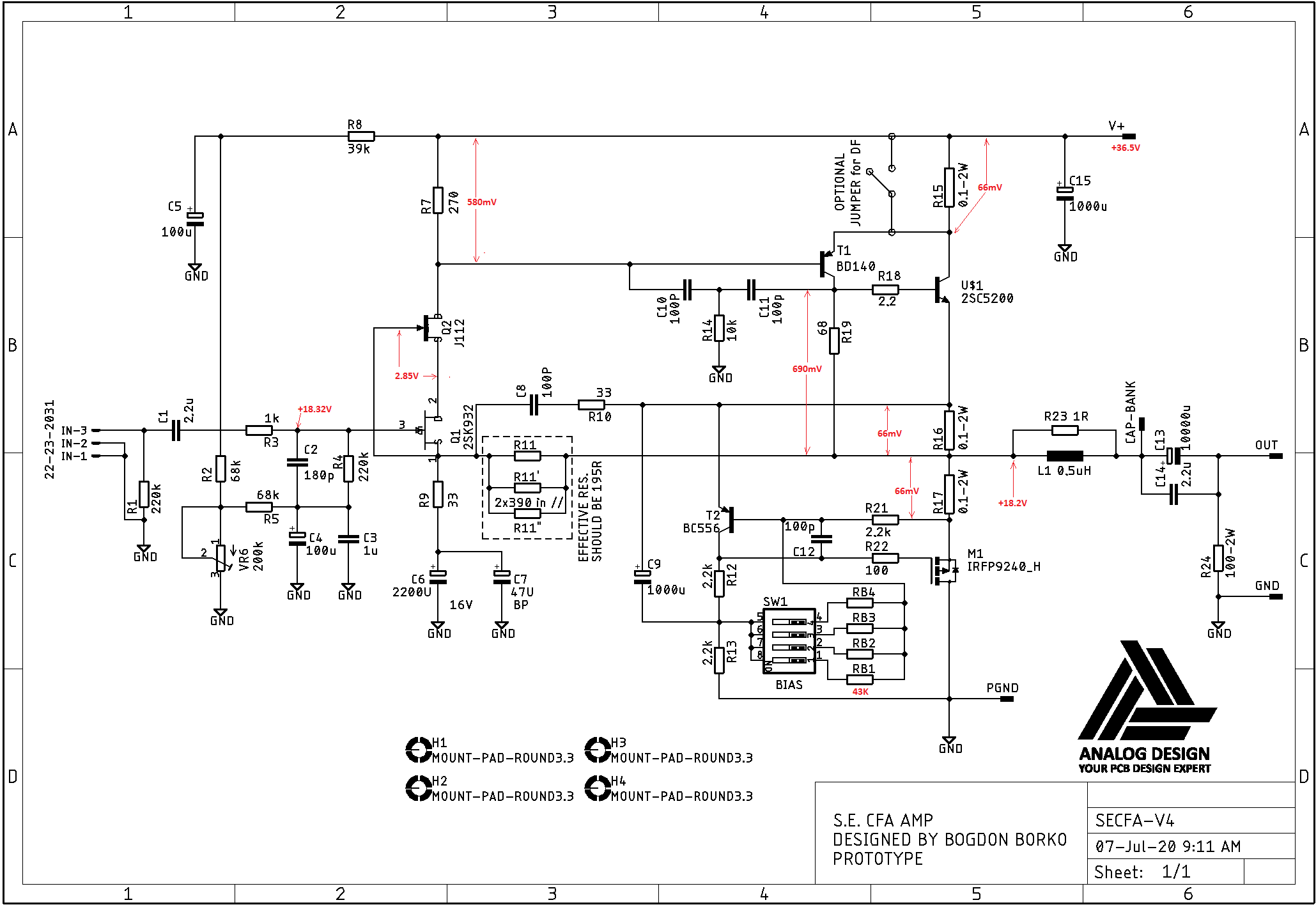

I added a CoilCraft 0.5uH fixed inductor, the legs need to be bent to fit into the pcb. Or if you have the enameled wire eliminate it and wind your own.
Hi Borko,
Just wanted to double check the adjustable bias resistor values:
RB1 = 5K6
RB2 = 6K8
RB3 = 8K2
RB4 = 10K

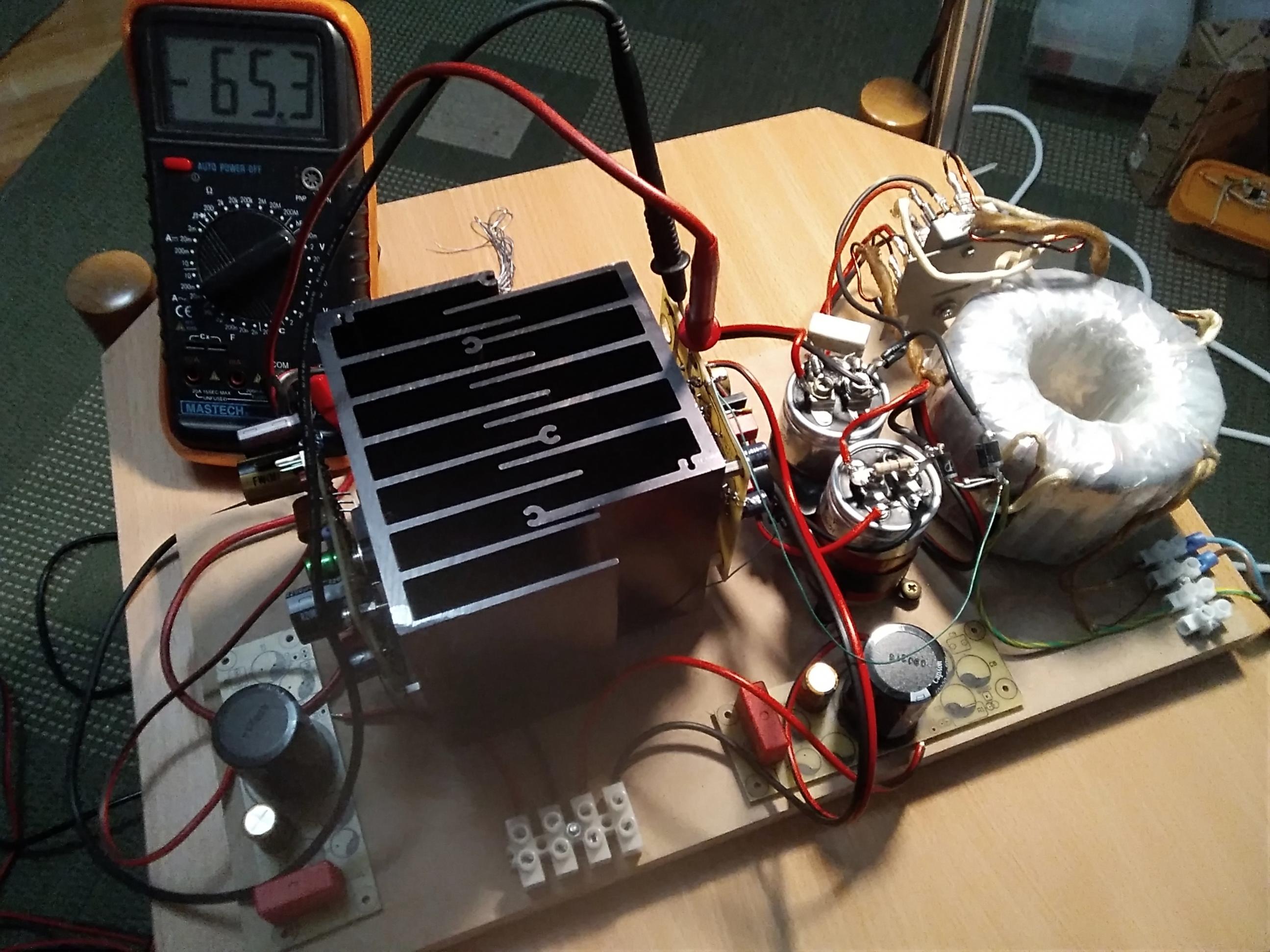

Both proto channels working and ready for listening.

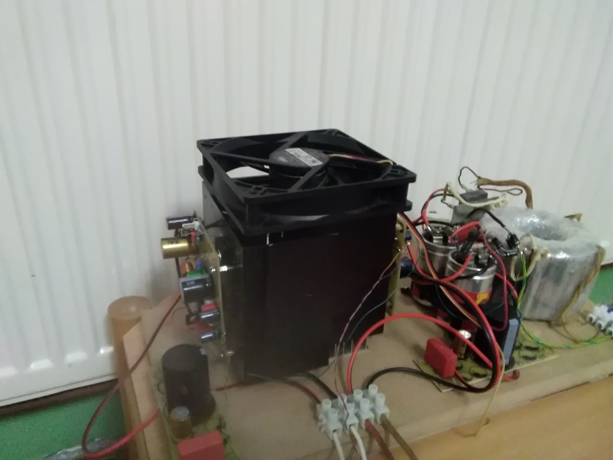

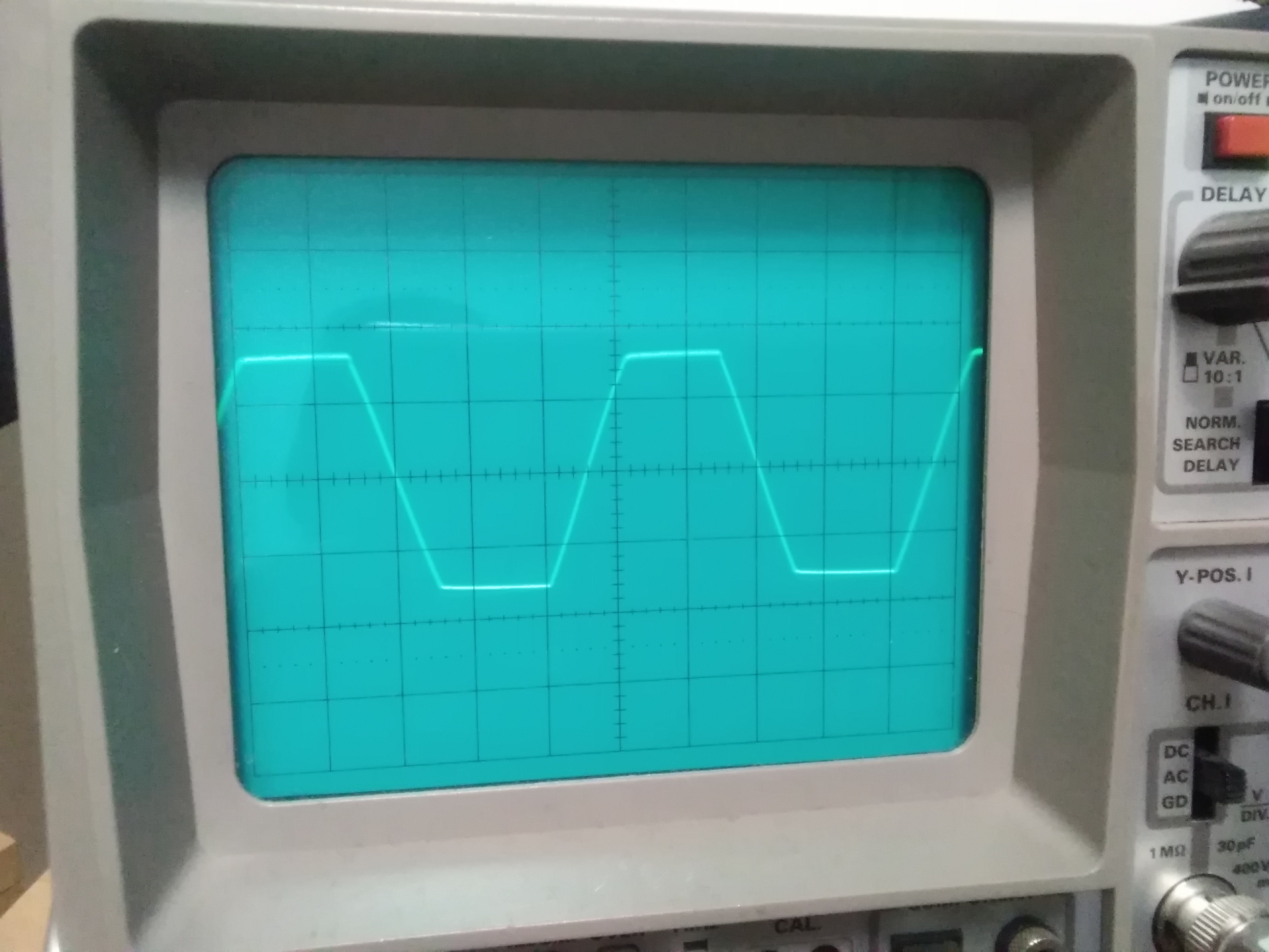

Fan at only 3V5 DC, makes wonders.. It sounds very good, I wouldn't change anything else, maybe compensation caps revisiting after listening tests and square wave measurements... Btw, I tried, and it's stable and does not burst in to oscillation without all 3 comp.caps.

What is the bias current and input voltage with this setup?
This works at 35V DC and 0.6A bias at the moment. I'm listening to 96dB/8 Ohm speakers in a 20 sq.meters room and "loudness" and power are not the problem...
One thing, value of the bias resistors (RB1-4) depends a bit of power supply voltage, and values I've sent are for 35V DC. If any other p.s.voltage is used just connect 100K trimmer instead of RB, adjust for idle currents you want, measure the trimmer values and then solder fixed resistors on pcb,.
Cheers, Borko.
One thing, value of the bias resistors (RB1-4) depends a bit of power supply voltage, and values I've sent are for 35V DC.....
Ok, initial bias setup should be done with a 100k pot.
The parts sheet should list RB1-4 as TBD (To Be Determined) with a procedural note to help builders.
I’ll edit the Mouser Project cart to include a 100K trimpot and RB1-4 based on 35vdc power supply, thanks Borko 🙂

One simple idea I got for the fan supply. 12V /12cm computer fans on lower voltages have lower rpm and are noiseless. With only 3 volts on a 12V CoolerMaster fan thermal capacity of heatsinks is nearly doubled.
The problem is that 12V fan can work on 3 volts but won't start.. That is why i bypassed the resistor with cap. Very simple solution..

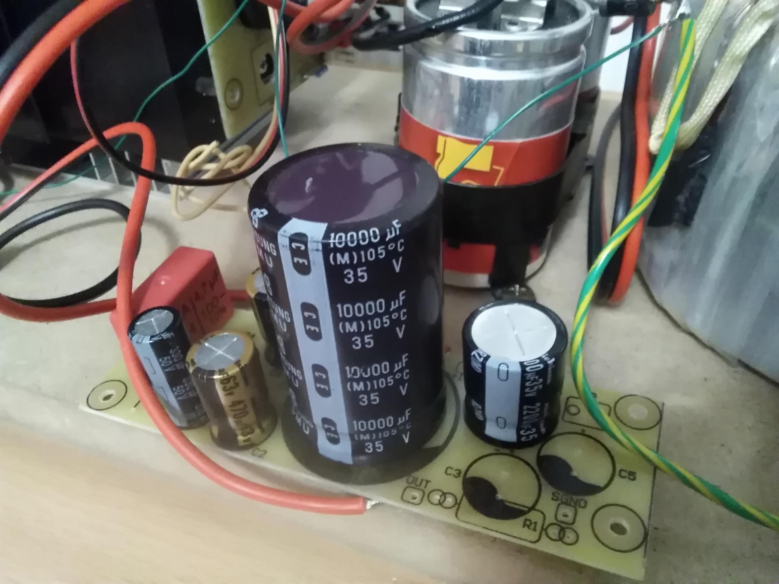

Output caps are of course important, for the sake of experiment, first I tried cheap 10mF capXon and it sounded plastic, don't bother with cheap caps, I'm currently using combination of various caps, btw I think I'm going to keep this old nos samsung cap, sounds great (transparent). 😀
