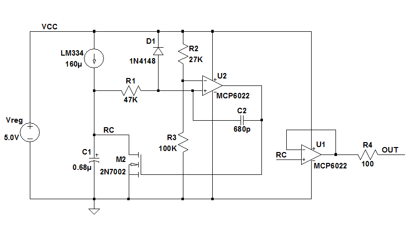

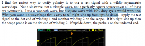

I slapped together a little sawtooth-wave generator on a scrap of perfboard, to help me figure out transformer winding polarities (also known as Winding Dots). It is powered from a little 5VDC wall wart adaptor, that I salvaged from an old "Wireless G" wifi router in the trash heap.
Since the circuit runs from single supply 5V, I selected a CMOS 5V rail-to-rail dual opamp from Microchip, the MCP6022 (data page), of which I have several dozen in my parts box. The first opamp is used as a comparator, and the second is used as a unity gain buffer, at lower right. 100 ohms in series prevents anything bad from happening if the output drives a very low impedance load, such as an accidental short circuit.
You can simulate this exact circuit in LTSPICE and watch it work; just substitute a Linear Technology 5V_RRIO opamp in the simulation. It needs to be CMOS because you overdrive the input pair by 2 volts; bipolars would melt. The LTC6081 appears to be a good choice.

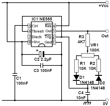

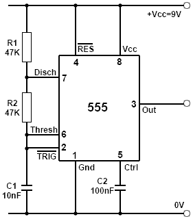

HOWEVER, months after I built this thing, I realized that any wildly asymmetric waveform would accomplish the same mission (transformer dot identification); the only requirement is that you be able to tell right-side-up from up-side-down. A square wave with duty cycle << 50% meets this criteria, and is waaaay easier to generate: just an NE555, 2 resistors, and 2 capacitors. D'oh!

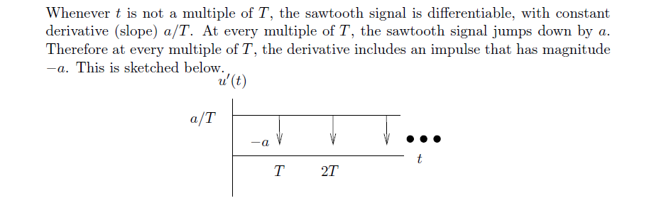

Hi Stuart, I don't think that's correct. I don't think the integral of a square wave is a sawtooth wave. Why not? Because the derivative of a sawtooth wave is certainly not a square wave. Rather, the derivative of a sawtooth is a constant (where the waveform is a ramp) plus a negative Dirac delta function, an impulse downwards (where the waveform is a step).
Stephen Boyd assigns this as a homework problem in his introductory circuits class at Stanford Univ: 3(d) In the space below, sketch the derivative of a sawtooth signal. Be sure to label all axes, slopes, magnitudes of any impulses, etc.
Here is his answer from the solution sheet (link):
439847d1411417863-sine-square-waves-sawtooth-waves-stanford.png"]
It's a constant (at a/T) plus a delta function of magnitude -a .
Probably what you meant was that a triangle wave is the integral of a square wave. However a triangle wave is symmetric, which may or may not fulfill the original poster's requirements.

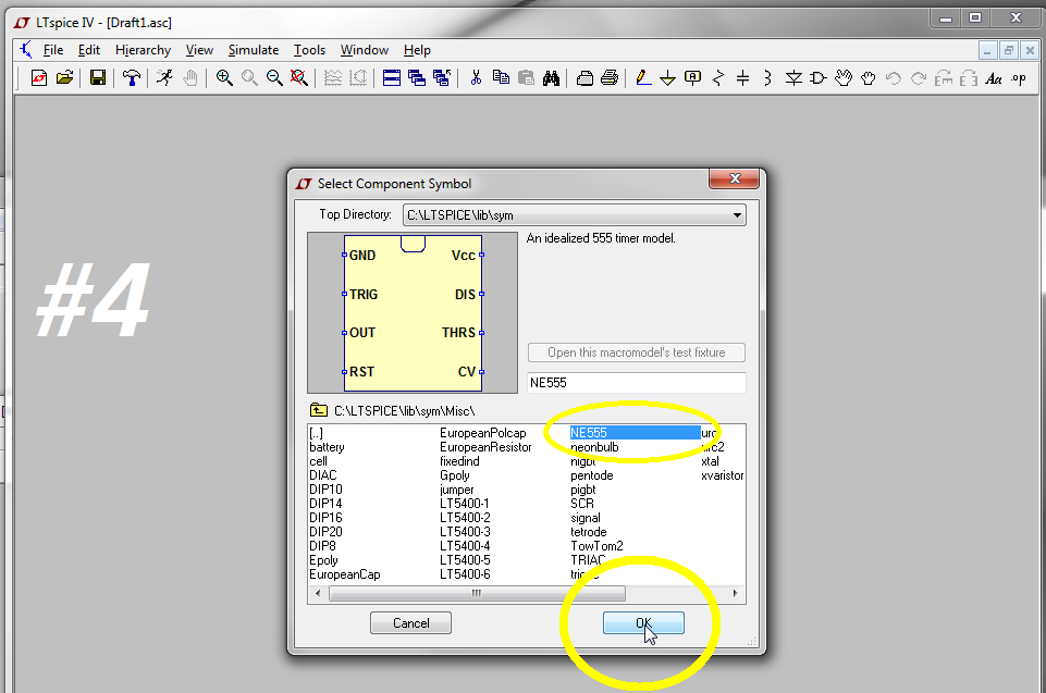

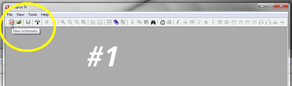

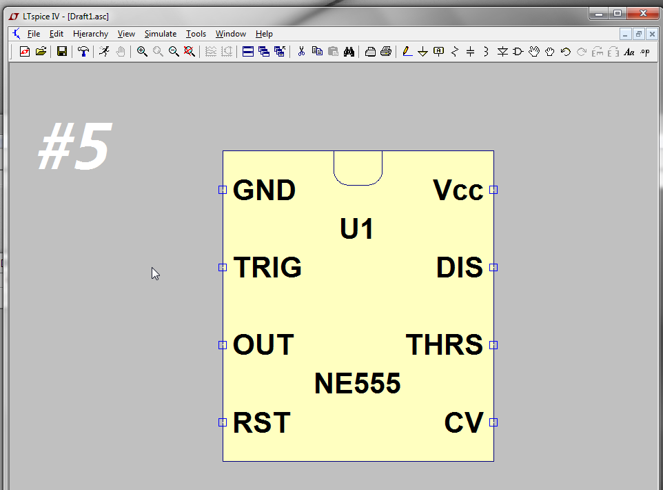

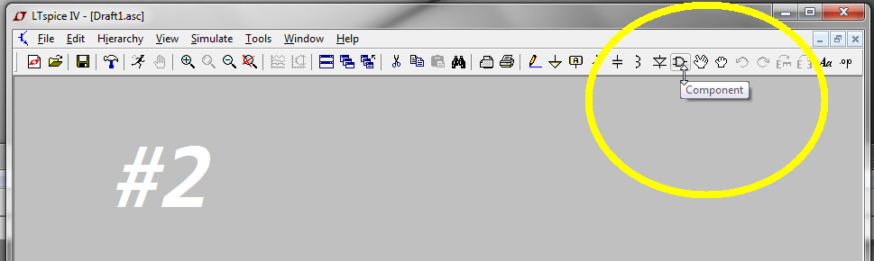

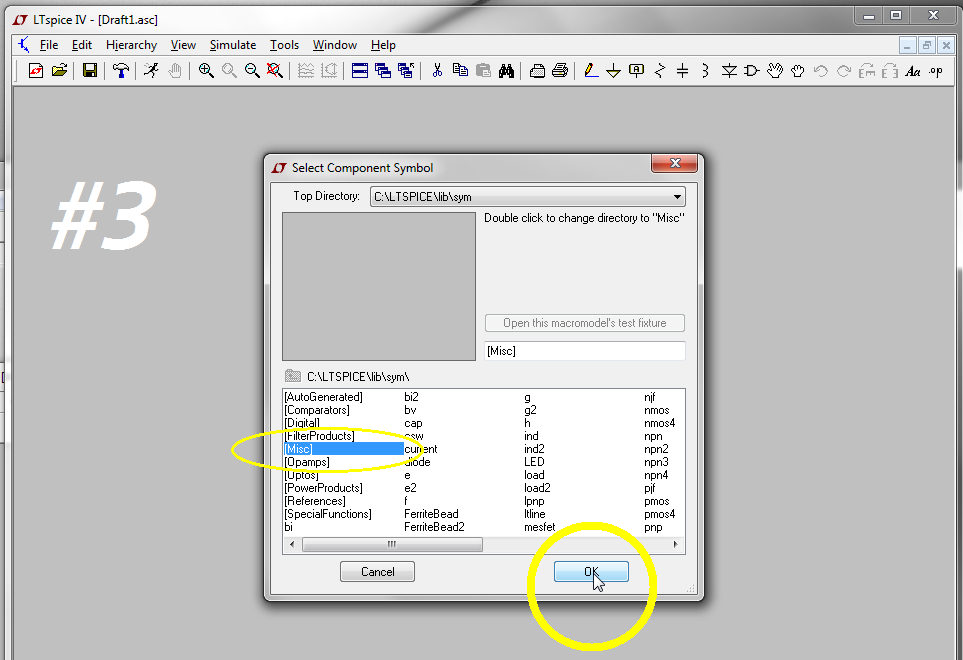

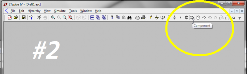

LTSPICE ships with a presupplied model of a 555 timer IC. It is found in the "misc" library, name NE555.
look for the word "misc" in the images below.
