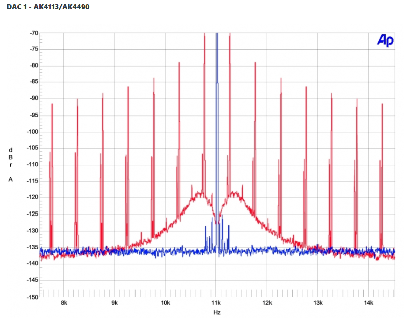

The 8416 is not that bad, BUT there are caveats. First, preamble locking must be used. This leaves fairly large levels of random noise jitter. Second, the PLL must be optimised
The random noise jitter is low enough for 16 Bit.
Only acceptable one left in the arena seems to be AK4118.
I tested AK4113, it was much worse than CS8416. WM880x is significantly superior.

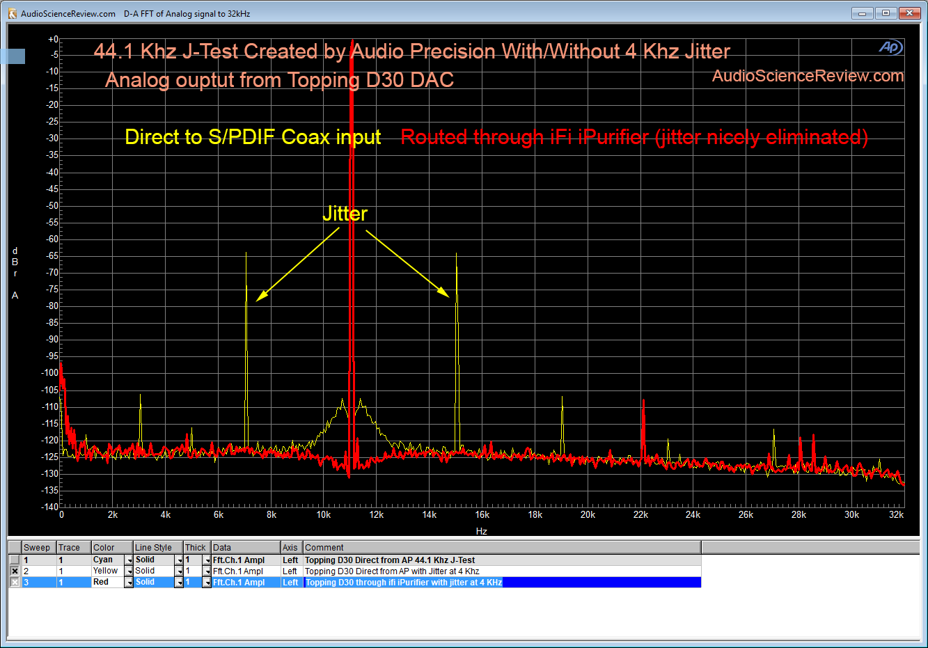

To wrap-up my monologue here are some jitter measurements.
1. SPDIF (Coax) - AK4118 - AK4490
There are strange artifacts about 85Hz apart. These are the same artifacts as shown in previous post. I assume these are somehow related to AK4118 PLL.
Now let's add AK4137 into the stream.
2. SPDIF (Coax) - AK4118 - AK4137 - AK4490
This looks much better. The reclocking done by AK4137 seems to remove most...
That is pretty poor. CS8416 in preamble lock mode is much cleaner if higher random noise floor.
Now we can debate if correlated or random jitter sounds worse, but I am not interested.
Outside the datasheet and urban legends the AK4118 is the worst currently available solution. Which is why I do not want to use it.

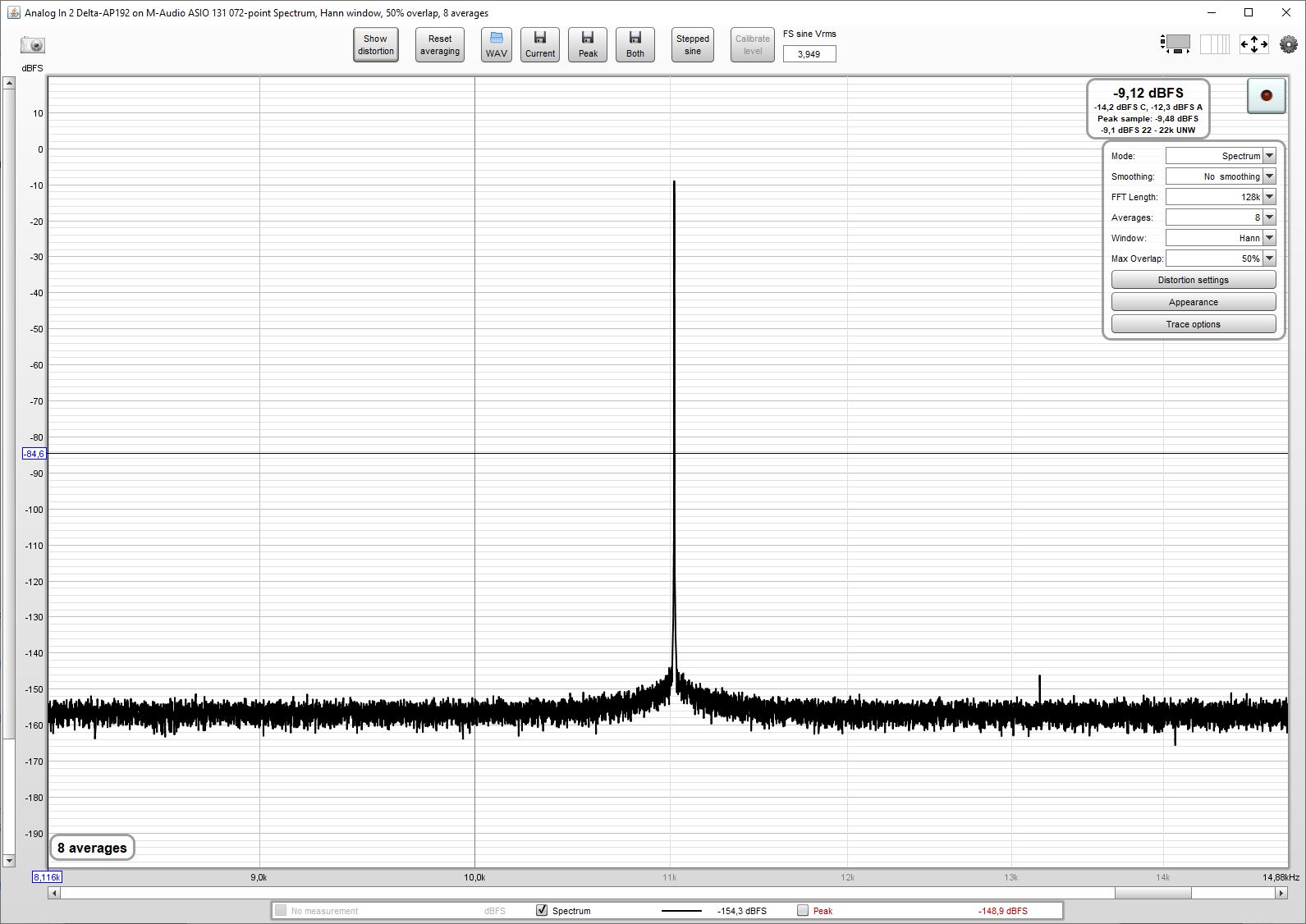

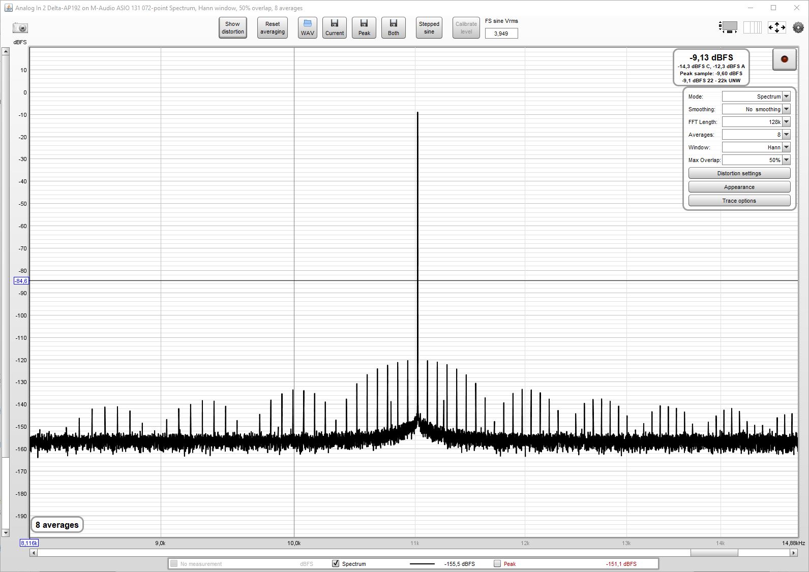

Measurements I did are here:
https://audiophilestyle.com/forums/topic/28851-new-launch-spdif-ipurifier/page/3/
We fed different DAC's this:
Here is what we got:
Note that CS8416 was set to "fast mode". In "slow mode" it actually kills jitter quite well. But the noisefloor is up.
Objectively, when properly optimised (layout, power supplies and crystal) I measured on average between 10-20pS RMS jitter on MCK and in the analogue output.

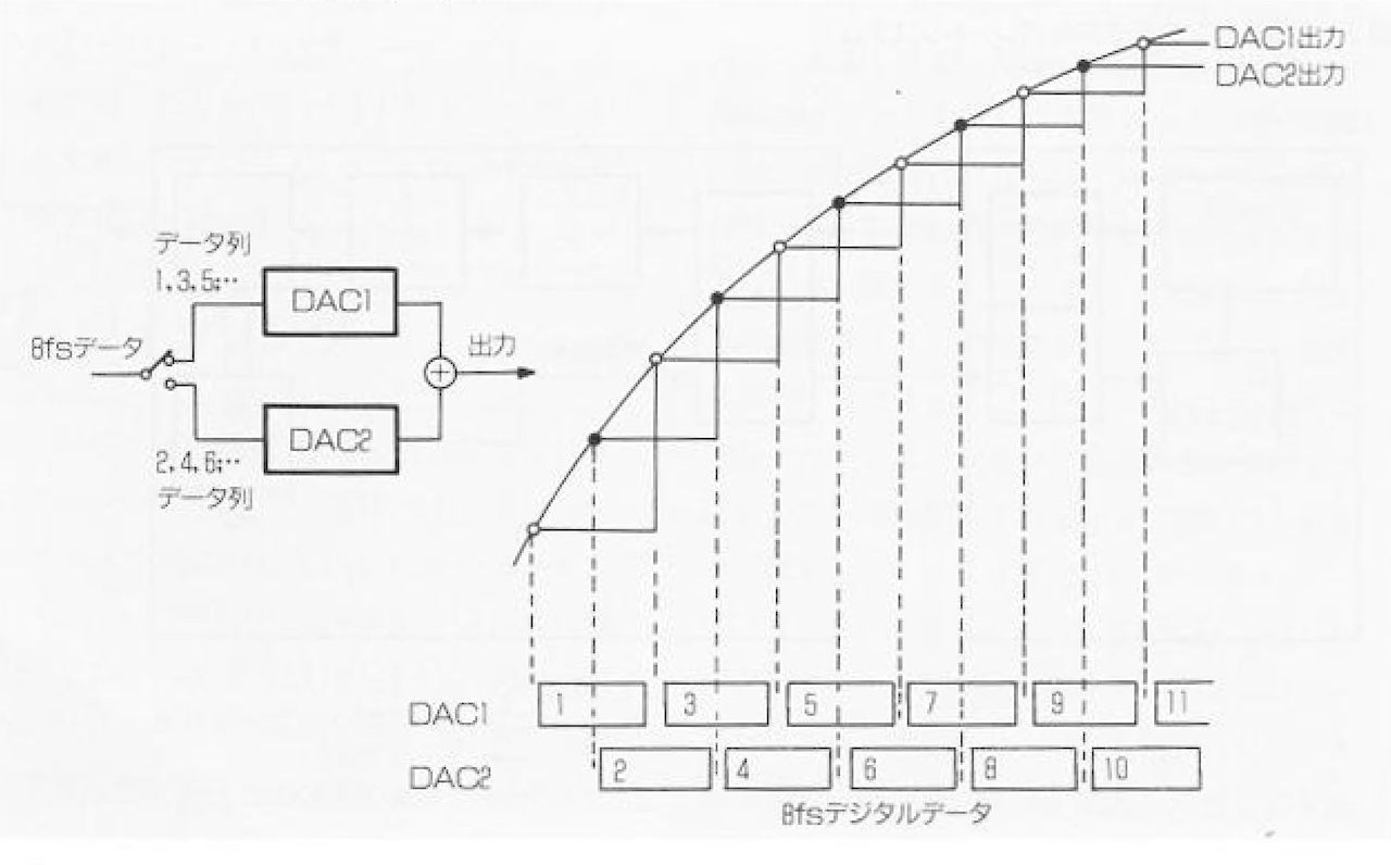

To replace CXD1244 a CPLD/FPGA probably makes a lot of sense. It would be trivial to extend this to running 4 or even 8 TDA1541 this way.
For 1 X run all in parallel, 2 X split into two backs, 4 X split into 4 banks and so on. I have done this for other DAC's (TI "advanced segment"), the principle is the same.
