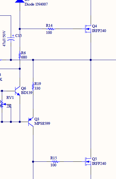

Thanks Zen Mod, I will make some test...calculator for the moment gives me too big low drop voltage for 1Hz because of Bias...but maybe a 10000uf cap can keep the voltage...
does anyone see this kind of iteration for C12 ?
I mean 2 N channel MOSFETS. Could it works ? Better, worse?
I'll be grateful to be pointed toward some piece of literature

Thank you ZenMod to try !
in fact my real question is: is it possible to replace P channel mosfet with N channel Mosfet ? changing polarity of course ? I have no experience at all but if is so, we could really match mosfets on both rails.
