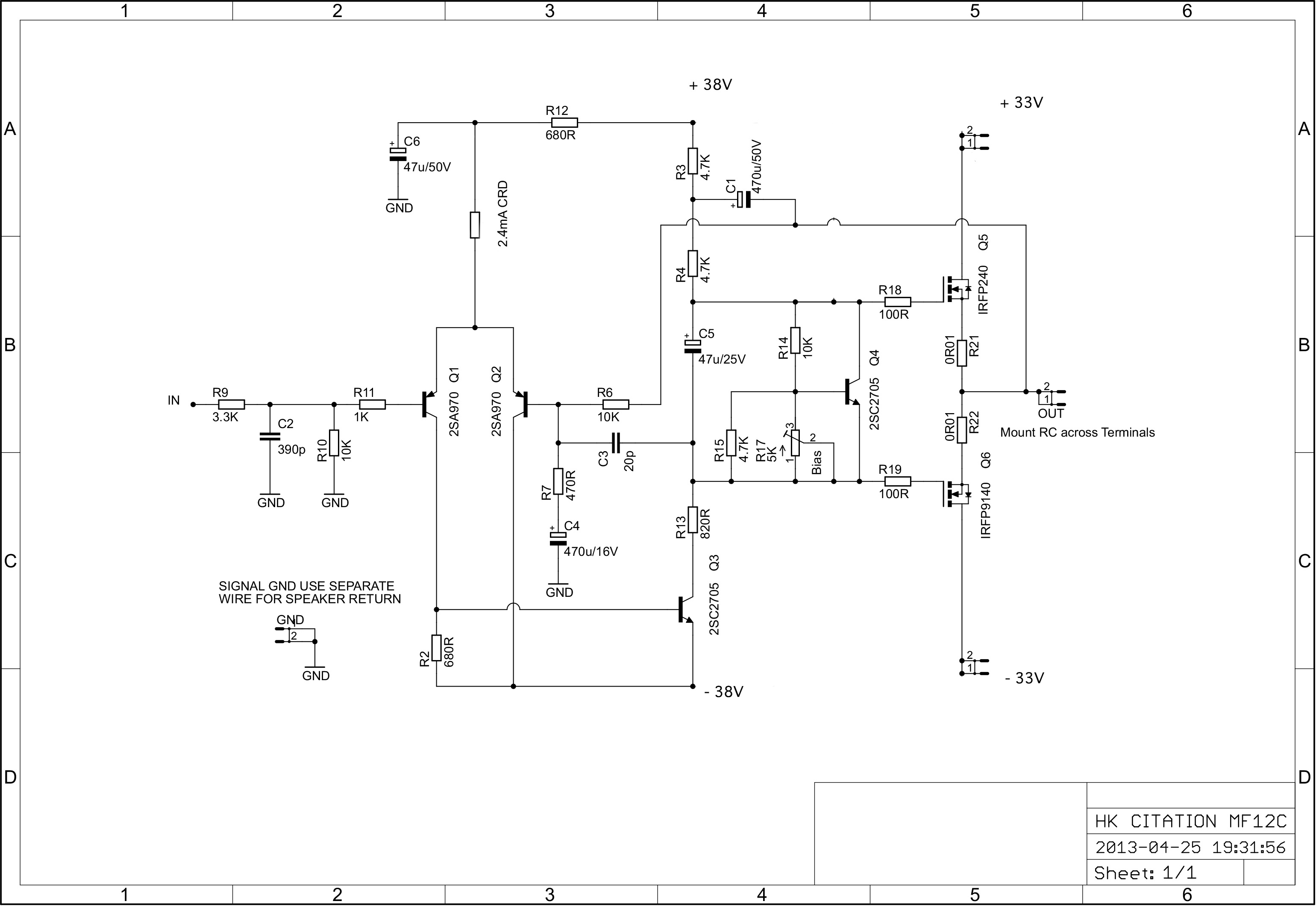

I was able to create my schematic in LTS. I started from scratch instead of modifying yours. I figured I would learn more and how to better use LTS if I created my own schematic.
I believe everything is correct except for the three CCS's; which I used the diode symbol for and the variable BIAS resistor. Could you help me get those symbols correct on the schematic? Thanks again for all your help and time!!!!!!!!!!!
That looks good Mike!
Should there be a resistor in series in the top rail?
Check your diode polarities, is there a band on the case
of the diodes, that is the bar in the schematic symbol.
I don't know where to get the correct symbol, you can
search online for LtSpice library add ons, or at the LtSpice
group on Yahoo. You could just make the component
designator start with CR instead of D.

Before chopping the PCB Tazz made with no return back, I would like some help to go in the right direction.
Many thanks and Happy 2017
Vito

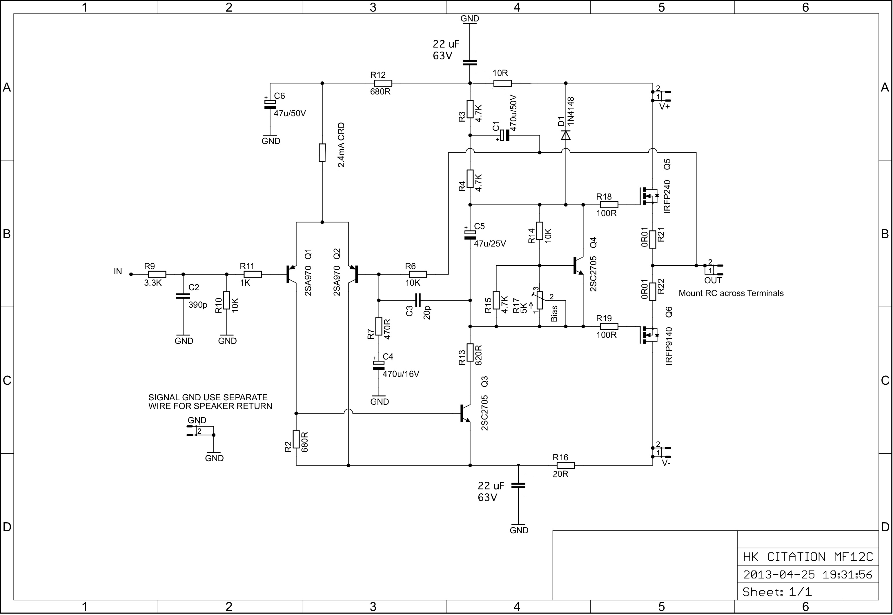

that show me a completely new perspective, I intended just sent cleanest power supply to the front end, but the FIRST WATT is the place to be !!!!
I've calculate the RC filter to not let drop the Voltage too much....
Thank you to take time to give a look if it's a good interpretation of your words!!!
