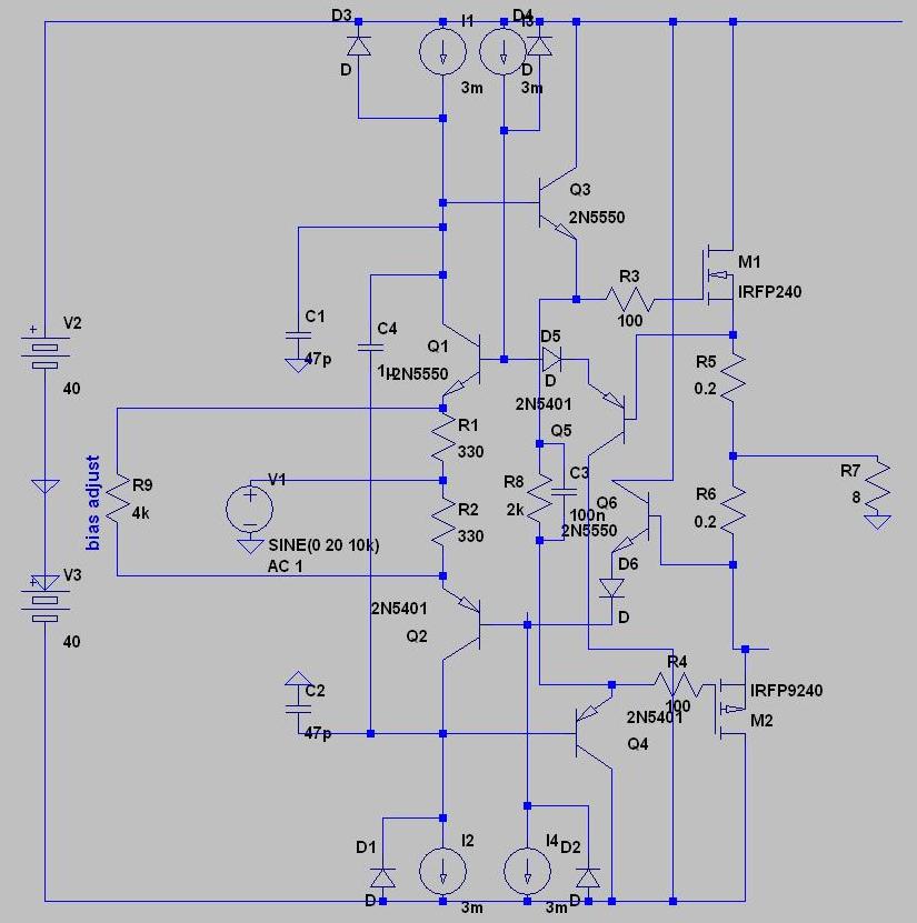

2N5771 and 2N5769 SPICE models, improved.
I found the current LTSpice models for the 2N5771/5769 to be very bad.
I corrected them to the best of my ability, these should be more accurate.
Beta begins to roll off at 2mA, which will be more accurate in VAS simulations.
Anyone is free to reality-check them. I borrowed parameters between them, so they're a bit more complimentary than I think can be expected. This is the last of my concerns because if you were using the previous models you might as well have been using completely different transistors.

I think I should revisit post number 65: I did not give this idea enough thought and so I hastily assumed it could not work. This is untrue.
Looking back I realized I used a darlington configuration even with the MOSFETs, which is indeed overkill and wasn't helping stability any.
Here is a more stable idea, which works just as well as the Allison MOSFET version I first posted, but with less output impedance.
- keantoken

sawreyrw said:
keantoken,
I don't agree with the changes you made to the 2N5679. If anything, I would reduce Ise. Is seems a little low on the 2N5771, but don't make Ise quite so large. BTW, these transistors are only rated at 15 volts.
Rick
In the circuits I've posted here, those transistors operate within their voltage limits because Vce can be no greater than the Vbe or Vgs of the drivers and outputs. I am aware of the voltage limits for these transistors, which is why I don't use them so much.
I don't see what is wrong with Ise. The beta arcs at 2ma, just like in the datasheet, and then rolls off. If I understand correctly this parameter only affects Hfe and Vbe vs Ic, and when I check the models on the simulator the Hfe and Vbe curves look fine to me. Can you clarify?
Thanks,
- keantoken

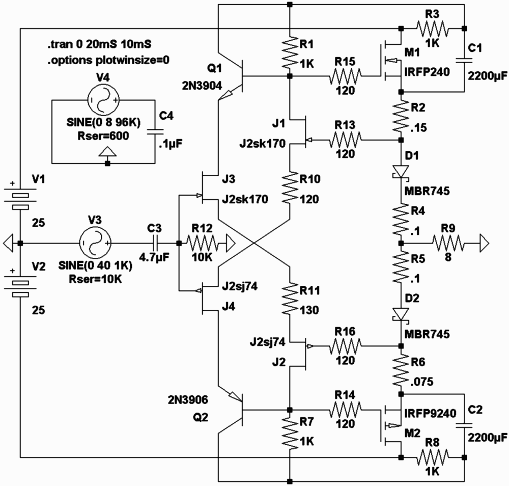

Keantoken
I must say I am impressed on how fast you learn how things work!
To the topic: it seems to me, that this sort of output stage is self biasing the output devices to around 2A (one diode drop divided by 0R33 resistor).
Have you considered JFETs for the input so that it is possible to set lower bias?

Thank you. I am glad I can learn fast too.
Kenpeter has done some experimenting with Jfets to lower bias, schematics of which he has posted in one of my threads as well as here (I think).
I think trying Jfets is a good idea, but I am sure distortion will suffer and stability might be tricky because of the parasitics. Also, since Jfets vary significantly between devices, it may take some matching to get a pair with low output offset. (Note: in my current simulation, it seems matching of Jfets is crucial to the THD performance of the Allison)
I will be experimenting in the simulator.
But, but, I can't build these even if they work well in the simulator, because I don't have the parts. So any real-life testing will have to be done by someone else, at least until I have a pretty good stash of my preferred parts.
- keantoken
Surely you know someone who drives through Dallas regularly?
I can fix you up a bucket of parts suitable to your purpose.
Comparator VCE might never exceed the base threshold of the
next BJT in an Allison. But VGS-on if using a MOSFET, may need
a Zenier. If the amp is clipping, the comparator will try to swing
to the far limit of available bootstrap.

I might know someone, not sure. I know someone who drives to the local TI plant every day, and sometimes goes to fry's.
I wonder if a simple resistor would work to provide the voltage drop instead of a zener? I will test in the sim.
- keantoken
Was this the one?
Since its about impossible that N and P Jfets will ever be exact
compliments. But you can get a matched pair N's, and matched
pair Ps. Put them in series, source to source. You now have two
matching quasi-comps that can be used to detect thresholds of
either polarity. And the resistors in the middle can trim out any
remaining difference.
Other types of junctions with fixed drop: Germanium, Schottky,
LED may also let you predictably trim your quiescent offsets to
something other than a multiple of a silicon emitter. You never
know the exact threshold of a JFET till you hold it in your hand
and measure it.
