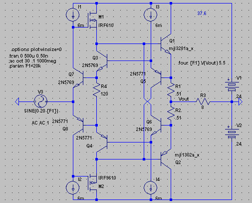

I've been playing with something similar. Emitter coupled
base followers with two emitter voltage offset between.
Backwards looking error correction.... Etc Etc...
I've been calling the topology a "Forklift".
Coping with some of challenges regarding input impedance
across the full audio frequency. The "Allison" transistor is
the top end of a cascode, The input signal is the lower
end of that same cascode. Any current change needed
to drive the next device will have to be conducted by the
input emitter(s). It can't come from the CSS, where else
is the necessary current delta gonna come from?
So buffers are needed. Matters little if these come before
the emitter junctions or after. As long as the input isn't
directly driving the output devices (through the emitter)...
Not as you see in my oversimplified drawing below.
My inspiration originated with Nelson's "Aleph", not with
Allison. But seems to have devolved along similar lines...
This was an early version of the concept before buffers
complicated it. And using bootstraps rather than CCS....
.ASC files for this schematic and later versions can be
found over in my thread "Possible improvements for
Aleph" in the Pass Labs section of the forum.

What happens if you move your "rush" transistors Q35 Q36
up an emitter, base reference the emitters of Q31 Q32.
Does this added .66V collector working voltage seen at all
four corners of the diamond help?

Neat.
I wonder how the bootstraps affect Allison stability.
If you want to experiment, you could try connecting R2 between the Allison emitters and the output. At maximum current output, the voltage between these two points is around 700mV. 2A into 8ohms is 16V. So 16.7/47k=355uA. In order to have the same input impedance, you would need to use a 1.9k resistor. This idea seems interesting to me. I think that the input impedance would be affected by the load impedance (although it already is to an extent), and any load changes would show up in the input impedance proportionally, since the load current will determine the voltage across R2. At first this seems like it doesn't have any benefits, but I wonder what advantages it has?
- keantoken
- keantoken
kenpeter said:What happens if you move your "rush" transistors Q35 Q36
I am not sure but I think I know what you mean.
Q35 and Q36 are cascodes. I have tried using them like you say, and I have also tried referencing them from the bases of Q16 and Q29 but the present arrangement works the best distortion-wise and is the most stable.
- keantoken

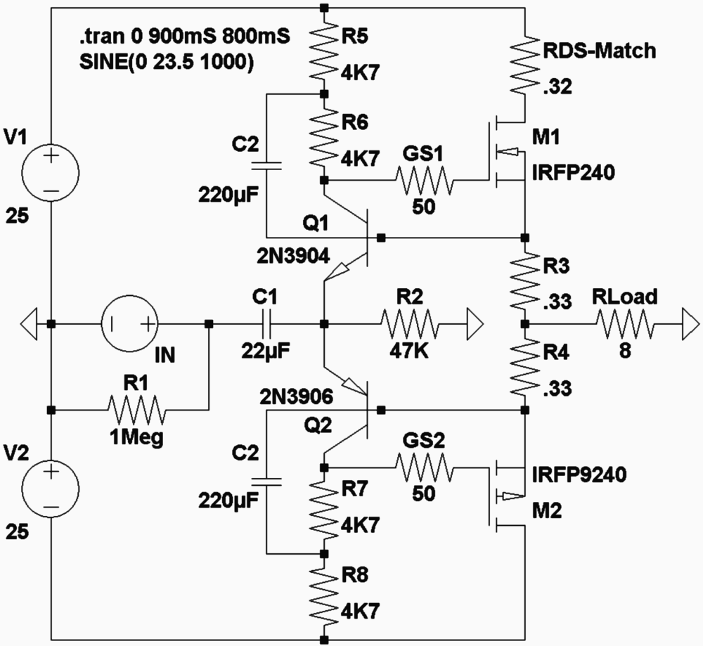

For those of you still watching this, one more variation on the Allison:
Here I worked on the original design in order to overcome the limits of the more complex versions regarding distortion.
There is one big error here:
The drivers should have at least a diode in series with their emitters. This is so that the Allison has enough voltage drop across its B-C junction to function properly. This version is perfect for Darlington outputs. It also gives lower distortion. But it was very hard to get stable even in the simulator. /:
Just for your interest.
- keantoken

You just need to Schade back the error correction gains.
That they might have well defined voltage gain limits
independent of weather the load is cooperating or not,
parasitic phase shifts, etc....
Don't leave them entirely open loop, or they overcorrect.
Possibly not in real life, but definitely in the simulator.
Better for avoiding oscillation and those weird unexplainable
LTspice moments... Better behaved in clipping recovery and
class AB if you choose to bias that low.

What do you mean be "schade"? 🙂 If I knew what that word meant I could understand the rest of your paragraph.

Another development
Someone suggested I do some sort of nested error correction type thing, and I think this is the realization of that idea.
This simple circuit is amazing.
Simulated distortion figures are (with a perfect input voltage source):
THD @ 100Hz, 37.6V pk-pk into 8 ohms = .000013%
THD @ 1KHz, 37.6V pk-pk into 8 ohms = .000013%
THD @ 20KHz, 37.6V pk-pk into 8 ohms = .000022%
THD @ 100KHz, 37.6V pk-pk into 8 ohms = .000125%
Implications:
The circuit has inherently high input impedance, but it is very capacitive. Look at the input impedance curve (note, if the Y scale was logarithmic, it would be a straight downward slanting line):
That is, 3.13megaohms at 1KHz, 313Kohms at 10KHz, and 31.3Kohms at 100KHz. Impedance below 1Hz is about 116Megaohms.
Input impedance linearity test:
These simulations are performed with a 10k input impedance to test the linearity of the Allison-based circuit with high source impedances.
THD @ 100Hz, 37.6V pk-pk into 8 ohms = .000593%
THD @ 1KHz, 37.6V pk-pk into 8 ohms = .003409%
THD @ 20KHz, 37.6V pk-pk into 8 ohms = .068963%
THD @ 100KHz, 37.6V pk-pk into 8 ohms = .386746%
So all in all, this circuit is the best so far of my Allison variants - if you have a good source. Without a good source, THD will be strongly correlated with frequency. I also suspect this one is very stable - moreso than any other of my variations, although I haven't tested this.
- keantoken

Yeah, but the diamond is now 4 full silicon emitter drops wide....
Half an ohm output impedance.... Full ohm or more if biased AB...
This just might be Germanium comparator territory...
Still need .models with the correct VBE.
Or somehow throw an extra silicon emitter into closing the diamond.
