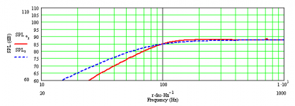

so, with the encloser determined by the design and the size of the driver at ~4 liter, and a small BR tube I had lying around as starting points I mod-d the BR sheet to have stuffing in the port and increased the amount of stuffing until the response was flat
this is with 5 lb/ft³ stuff dens in the port, which means I'll have to cram ~20 grams of BAF into a 1" 9cm long port 🙄
the small ripple just above 700Hz is from a port resonance there, but since I will place the port at the rear I do not worry too much

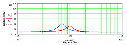

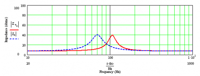

the effect of the stuffing is best seen in the impedance plots, here the one of the damped port enclosure
