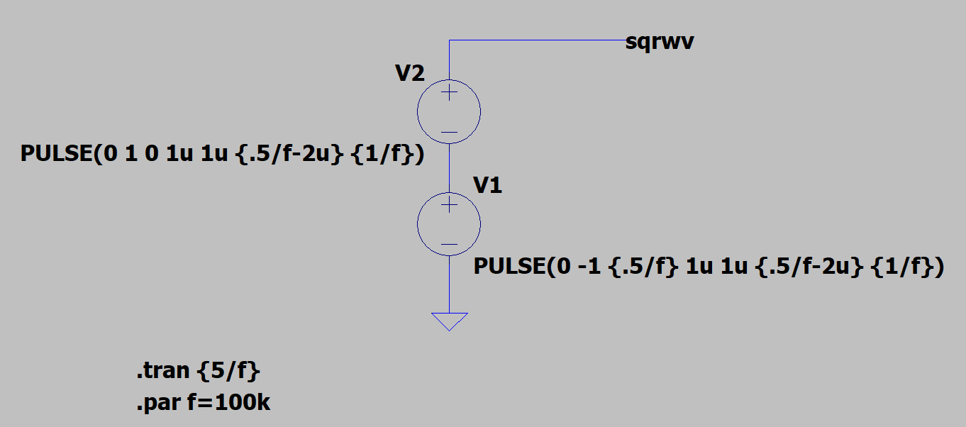

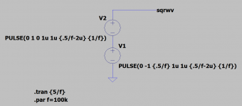

A trickier problem is simulating a square wave input without messing up initial conditions, because the AC square wave is never zero volts (@zero time). I see a lot of simulations that short the coupling caps for this reason. Any better solutions?
Come to think of it, I have done that too. But at the time I was interested in startup transients and latch-up issues.
Set two square wave sources in opposition:
v1 middle top PULSE 0 5 0 1u 1u 499u 1m
v2 middle bot PULSE 0 -5 0 1u 1u 499u 1m
This gives a 1 kHz, 10 Vpp square wave that begins and ends each period at 0 V.
That way, the initial voltage is zero instead of -10, letting your coupling cap have the correct initial value. You can also set a .ic, but that can be a bit fussy.

Sorry if might have a slow day but I can´t follow why you´d want to use a pulse and where are the sine waves coming from that you´re showing? Where´s V(out) in your schematic?
I always use sine waves for ripple sims as that´s what´s coming out of the transformer, right?
