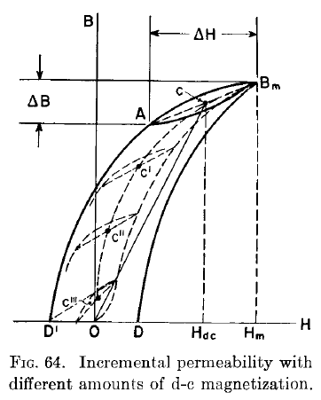

50AE, my view is that the BH curve shape for a swinging choke is not the commonly seen rectangular shaped hysteresis curve (as partly seen in post #9) showing a mainly linear central section, and then a clear knee section as the BH loci enters what is commonly identified as its saturation region of operation. I see the BH hysteresis curve as continuously varying from the origin out to extreme saturation region, and that the voltage induced operating loop/ellipse would not extend from near the origin and out into the saturation region, but rather be a more minor loop/ellipse in shape, although still a significantly sized loop/ellipse (compared to say in a CLC filter where the applied voltage is down at the volts or low tens of volts level). The most illustrative diagram I could find is attached from 1955 Lee 'Electronic transformers and circuits' book.
As such, operation at low DC current (but more than critical current level) may be illustrated by loop CII, and the loop does not extend into the 'saturation' region of the BH curve. For DC current below critical level, part of the loop is constrained by rectifier commutation to not extend into the lower two quadrants of BH plot, but does have some portion of the loop influencing the choke waveform.
I'd suggest the ac voltage across a swinging choke is fairly constant in magnitude, and doesn't significantly diminish for higher (but normal) dc current levels into a load. The attached diagram illustrates that situation, where it is the changing incremental inductance (slope of the loop) that is varying for larger DC load current conditions.

Hi Trobbins,
Thanks for attaching this. We can observe the variation in slope (permeability) vs different DC excitation levels. But also, the amount of airgapping will affect the final result, such as linearizing the BH curve. Also, I have a variety of core materials around to play with, having different shapes of BH curves.
I haven't had the chance to inspect any confirmed vintage swinging chokes for how they approached their 'gapping'. References generally describe the gap design for swinging chokes as being intentionally narrower than for a typical choke design.
Only some choke catalogs presented data specifically for choke-input filter applications, and specifically with a 'swinging' tag, and would show two sets of inductance @ dc current ratings, where the largest dc current value is the rated (max) current for the choke, and the other value is typically 10% to 25% of rated. However, those stated inductances are typically for 10Vac, and so need to be adjusted for the application’s level of Vac, which was significantly higher.
