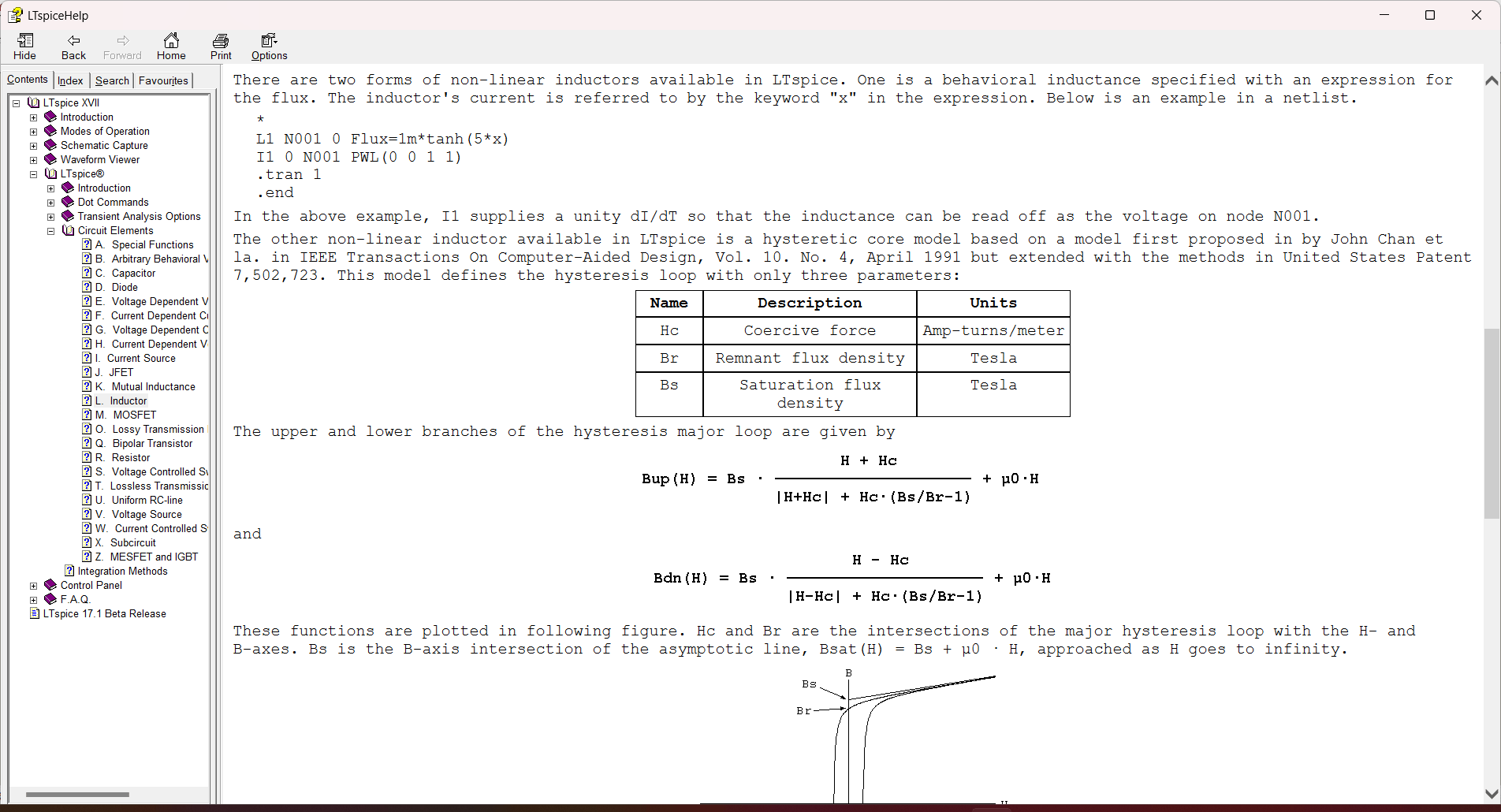

Is it possible to model a magnetic amplifier inductor in LTspice? And then you need to find someone to make it. . .
