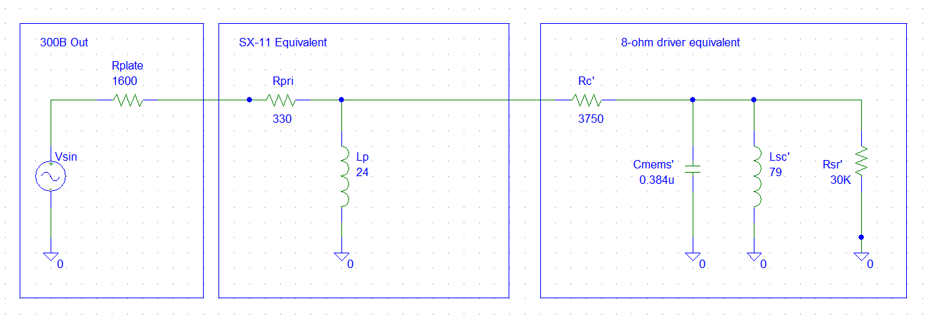

Finally the right circuit!fa meno il fenomeno
Fai meno simulazioni e studia
Engl: less simulation more study
The Rp of 300B is around 800 ohm not 1600!!!
Walter
I don't know what he is simulating there but with simple math just looking at the circuit , at 10Hz and 24H primay RL to ground is about 1500 ohm , almost like Rp , so roughly only half voltage will get through the voltage divider , 6dB loss already without other loses
Rp should be a valid DC operating point , how much voltage across the tube and current for 800ohm ? That is just datasheet value
For 300V and 60mA the Rp is 5K ... so the real result is much worse , the transformer inductance 24H could be enough but is not very good

I still don't get why using Thevenin or Norton equivalent circuit should give any difference.. and in fact the result of the simulation is the same.
You might be a bit of a grumpy old dude who doesn't like simulations, but that's how the world goes nowadays.
For Rp I used 800 ohm in my first simulation, but you told me to use the model from the other user who had Rp=1700 Ohm in his simulation, so I trusted you can changed Rp
BTW, I have a master degree in EE and I manage a team or 15 engineers. I new to tube amplifications, but I definitely know the basics of electronics very well.
Because for AC and impedances is not correct , the Rp that you only moved in parallel with the current source becames a impedance
The Rp of 300B with 300 vdc and 60 mA is 740 ohm as WE data sheetI don't know what he is simulating there but with simple math just looking at the circuit , at 10Hz and 24H primay RL to ground is about 1500 ohm , almost like Rp , so roughly only half voltage will get through the voltage divider , 6dB loss already without other loses
With some other brand something vary

You changed Rplate and Rsr values.@Depanatoru
If I replace the current generator with a voltage generator, the result is the same. I might be omitting a high pass component in the model, I am not sure..

That affects the damping factor, hence the increase of the peaking.
You should understand that Rp is not a fixed or real number , the internal resistance varies from infinity when the tube is in cutoff to a low value with zero bias .![]()

One of the difficulties I see here, to have an accurate simulation, is that the Zload seen by the tube changes as the frequency change, and by changing Zload also Rp changes.
At f>>fs, Zspeaker << ZLp, so the tube sees Zload = Zspeaker
At f = fs, Zspeaker >> ZLp, so we can approximate Zload = ZLp.
At f < fs, both Zspeaker and ZLp are low and Rpri contribution starts being relevant.
I think an approach could be to estimate Zload for a few given frequencies (e.g. 10, 20, 40, 80 Hz) and from there determine Rp.
Once Rp and Zload are known, the attenuation can be also determined.

Rplate should be independent of Zload. Sure, it's dynamic, but constant in parameters.
The loadline slope changes depending of the reflected load, vs Rp.
You get different Rload/Rp ratios, which practically determine the DF at the specific frequency @ impedance.
Yes, you can pretty much observe how the loading nature shifts. And all resistance values play a role. Basically the DF.

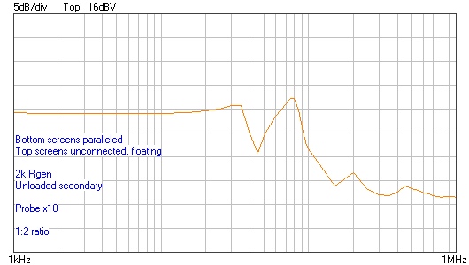

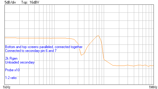

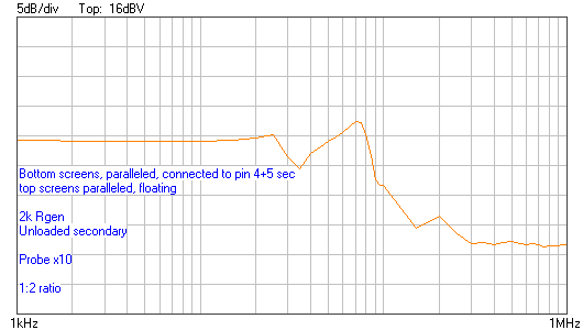

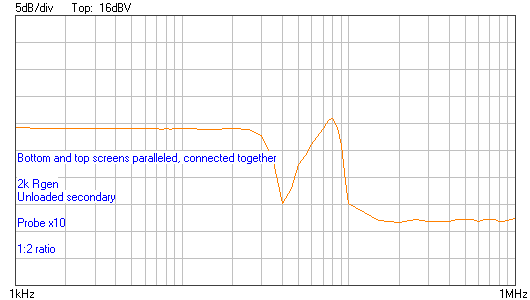

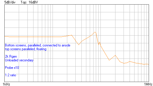

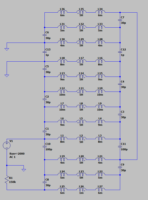

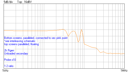

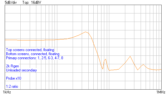

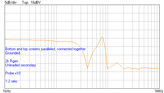

Check this recent experiment. An 1:2 SE IT transformer which I left on on storage on the shelves, because frequency response is a bit unacceptable. Same transformer, same interleaving, but 2 pairs of electrostatic screens are present between P/S layers. You can observe that there is headroom for resonance tweaking, depending on the way you connect them. Note that if using screening, every type of transformers requires different screen connections for optimal results. In some applications, I've dumped part of the secondary signal (from a tap) into a screen to smooth out resonances.
P/S The measurement with a different primary connection is a good example of capacitance dumping from primary/secondary to primary/primary. Notice the disappearance of the dip resonance, but increased Q factor of peaking resonance and lowered frequency. A series resonance is more easily tamed by loading or higher driving impedance.
Bottom and top screens paralleled, unloaded sec, 2kRgen.png1.8 KB · Views: 54
Bottom and top screens paralleled, connected together, unloaded sec, 2kRgen.png1.8 KB · Views: 57
Bottom and top screens paralleled, connected together, pin 6+7, unloaded sec, 2kRgen.png2 KB · Views: 53
Bottom and top screens paralleled, connected together, grounded, unloaded sec, 2kRgen.png2 KB · Views: 55

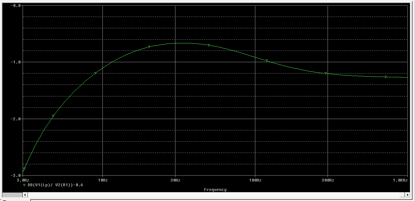

The simulation of @euro21 is with the 45 tube. That is why Rp is 1700 ohm.
To know the cut off at low frequency, compute Req which (Rp + Rdc) in parallel with the nominal load. Rdc is the total winding resistance. So, Rdc is the primary resistance plus the secondary resistance multiplied by the square turn ratio. Then f(-3db) is simply 2*pi*L/Req.
Referring to the data in @euro21's circuit for Rdc and L, f(-3db) is just over 10Hz with the 45 (Rp=1700R) and just over 7Hz with 300B (Rp=800R).
This is a good approximation and simulation will not tell anything significantly different, unless REAL parameters are used. In fact, @euro21's simulation says 9.6Hz for the 45. Plate resistance and fixed inductance are already approximations. What is the point of simulating something so simple to estimate?
@45 The goal of my simulation is to take into account of the loudspeaker impedance variation with the frequency. The impedance of the loudspeaker driver influences the frequency response of the output stage, and assuming the loudspeaker driver is a 8 Ohm resistor across the whole frequency spectrum is not accurate.
