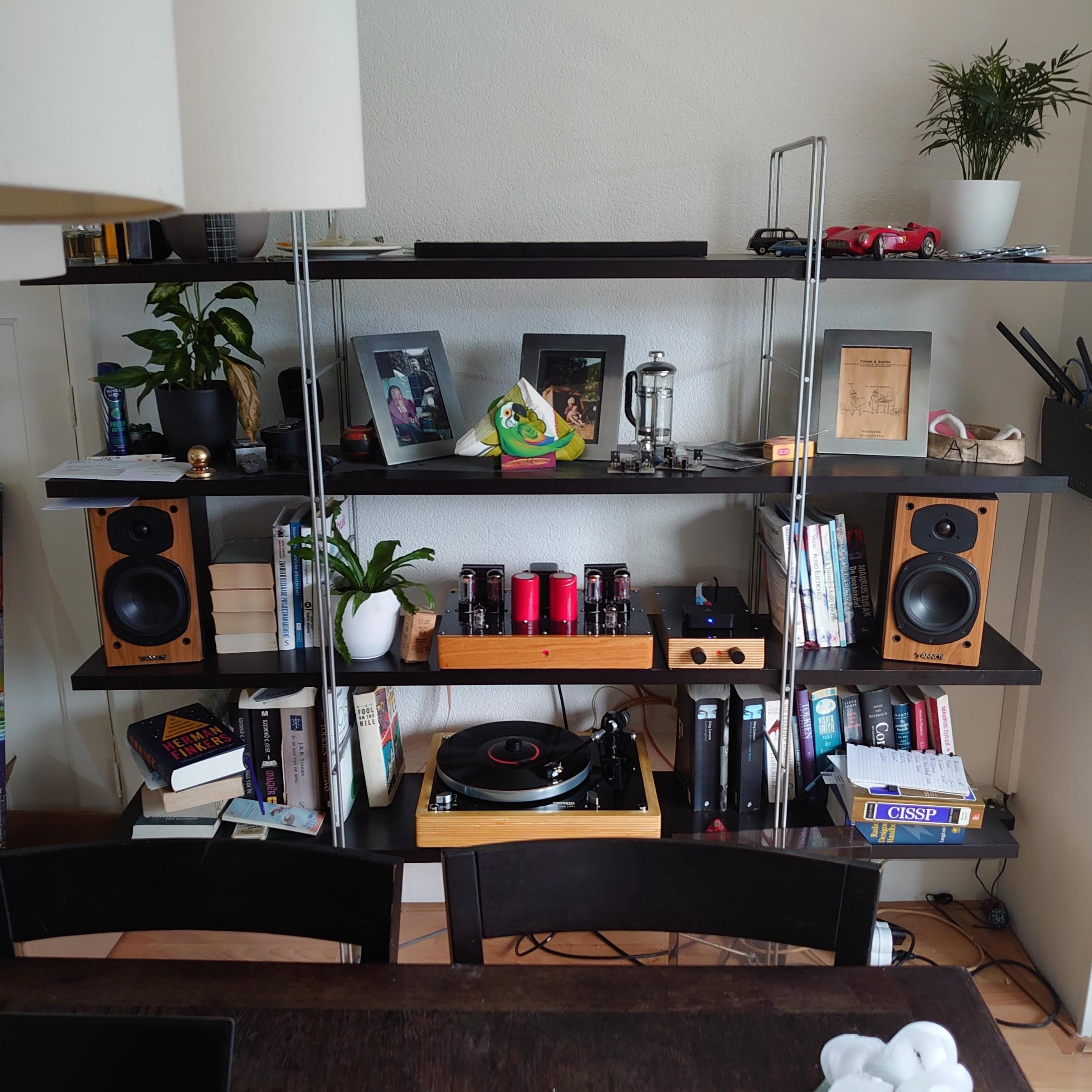

Thanks, that's the sort of answer i was looking for. PSU is a 36V Switch mode wallwart, single clcrc filter to 32V, one lm7824 on top of a bypassed led and 47uF cap. Last a rc stage 10R/1000uF. per channel.
I know, heresy but funds are tight and i had to use what i had. The 10R should isolate the 1000uF enough i think and that's an elna silmic II. the b1 uses a single lm317, bypassed devider.

Anyway i will try and see. Probably later this week. For now it's spinning records and quite nicely. I like it! this was build for the second setup in the living room. It is already better than expected.

Upped R3 with 1k5 to 48k2. Now Ella has got a body and the Bass/drum has lost that hollow aspect. it's still light, nimble and has a good detailed, dry quality on top. Before going further i want to try it in the main setup.

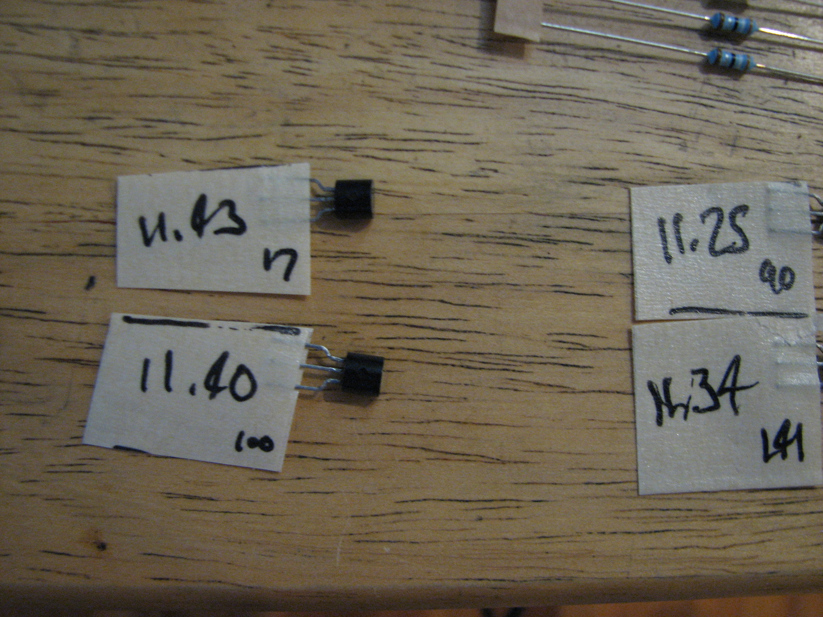

With the matched quad, (2SK369BL) I assume the two pairs should be closest numbers together on the same board?
I have paired them as in this photo:
1st board: 11.43 & 11.40
2nd board: 11.25 & 11.34 ?
I think the top left one is 11.43?

Joined 2003
They are all close, but I didn't know if matched by position, as you pointed out, or by the board. Looks like position, Q1 to Q1, etc.
I will wait for Salas for last advice, probably your answer resolved it, (close enough to not matter) but I am prone to trouble with these things!
