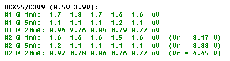

Back to D1, I am having trouble finding the correct zenners.
I built a zener diode voltage regulator circuit so I could match the zeners and the 3.9v zeners only measures 3.5 volts.
The circuit I am using is this: http://www.reuk.co.uk/Zener-Diode-Voltage-Regulator.htm
Am I doing something wrong ?
I get the following readings with several zeners:
13v measures 13.1v
15v measures 15.1v
4.7v measures 4v
3v measures 2.5v
3.3v measures 2.8v
2.7v measures 2.5v
3.9v measures 3.5v (Two of those measure 6.9v) 😕

at what current are you testing each of the Zeners?
If the test current varies then the measured voltage will vary.
If the test current drops dissipation below 10% of maximum then the voltage varies a lot.

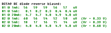

Low voltage zeners take a lot of current to make them wake up - one of their disadvantages. This is reflected in the test current cited in their data sheets. A string of yellow-green LEDs might work better, requiring only 10mA or so. Each LED will drop almost exactly 2V at that bias current.

Low voltage zeners need a huge amount of current to wake them up - at least 20ma - their "knees" are very soft and sloppy. LEDs have much lower incremental impedance. As an alternative to using LEDs, try the reverse base-emitter junction of a transistor like the 2N3904 - it yields an extremely sharp zener of 7.5-8V, and it only requires a ma or two.
Thank you wrenchone
Does the 2N3904 provide less noise than the equivalent led string ?

Doesn't our 8V2 stay steady with the about 10mA IDSS CCS? Works till now. Why not others? You will tell after putting them in. The goal is to listen if some noise was escaping the bypass or not, bcs unfortunately our needed bias coincides with noisy single Zener nominal voltages. If it is escaping enough, maybe you will get more analysis by a simple move. If not, well we will know not to bother.😉
