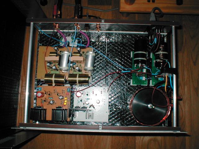

Just rearranged the internal layout of the pcb´s in the Riaa and this further reduced the hum (now inaudible at normal listening levels).

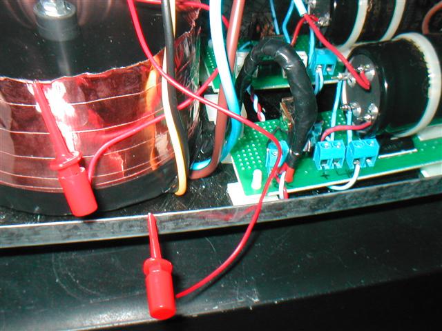

Coating the TX with copper tape helped but the major improvement came from rotating the TX until hum is minimum... in this position grounding the TX shield seems to produce no results.
Shielding is effective but the real improvements came from repositioning of the TX.
Now I am ready to test D1 mod.
Ricardo
I believe that now you are practically low enough in hum field from TX. In general, the recommendation for future builders is to use separate box for including a big toroid, rectification and main filter capacitors I guess. Me I use a small 50VA toroid mounted vertically and completely opposite to inputs and Riaa board if in same box. This keeps the 50Hz hum field really low, can't hear it, but I can still see a little in FFT. Shielded coax for input and output is a must if the TX is in the same box. OK waiting for your news about D1 Vref made with Leds.

new layout:

are the layers of copper foil tape insulated from each other?
Try connecting all the layers together with a soldered on shorting wire, maybe three or four shorting wires spread around the circumference.
Now that the transformer is located in the optimum position, try rotating it around it's mounting bolt to see if you can measure a variation in the interference that it creates.
Thank you AndrewT
I have done everything you suggested... the foil is glued with conductive tape and I found the best low hum by rotating the TX.
Also I rose the TX by 4 cm and now It is in the best position ever... (it could be better but I would need a hood scoop or some kind of high rise lid 😀 )
I must refer that after reaching best positioning, the shielding seems redundant. (I get no hum increase by unearthing the shield in this position !)
The benefits from reducing hum are outstanding... I can now hear much more detail and the stereo image is wider with improved focus.
This riaa+shunt design really benefits from a hum free psu.... maybe in the future I will build an external enclosure.
Ricardo
