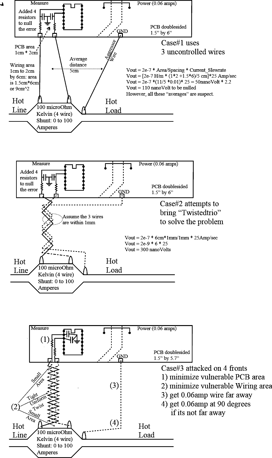

Some years back, a schematic appeared on my desk with question "What purpose have these 4 resistors" about a high-volume signal measurement application. We knew the customer would not install 4 resistors frivolously. Knowing the application, I soon computed the 4 resistors were injecting a nulling voltage of approximately 80 nanoVolts (or was it 300 nanoVolts?). The FieldApps Engr emphasized the measurements needed a zero-point calibration that was stable, or the customer could not achieve certification.
After a couple days, I realized the magnetic field of the 0.06 amp power supply current was injecting a small, computable, predictable error.
Hence the tool Signal Chain Explorer honors this discovery, with the HFI database entry "Power Meter Null Error".

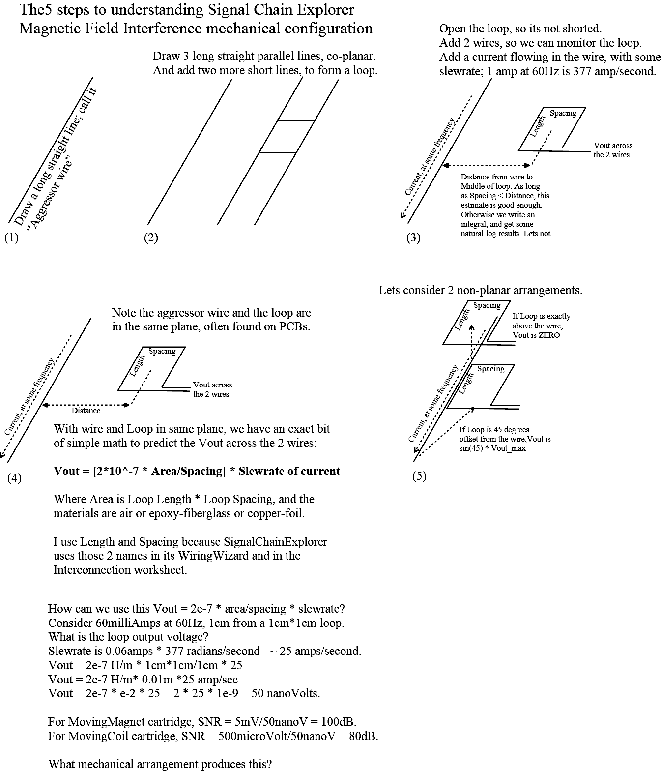

As before, the simply math is
Vout = 2e-7 Henry/meter * (Area/Distance) * Current_Slewrate
Attachment#1 presents the 3 examples. You'll note the effort in Ex#2 to rescue the product by using 3-wire "twisted-pair". Unfortunately that effort brings the AggressorWire with its 60milliAmp current only 1mm away from our Loop.
Attachment#2 details the 3_dimensional topology of the Signal Chain Explorer magnetic field (HFI) interference model. We assume the Wire and the Loop are in the same plane, such on PCBs. But moderately non-planar topologies can be easily approximated using the above math, just to get an idea of interference severity.

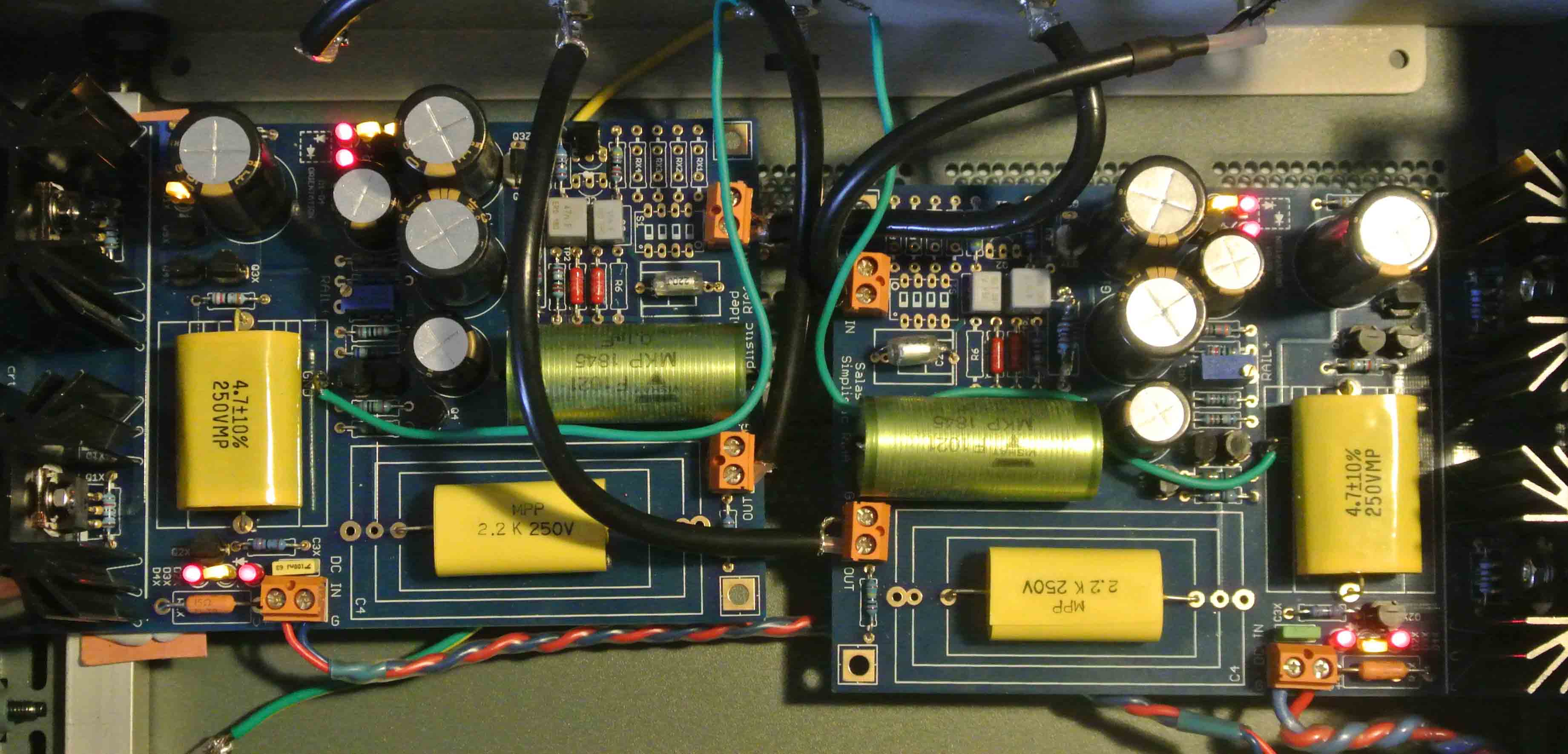

Good caps use is just about not holding it back. Its positive you unlocked some further richness. Did they fit well the C3 PCB room? Taken any photo? Circuitry matters most as always. You had a tube phono sometime also?
Tight squeeze but ok for fit. I also removed the surplus 1M resistor in R6.
While waiting for the group buy to eventuate and be delivered I built the phono preamp design from Merlin Blencowe's new book. This design uses PC97 and 12AU7 for each side and I cobbled it together on an old chassis and built it using locally sourced (cheap) components other than the valves which I had to get from Britain as PC97s were never used in any Australian made electronics as far as I could see. For all that this preamp does work extremely well and is very quiet. I think that the secret of its design is in the really good power supply approach taken by Blencowe, just as it is in your design. The Salas is definitely superior. I plan to duplicate the Blencowe using better componentry in the fullness of time to see if valves can match solid state.

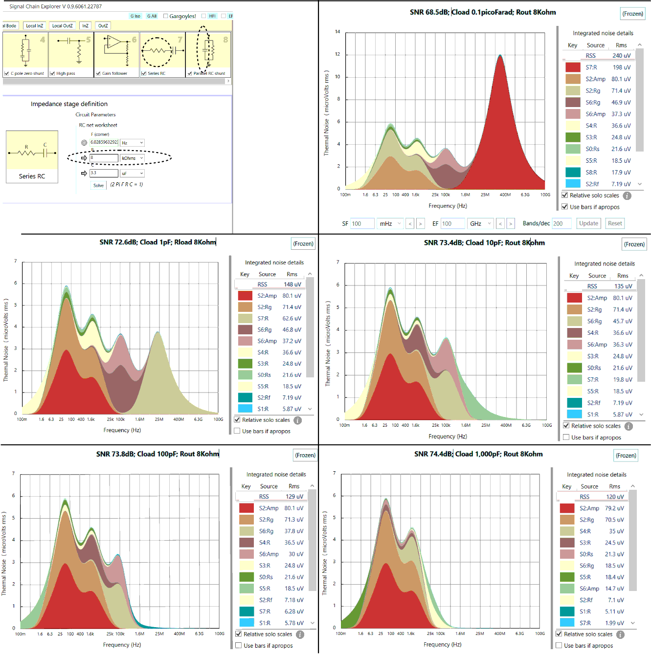

After modifying the Salas model to reflect the 2nd Rdrain (8Kohm) that defines Rout, and adding a final shunting capacitor Cload to model Cable capacity, I tried various Cload in Signal Chain Explorer.
From 0.1pF (very difficult to reach that low a value), to 1000pF, the Signal Noise Ratio varies 6dB, because low values of Cload permit a wide noise bandwidth.
Should we view this random noise as spikes, faster than the Power Amplifier can fully respond, then these spikes cause tiny Impulse Response waveforms to appear on the loudspeaker. Thus noise rolloff is needed.
I found a 400pF Cload [ Ccable + some Cdiscrete ] acting against Rout of 8Kohm, produced 50KHz bandwidth which should allow Moving Coil accuracy. And MM should also be fine with that output bandwidth?
800pF would produce 25KHz bandwidth.
