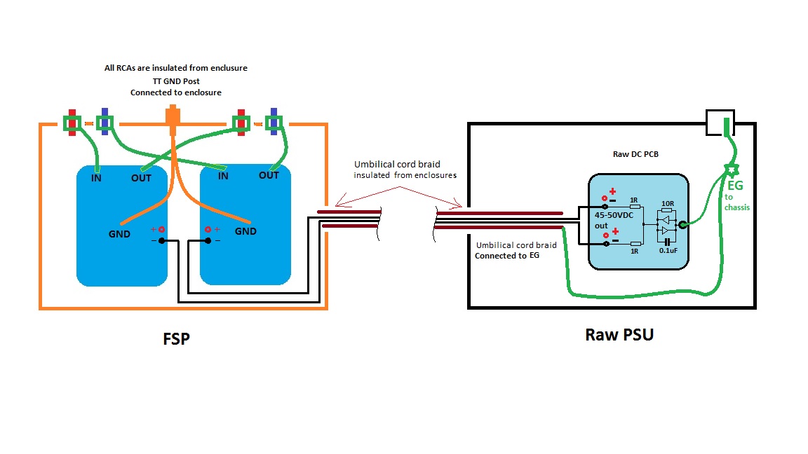

I though it will be beneficial to all who just starting to build it (even to myself) to show GND diagram for FSP. There are no signal connections shown. Just returns, "-" and GND. Nick, please correct me if I'm wrong.
Alex, this diagram looks good. Except it misses the +red lines in the umbilical. Implied of course but when there is a practical wiring diagram available, people tend to just copy it exactly in the build.
I did not added "+" in order not to load this diagram with too much details. I assumed that positive line is easy to connect and no places for errors. Good point and for all guys: this is just a one way which worked for me and other ways are also available/tested/worked for other guys.

I guess I will have enhance the original manual with few words about the raw board since it wasn't available back then, but the already shown generic PSU that it carries became popular, some experiences about usual Leds VF and Rail+, behavior of 36V transformers & a usual Rdlink value, R3x manipulation. Maybe half a page worth of extras in the notes section. I could borrow your nice finished drawing and stick it in the general wiring section as extra so to make things clearer if you are permitting.
