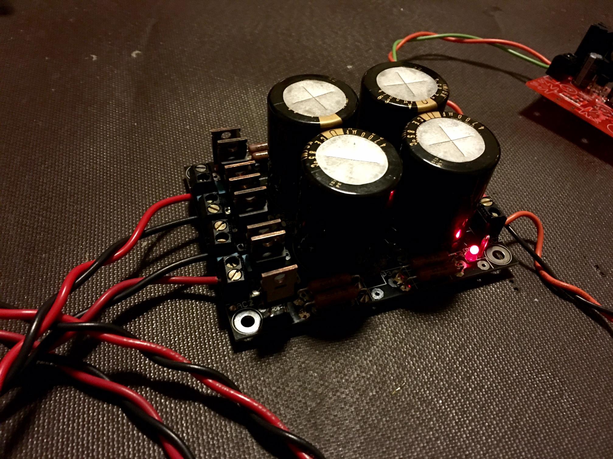

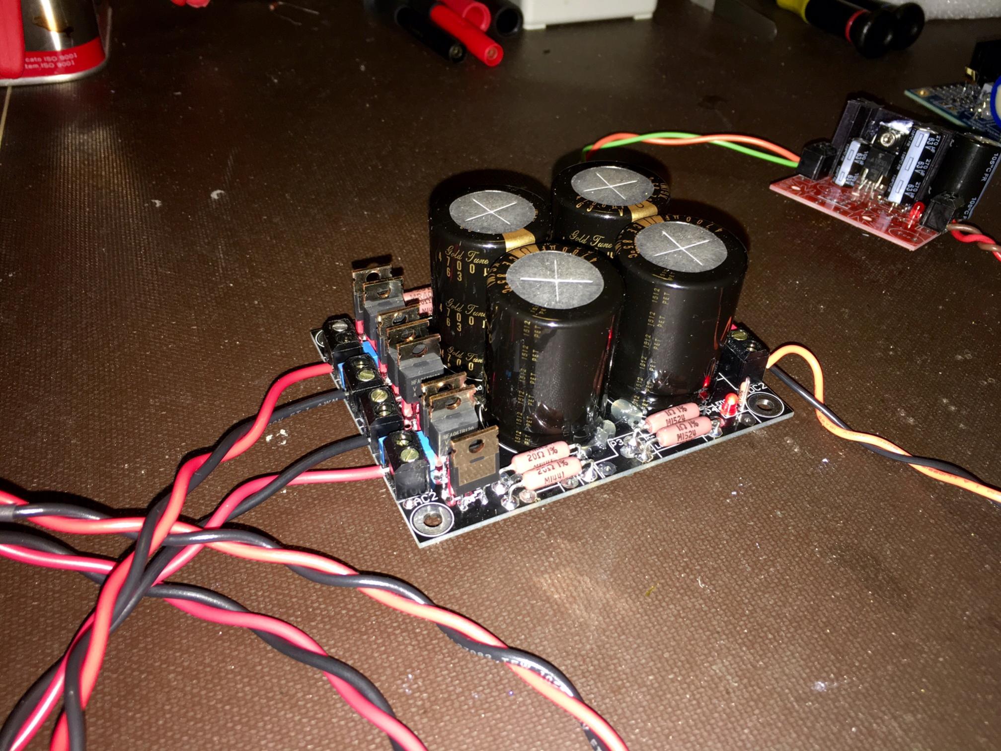

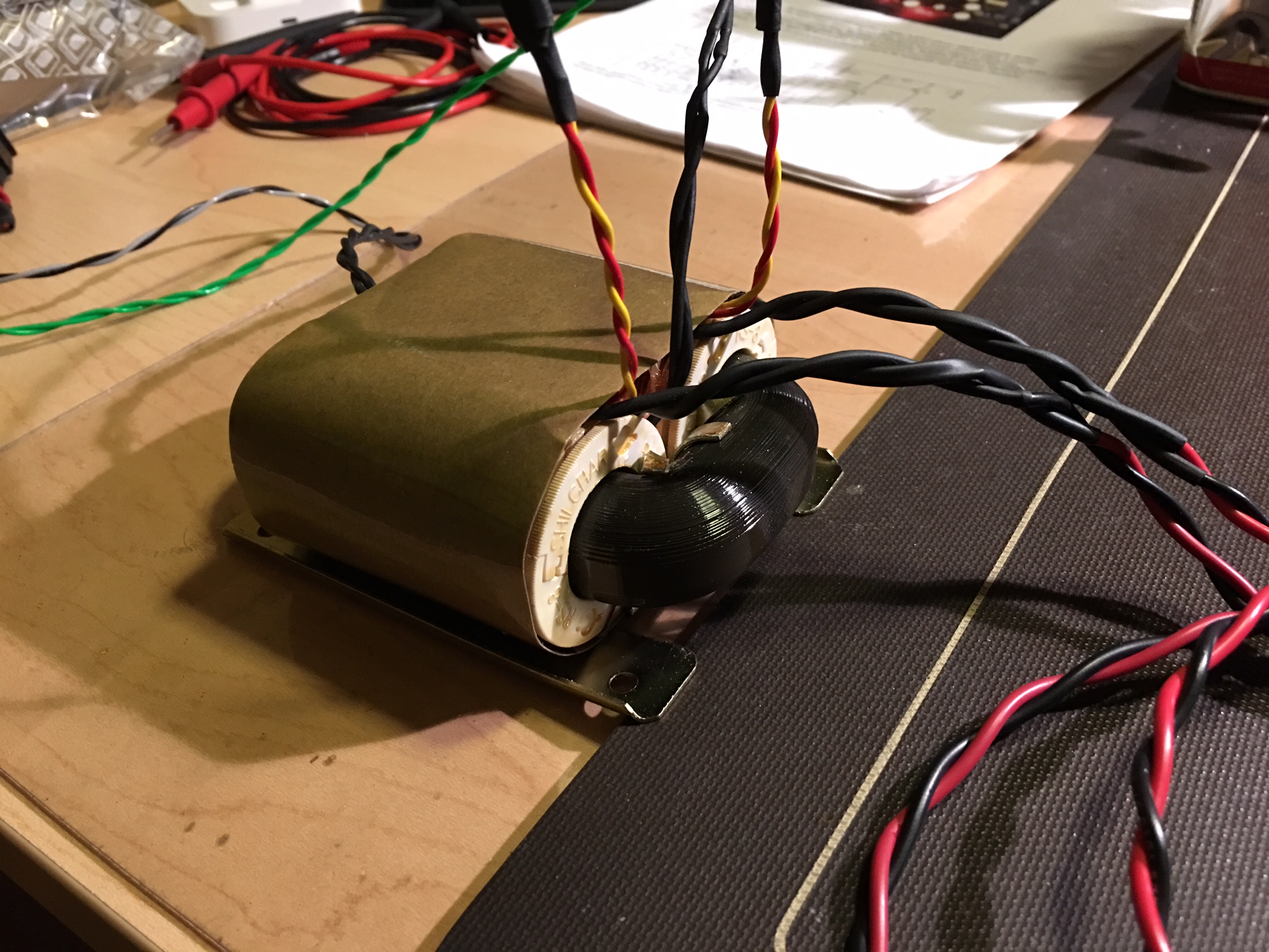

My RAW power supply is built. It's giving me 43vDC supply to the shunt regs.
Is it a good idea to build the shunt reg portion of the main boards first, and then test output, or is it ok to populate the whole board in one hit and then power it up?
Step by step building is always the most careful approach but keep in mind that Q6x will share no current to a load yet so its sink will appear double hotter than normal later on. About 3.5W VS 1.75W. It will still hold well for relatively quick testing so to check that the CCS current is about 100mA and the output range varies sufficiently between 30 and 37V by VR2x. In case its not you will need a different value R3x etc.

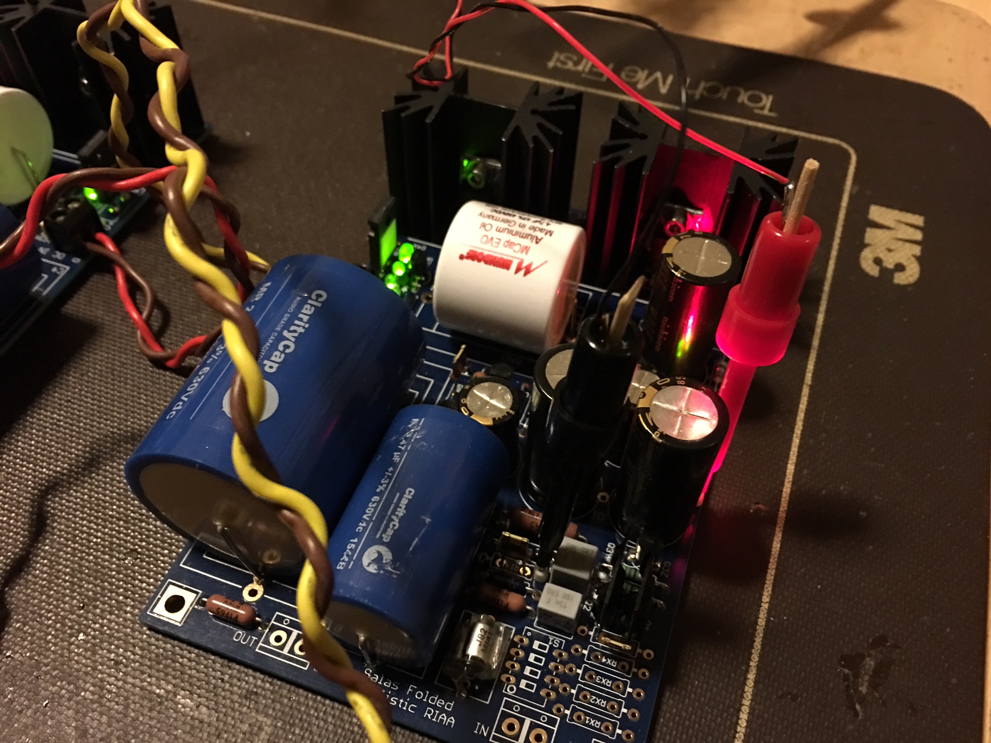

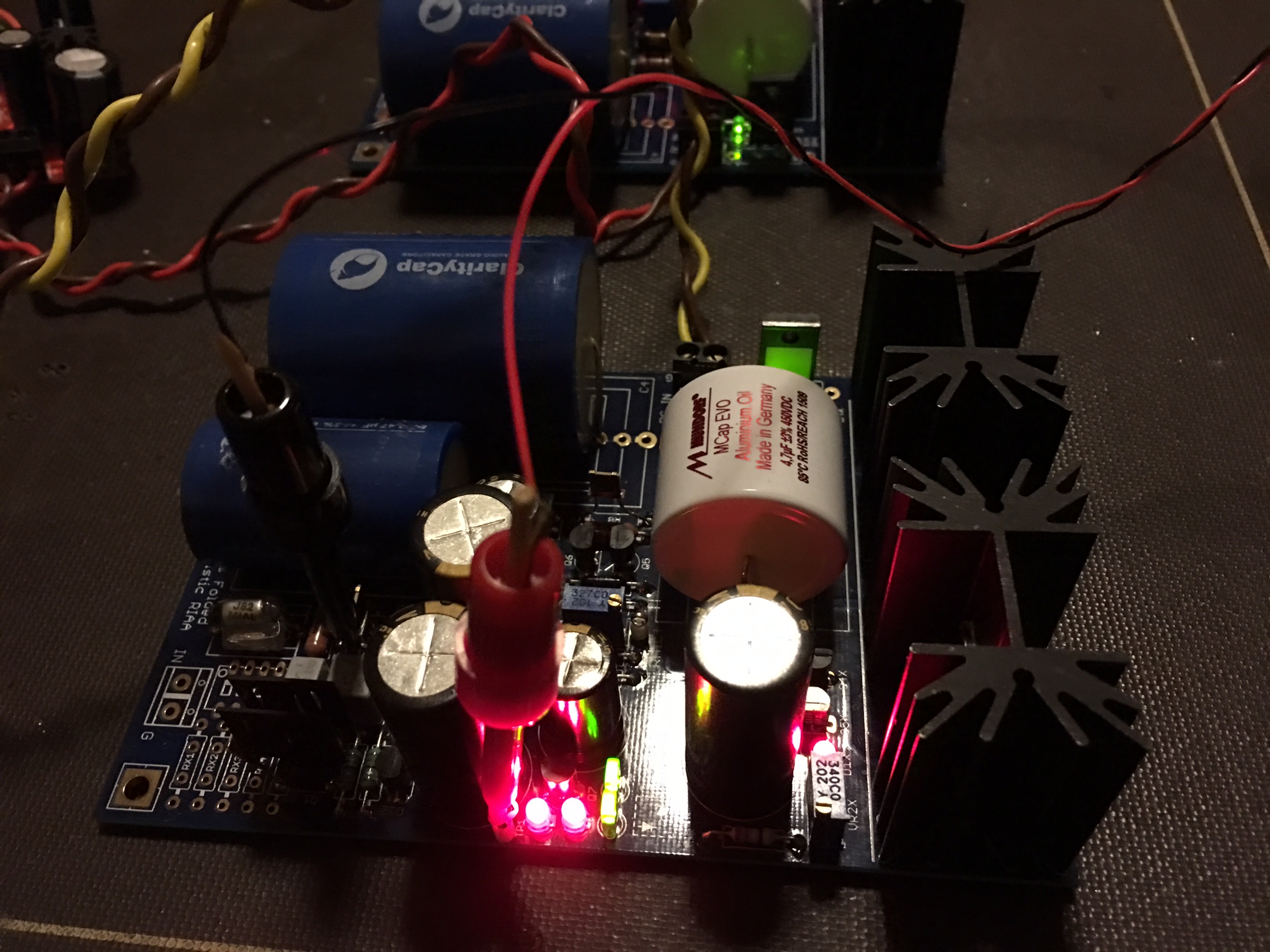

Since "it is not that bad idea" to try to use big PP in addition to C8 (in my case Nichicon KZ 470uF) Ele cap, I'm also willing to try it. I'm finishing my second FSP with significant dedication to the matching and ClarityCaps (C3&C4) instead of Mutdorfs Supreme SiO in my first FSP.
Any advice for Big PP caps? Space limitation is also quite concern and I see ACS has dry Metalized Polypropylene Film Capacitors (80uF 330VAC in Partsconnexion for $14.95).
Is it good enough to try or PP Oil filled is better choice?

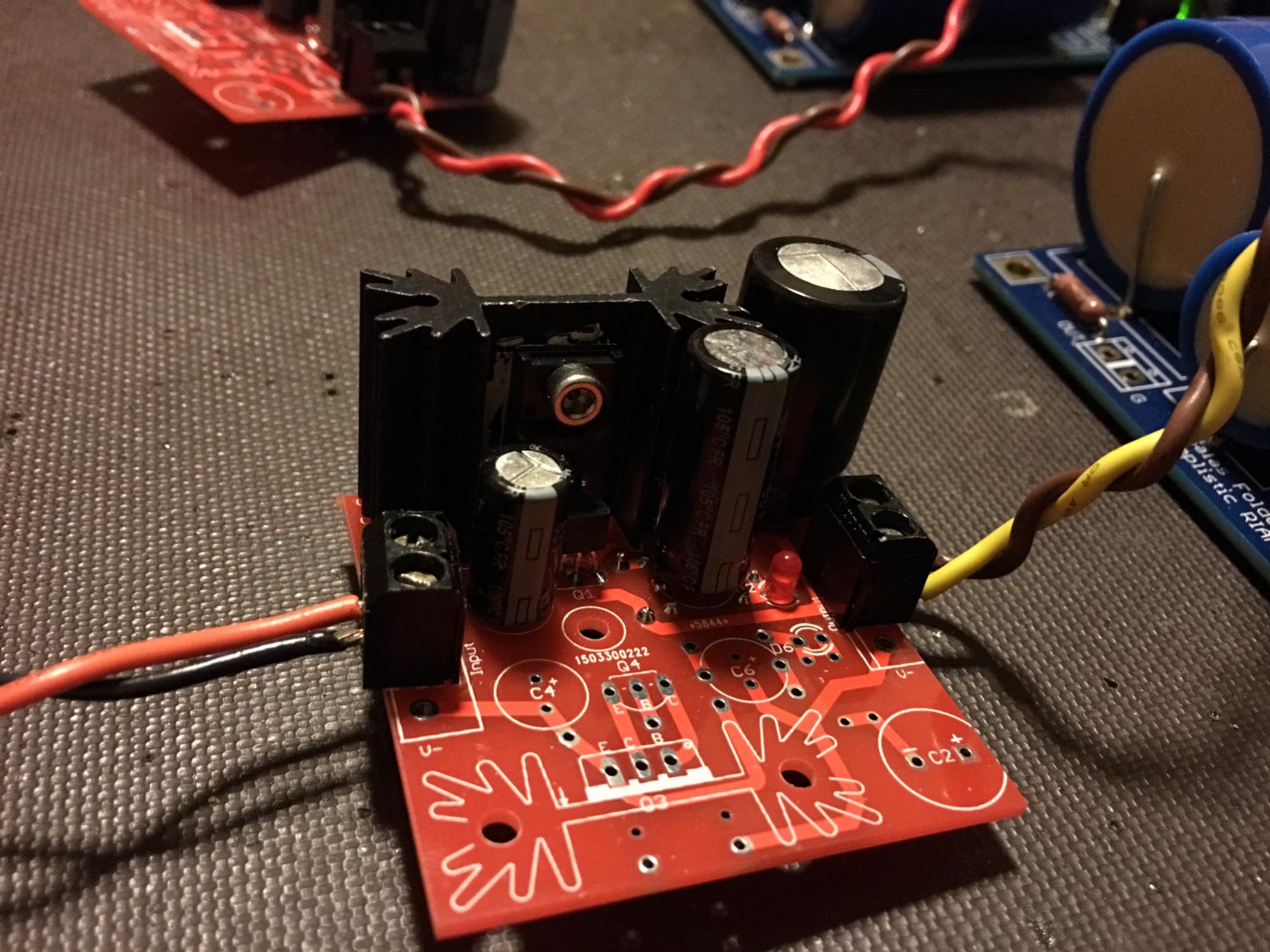

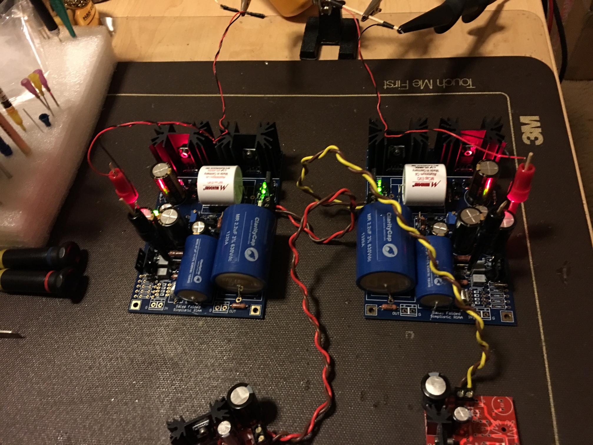

Looks great Alex. What are the red boards? They look like shunt regs, but that doesn't make too much sense to me, as I can see that you're using the onboard Salas regs.
Thank you salas 🙂
P.S. Also check that the originally missing 47 Ohm R8 that was found as 47K and fixed did not accidentally end up as R1 or R14. Disconnect the TT from the L&R phono inputs, don't turn the power on, and measure with the DMM across each input to confirm the expected load resistors values. When all the DIP switch positions are set to OFF it should read 47K. Measuring across R14 it should read 47K too.

Its not bad in general to mix those two types but not that productive in FSP giving rather subtle contentious changes especially when the widening of layout area it takes by projecting routes away from the board can make it prone to picking interference etc. But if you are to tweak parts and see for yourself its not destructive or non reversible. PP Oil is good but keep it away from heated areas. PP straight is OK. The main value will be coming from the Elco so why not alternatively try some different elcos that catch your fancy either alone or in PP combo.

As far as a mod that I can assure you makes a real sonic improvement, use the Yazaki recommended rectifier, STTH6110TV2, a low R choke, I am using 5 Hys/25R and the ASC caps. I am using 150 uF but will eventually add more just to be sure. Not a bridged rectifier, just a standard full wave. I like the simplicity and the non-floating ground.
I found I had to tune each supply to get the voltage needed for each board. Using a small input cap and a low value high power resistor as a bleeder to get what each board required. The boards were tested with a lab supply which did not care about the differences since it is a regulated supply. If you tuned your phono circuit with an unregulated supply then this will likely not matter and you can use the same values for each channel. I like the idea of a bleeder that forces the raw supply to work. Yes, it is inefficient. It will require larger than usual transformers. I prefer EI over toroids.
I can assure you the rectifier and ASC cans in the power supply is close to amazing. A difference that will not strain your ears to hear. it will be immediately obvious. If your experience is like mine you will think you are dreaming and are suffering from an extreme case of BARANEK's LAW (the one that no loudspeaker ever sounds as good as the one you have made for yourself). But as the days pass by you can assure yourself something very good has happened.
I would try something like that first. After hearing those effects I decided to carry the idea over to the SILMICs on the board but at this point I cannot assure you that has made a big difference. Nonetheless, if you like what the raw supply mod does you might want to do it just to relieve yourself of wondering just what kind of difference it would make. Yes, that is an admission of serious DIY audiophile psychosis.
