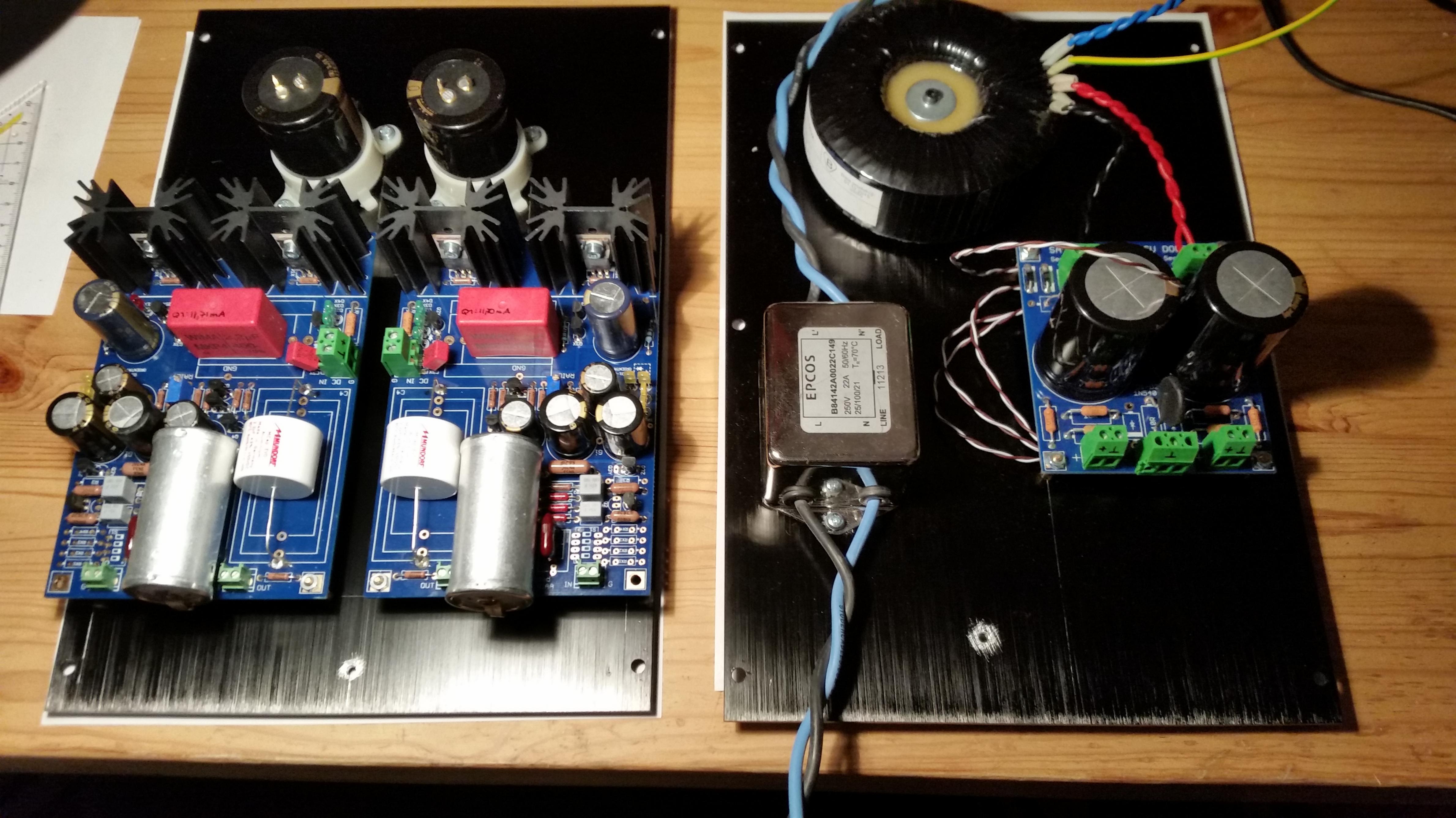

Added the 210 uf BGs to the LED bypass capacitors and there is an improvement. 60 uF is just not enough.
Details are revealed which were being hidden by the noise, though I did not perceive the noise. Was hoping PP capacitance had a multiplying factor! Will continue to add more "good" capacitance to see where it no longer makes a difference.
I had convinced myself that electrolytic capacitance was a little "fake" in comparison to film. I think there is no question, dynamically, there is something to this but I guess this is a fairly steady state situation.
Keep wondering about substituting the LEDs with a LiFePo battery. Using John Kenney's "hybrid" battery supply approach. One uses a regulator to float charge the batteries (would require three) to the voltage wanted. The batteries are quiet, unlike the LEDs. I don't know where I would put all of this so it is just something to think about. The mravica TI based regulator can give a fixed 7.8 or 7.7 volts - would that missing 0.05 make a difference? The mravica is very small which is why I am considering it.

If to consider adding PP cap to existing C8 (470uF) then what value are we talking about? Bigger is better? How about leads length?

If you are asking me - I used 60 uF of ASC PP oil cans because I wanted as much PP effect as I could get. The ASCs's do not come in any larger value or I would have used them. Not a bypass as much, more of a collaboration ...
My leads are approx. two inches. from can to PCB.

What is designers opinion on that collaboration of caps (470uF Ele and 60uF PP)? I think you're the first who tried that tandem on C8 since I do not remember anyone else here on thread who reported such mod.

The 0.05 won't make a difference
Yes I did consider batteries or chips and I decided on capacitor filtered LEDS fed by JFET CCS on at least comparable quality grounds. Its a dedicated shunt stabilizer there for the base bias not a quick solution. You could apply different things and make subtly different tone but that circuitry section was not an afterthought at all and it gave me the tone I was after.
