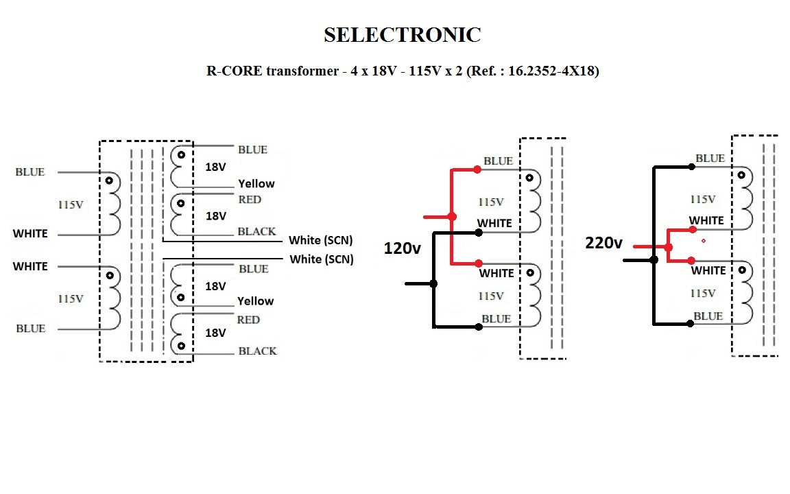

SELECTRONIC R-Core 4x18V; 115vx2 (Ref: 16.2352 4x18)
SELECTRONIC was nice and finally answered to my shipping damage report. They will send me one new trany as replacement for my broken one.
I made quick diagram that will help user to connect it correctly since SELECTRONIC does not provide that data.
