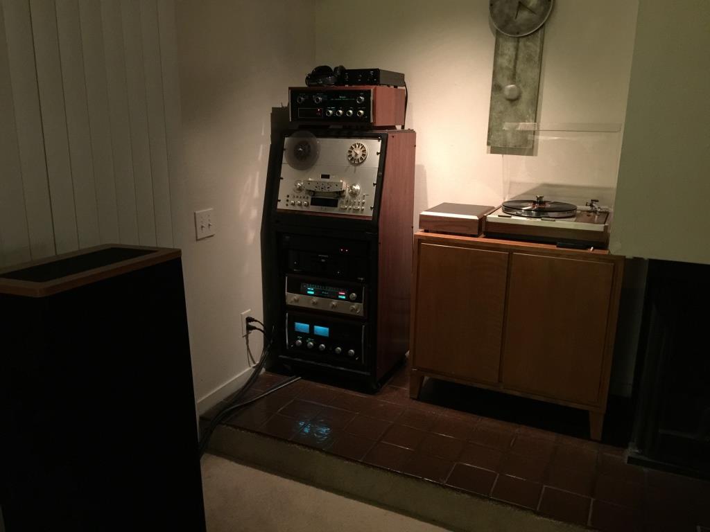

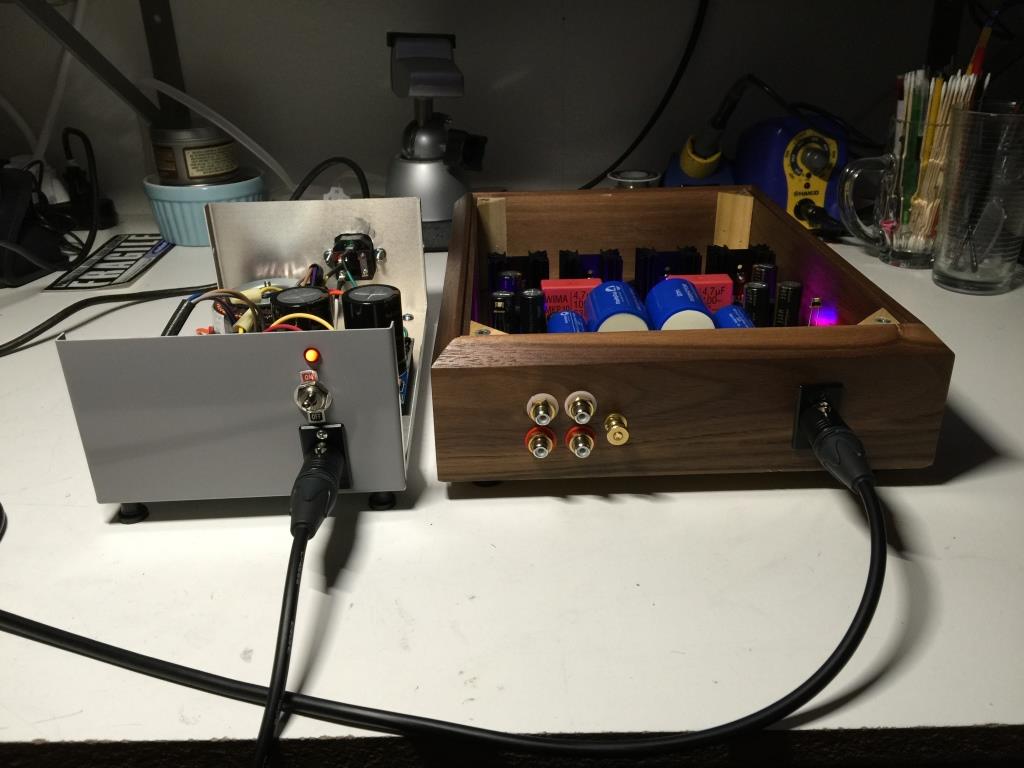

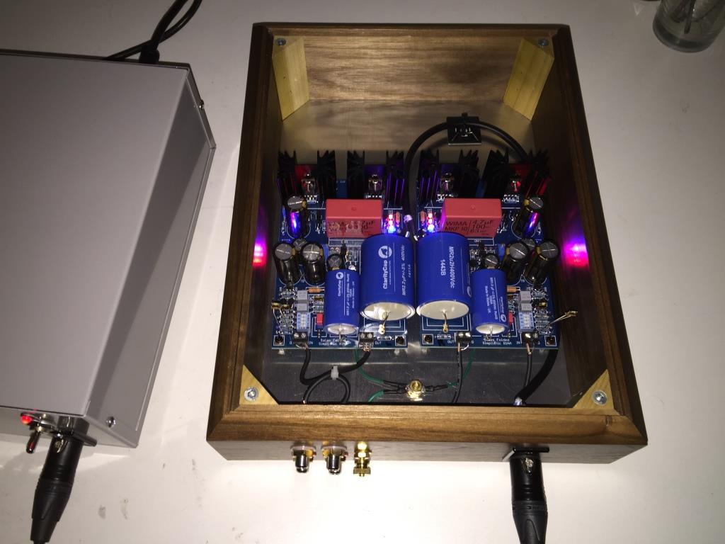

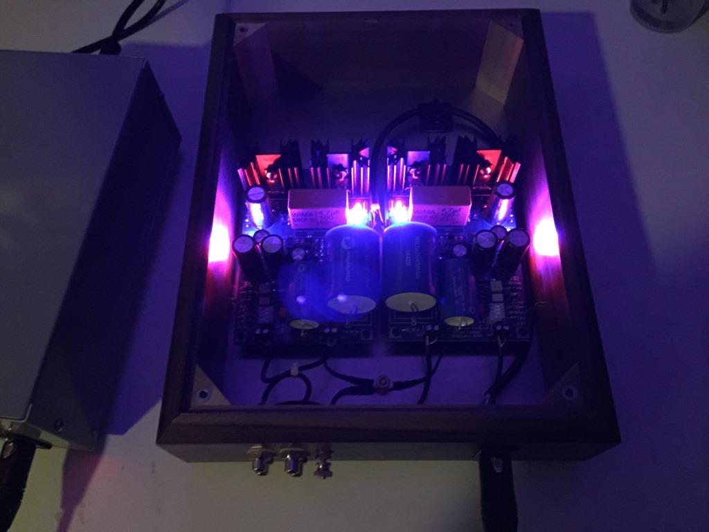

My FSP build is – for the time being – complete. I’ve enclosed a couple of pics including a “Stealth” shot for Salas. The power supply fits in the stack behind the tape deck. You can see a couple of Vishay z-foil resistors “standing tall” in the impedance circuits. That was to facilitate an A/B listening test with and without z-foils in place. (My present cart is a Denon dl-301ii, which I think does best at 330 ohms; so I installed a 330r z-foil in rx1 and a Takman Rey in rx4 to allow for quick switching.)
I had a couple of serious audio people in to evaluate the FSP and opine on the z-foils. At that time I probably had about 20 listening hours and about 40 power-on hours. Everyone was highly impressed with the clarity, detail, soundstage, and overall performance of the FSP. Interestingly, over the couple of hours we listened, the sound quality actually increased.
Without question, the z-foils impact sound . Detail is increased across all frequency ranges. I had read reviews (mostly by z-foil vendors) of the benefits of this resistor; but, in this case, the reviews were accurate. As to value for the price, if you were building a USD 200 soundstage, you would probably want to think twice about spending USD 15-20 for a resistor. But, there was no question in any of my listener’s minds about the sonic impact – and monetary value - of z-foil resistors in the FSP.

Nice build! And yes z-foils make a difference at least in cartridge loading in this phono.

Excellent in system results and nice pictures. Beautiful vintage gear. Congratulations.
