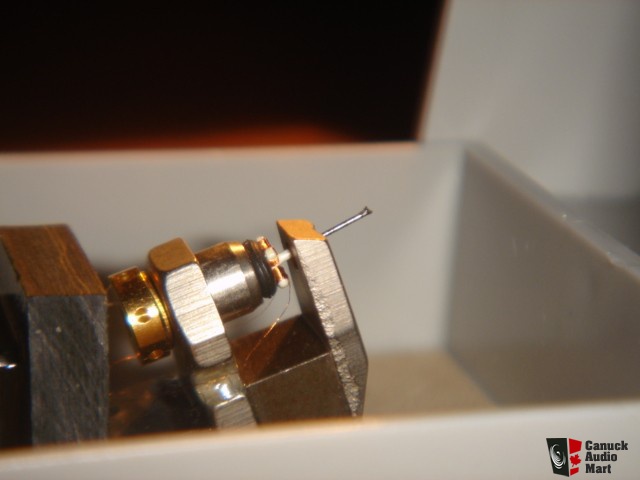

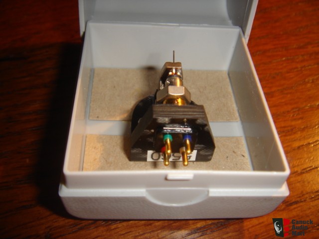

The cart plays normally after that test?
What cart was tested this way ?
A modified Wilson Benesch
It is called Ply. It is made by Bentz Micro for WB as OEM and it is based on mid output Glider. It has carbon fiber body.
I know that cart. I had the pleasure to listen to it on a WB TT connected to my folded.
I also have a Glider in my main system.

What type of DMM did you use to measure the coil resistance ?
I used my Fluke 87 V. I already assumed with high probability that something is wrong with my cart since all other components were tested and no issue were found. It is interesting for me how to measure carts (inductance, capacitance, impedance ans ect..) if need with no risk of damage.

Please elaborate... how can you be sure the fluke does not damage the cart's coils ?It is interesting for me how to measure carts (inductance, capacitance, impedance ans ect..) if need with no risk of damage.
It is sounded like "A" and after I measured it with Fluke and connected it back to leads it is still sounded like "A". No differences.
I do not think that I melted lacquer of coils and they shorted by Fluke. I assume they were shorted prior my test.
Came to the local stereo shop and borrowed what they have in hand. It was MM 2.4 mV. Unfortunately, no MC with Low output. Installed it with 70+ FSP and dead quite in max volume. Set volume to 5-10% and played it. Harsh on highs due to overkill of gain, but no noise. Very quite.
So, I made conclusion that my Ply is bad. I ship it back to re-tipping guy.

I'm almost more curious how he might have caused the issue!
For sure, I can't guaranty for 100% built proof, but I do not think I damaged it by connecting it to one of my Phonos or even to Fluke. I got that phenomenon with noise as soon as I received it from re-tipping. This is why I installed SUT with 5dB like isolation trany into the FSP input. Salas helped me to got the most quite connection experimentally.
Hi alexkosha,
The Fluke, and most other good meters in that range, uses about a 1 mA constant current to measure low ohms. The current drops as higher ranges are selected. 1 mA will not harm any MC coils, especially for the short time it takes you to measure.
The only safer way to measure your coils is a good AC LCR meter. My bottom of the line Agilent 4263A can use a 50 mV signal at various frequencies for measurements. I would hope anyone who works on cartridges would have at least this to use. Inductance would be very handy to know in the audio band.
