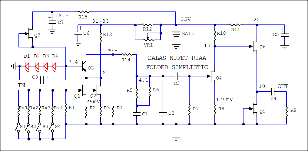

I am ready (almost) to pug in my "Folded"
I have spent a few good hours of fun to find out that none of the components I had to get off the board and test where faulty.
All it was little J117 whit hi currants (as in black currants) requiring 33 and 6.whatever K instead of Boom values
This is in the instructions BTW but one could not bother reading them?
So day after tomorrow once this week 60 hour shift at DAY job is over I am going to find same more faults (hope not I am going to plug the lot in, throw her out of the house whit an excuse (here Love get £50 go and spend it all on me) and enjoy a few hours of pure bliss )

I was wondering: has any one ever posted the circuit diagram whit annotated typical Voltages and such.

Meantime I annotated for you the voltages on the main phono circuit. All in reference to ground. Keep in mind those are rough numbers because each one FSP will ask for a little different rail voltage to show correct TP. It will also have different source resistors for different IDSS 369s. But you can still check if its in a logical order by looking at those numbers.

The 9.2 k vas giving about 2.65 V not enough to drive shunt (???) while changing the 22R to 33 R was enough to drop from 52 V to about 42
I don't think I caused to much damage else where as voltage would have dropped considerably across R1X (15R ?) due to current
R3x should be giving the major voltage contribution for the shunt's Vout. Its drop should be Q3x's in circuit IDSS (about -20% than its free IDSS) times R3x Ohmic.
R6x 22 or 33 should have an impact on Q2x's dissipation and a small difference on D2x D3x D4x total Vf as a group. Say you have 48V raw DC then you must have 42-43V DC across Q2x
