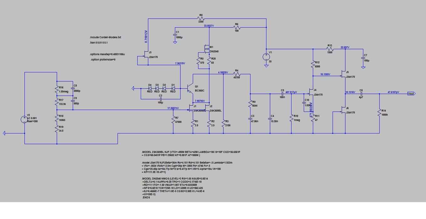

Hi Salas, I'm building a balanced one with one 369 for 56 dB gain and I'm intrigued by the possibility to use a CCS in R13 position. You suggest a Supertex DN2540 ( ...and I get a lot of them), but I have a single 369 and I need only 9mA, not 18. Can I use a K170 with the same Idss , tying G and S and connect it in the R13 position? IMHO ccs bring always a great sense of air and musicality over the simple resistor polarisation... and remain a simplistic thing.
diyAudio Chief Moderator
Joined 2002
If it can handle the dissipation in the long term (there will be high VDS), maybe use a TO-92 sink, you can try it. It will inject some own noise too but you may not object. The Supertex is not doing a good job if asked for less than about 20mA anyway.

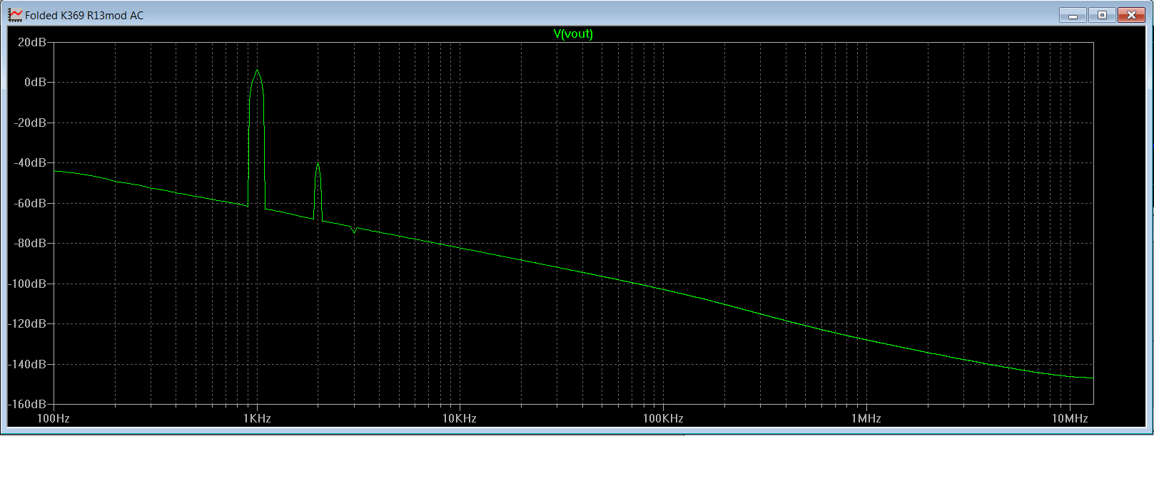

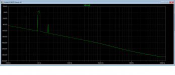

Been simulating the R3 Mod with the Supertex depletion mode mosfet and found that with a CCS instead of R3, VR1 trimmer action is irrelevant.
Once we find the correct CCS current as to bias the folded half way, trimming R12 only changes Vds in the DNMOS..... It might change something sonically but does nothing in biasing terms.
Maybe we could also do without C6 if using the ccs ...?
