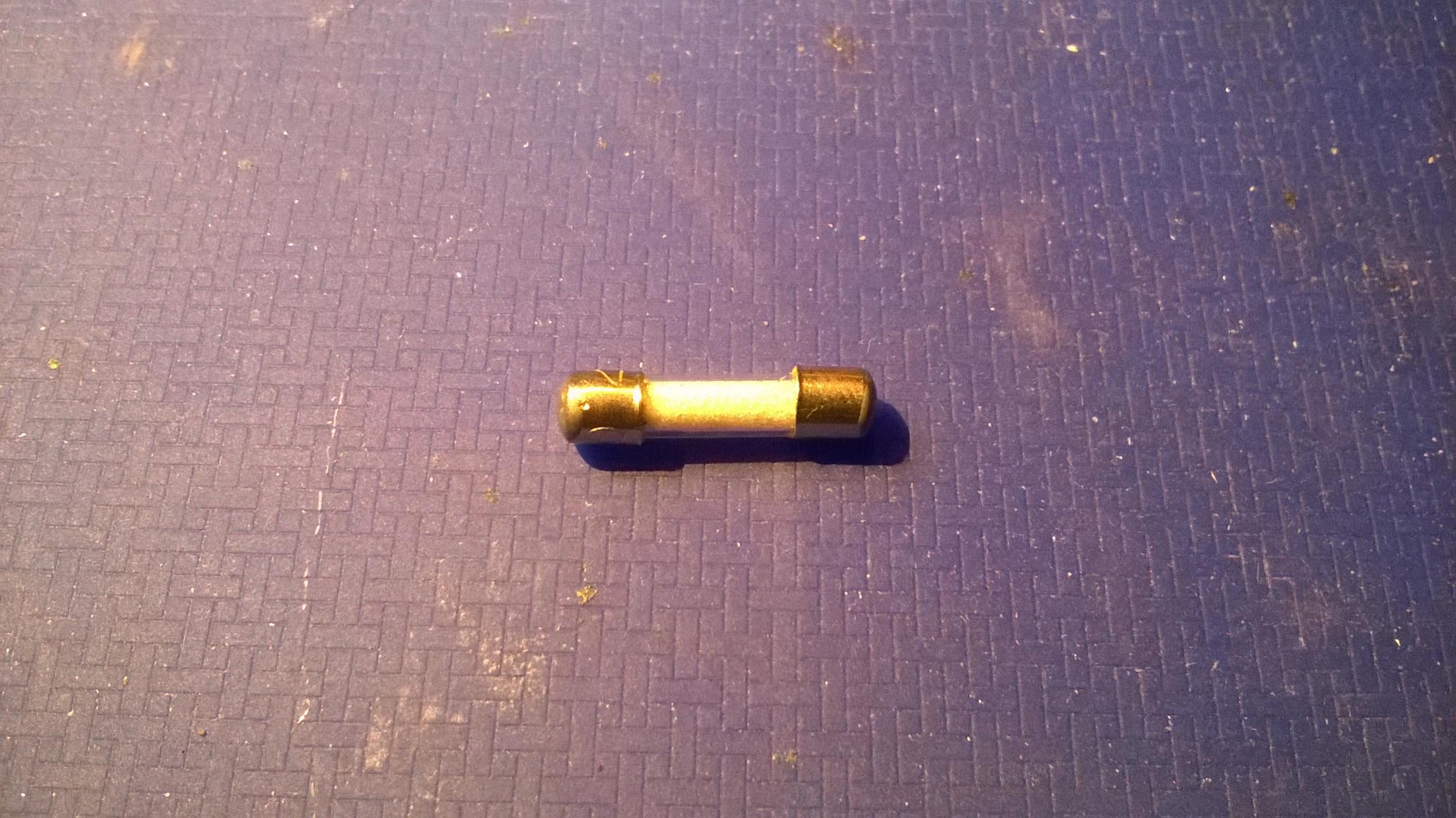

I don't fuse there but to the primary so I haven't looked at surge current to both the regs. Start at 250mA slow blow?
OK, I have to wait till tomorrow morning because I don't have any 220R of this huge power.
You need test with dummy so to know raw DC is no more than 52VDC with your CRC loss under 200mA load and at average day mains.
If it has T (time) symbol etched somewhere.
No. Slow I only have 500mA or tomorrow I will buy your advice for 250mA?
I designed for 45VDC with the CRC and the 200mA of load.
Buy for 250 and 350 bcs I haven't tested in that position you want to fuse as I wrote.
