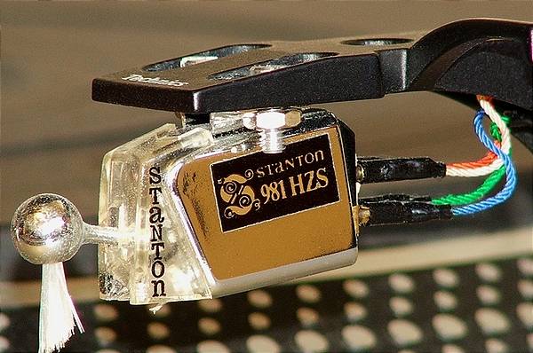

I remember that cart, never listened to it though. It was Stanton's best they used to say in the press. Behaving like an MC that you could exchange its stylus kinda.

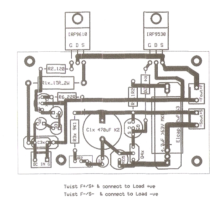

I have bought the latest pcb for this project but I would still like build my own MM version. I know it may not make sense to some but I'd like to make my own prototype.

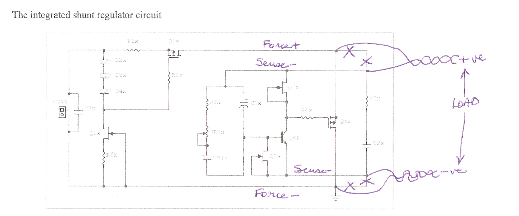

My question is about the Force and Sense circuits in the regulated power supply. I attach 2 scans: one of how I interpret the F & S circuits and the other is my circuit design. I hope both easily legible.
Can someone who has built his own pcbs comment on my attempt?

You separated them alright. Better use R5x C2x as part of the "force" section. The FSP board does use sense and force separately despite the conceptual schematic BTW.
I think the two force wires should be twisted as a pair. They are the flow and return of the main power feed currents.I have bought the latest pcb for this project but I would still like build my own MM version. I know it may not make sense to some but I'd like to make my own prototype.

The two sense wires should be another twisted pair. Again flow and return of the sense circuit currents.
In addition the sense circuit with it's extended wiring needs maximum attenuation of interference confusing the measurement of the voltage errors at the load.
The PCB should also maintain these pairs (for traces passing the same currents) to minimise the effects of interference.

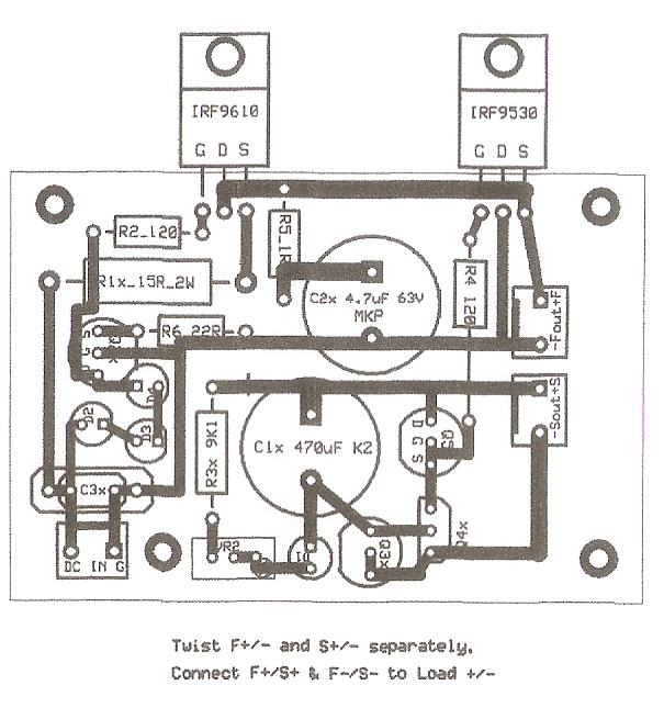

I have redrawn my pcb layout as per Salas advice and would like you to have a look to make sure I understood correctly. I have a couple cylindrical MKPs which I'll mount vertically.
When I made a similar HV Regulator (again by Salas - thanks!) I didn't have much luck. But then, luckily a DIYA board was made available. I don't wish to go the same route!
They actually made one to even better specs - not sure of if I'll go for that one - the WOS-100 something.
I believe its an selected 981 HZS. I've sampled this direction as far as I'm wiling to go and have som truly amazing carts to put in the drawer - to enjoy at times... So the Stanton/Picering paths carts and needles are in the safe now.
