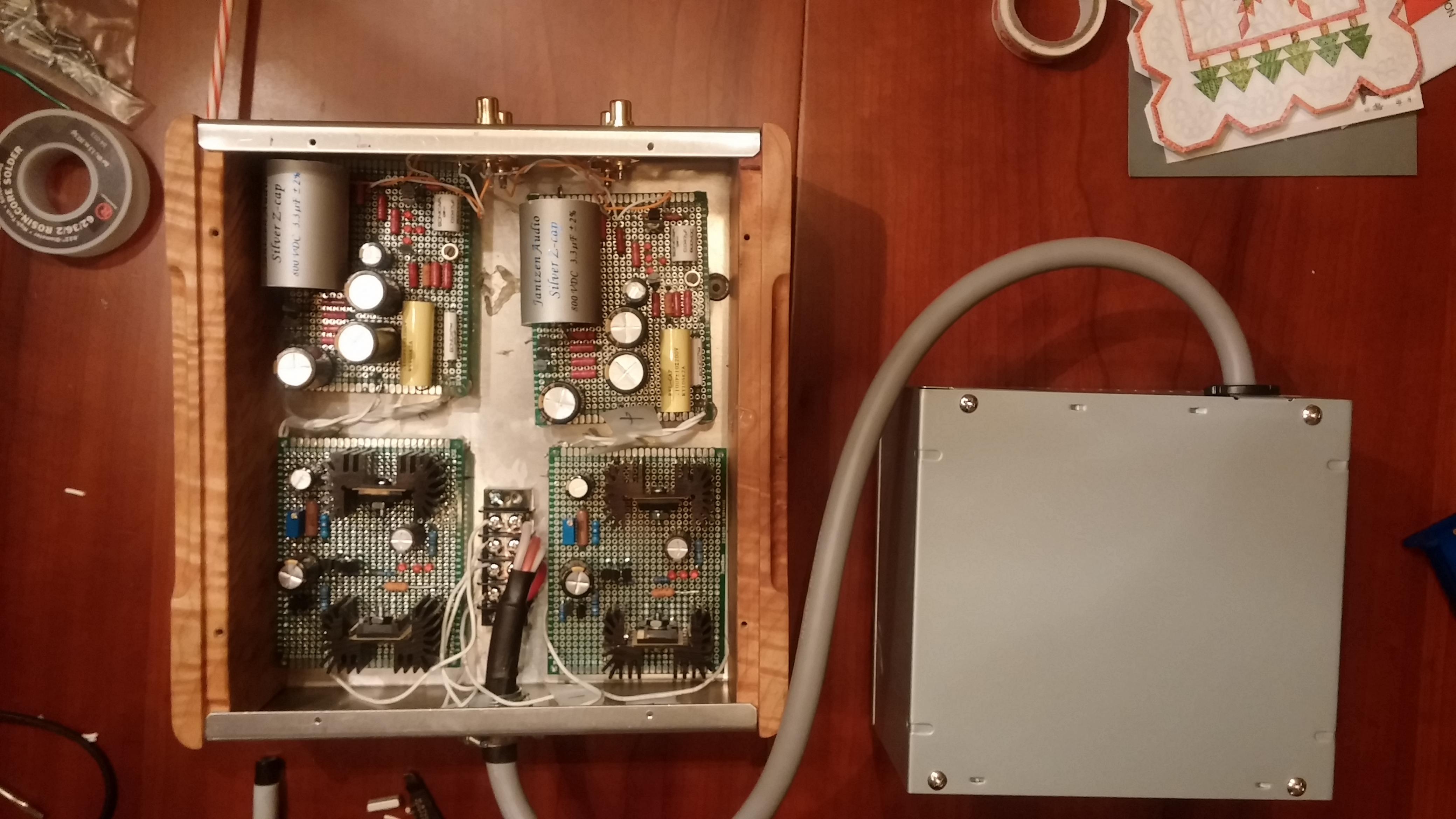

Antek is good. The ones with the shield are the "AS" series. Iam using one in my ba3 preamp. Also, i have a 38v antek Iam about to use with the salas shunt for the salas phono stage. Just have to build the other channels shunt and I can get rid of the batteries.

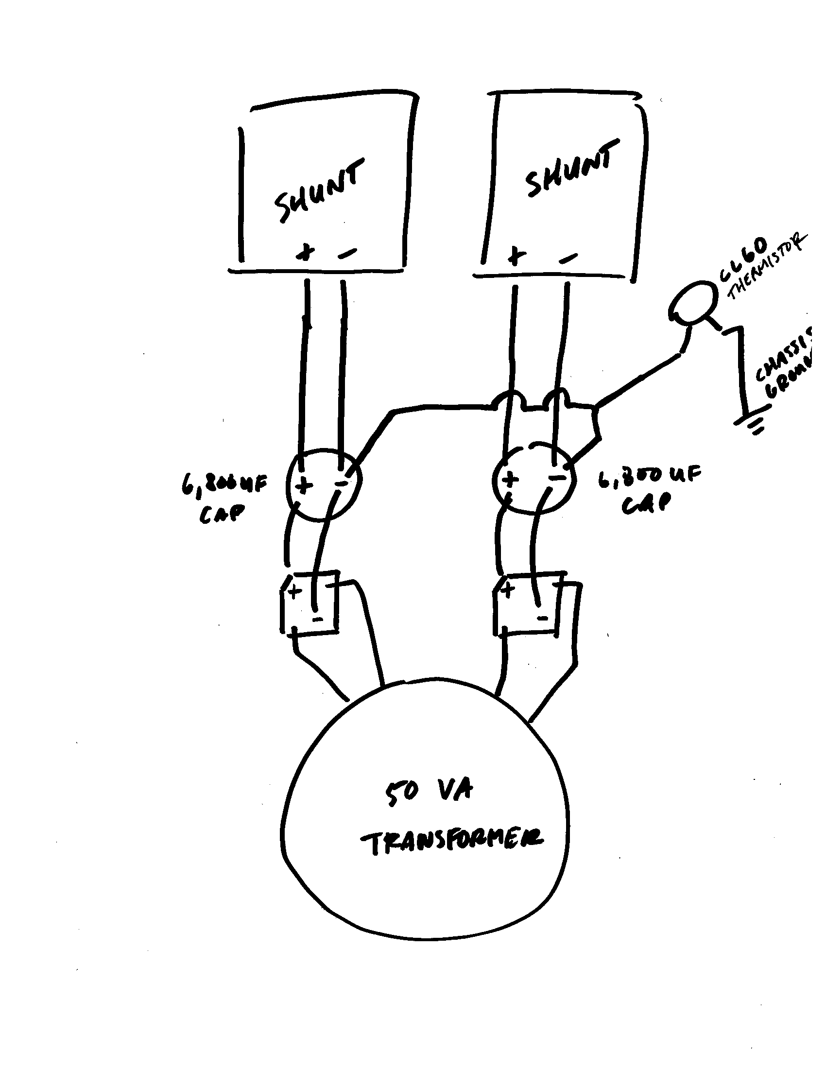

Thanks Salas. I am thinking about the transformer and caps now. I am going to use a dual secondary transformer, one secondary per shunt. Is it better to leave the grounds of the two supplies separate or is it better to connect them at the negative terminal of the caps (see attached)?
I can recommend the grounding arrangement as shown in the build guide.Totally hum free listening in both my MM and high gain MC versions.
Don't add zero ohm loops.Thanks Salas. I am thinking about the transformer and caps now. I am going to use a dual secondary transformer, one secondary per shunt. Is it better to leave the grounds of the two supplies separate or is it better to connect them at the negative terminal of the caps (see attached)?
Keep them separate and ONLY make connections WHERE they are needed.

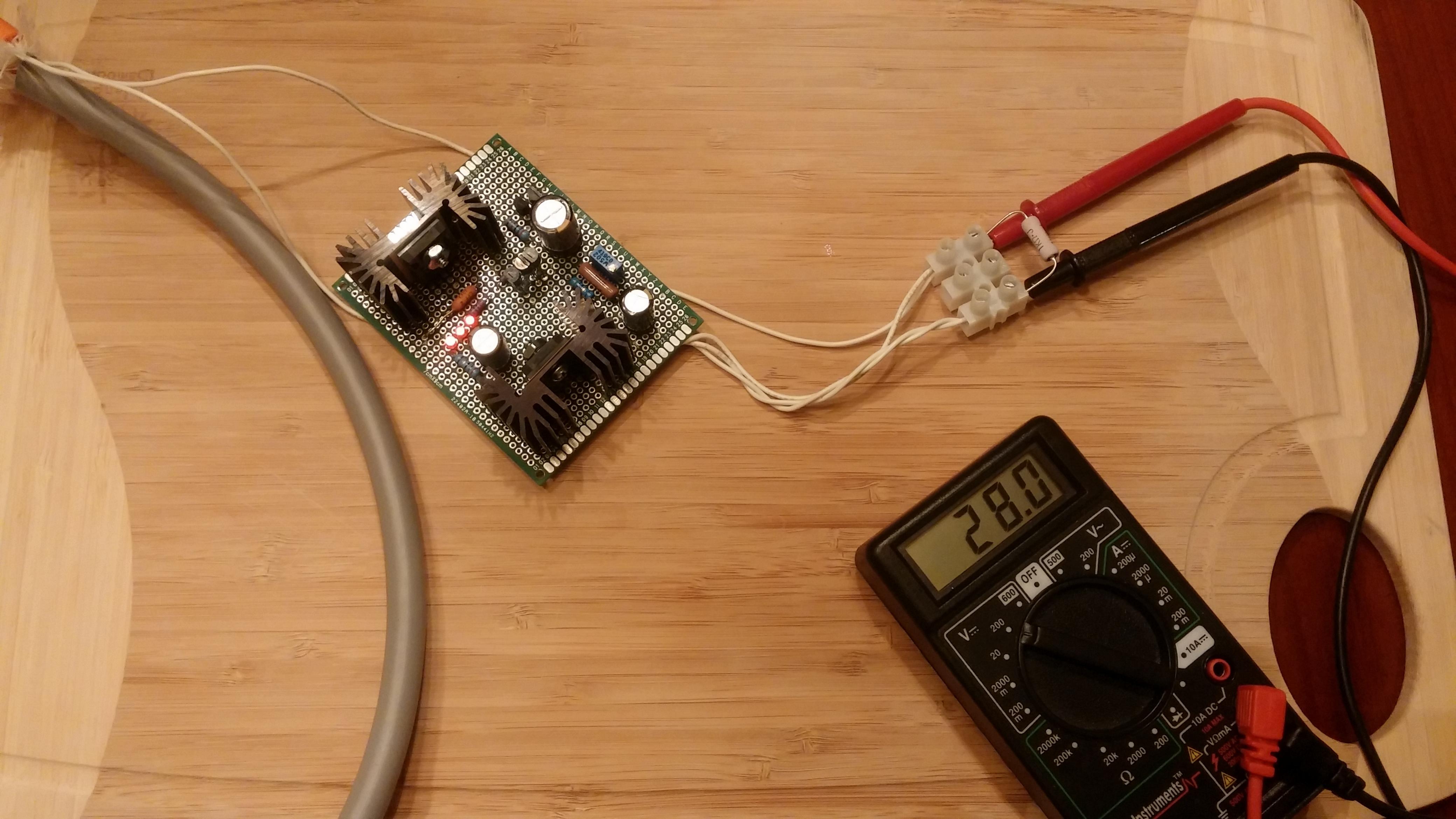

Whoa...how hot are the heatsinks supposed to get on the shunt? I can hold my finger on them for maybe 2 seconds max. They are pretty hot. Its a 1.5 inch tall heat sink on the shunts and the case is open right now it will get hotter closed. Should I be worried?
Small sinks for 10R R1. They used larger ones or the floor of bigger boxes for that version. Use 15R later.
Thanks Salas. I will try 15 ohm for R1.
I have to say, so far I've used the shunt for a few hours and it is better than batteries. Bigger, more dynamic. But Ism also going from a single battery supply to dual shunts. But I like what Iam hearing so far.
