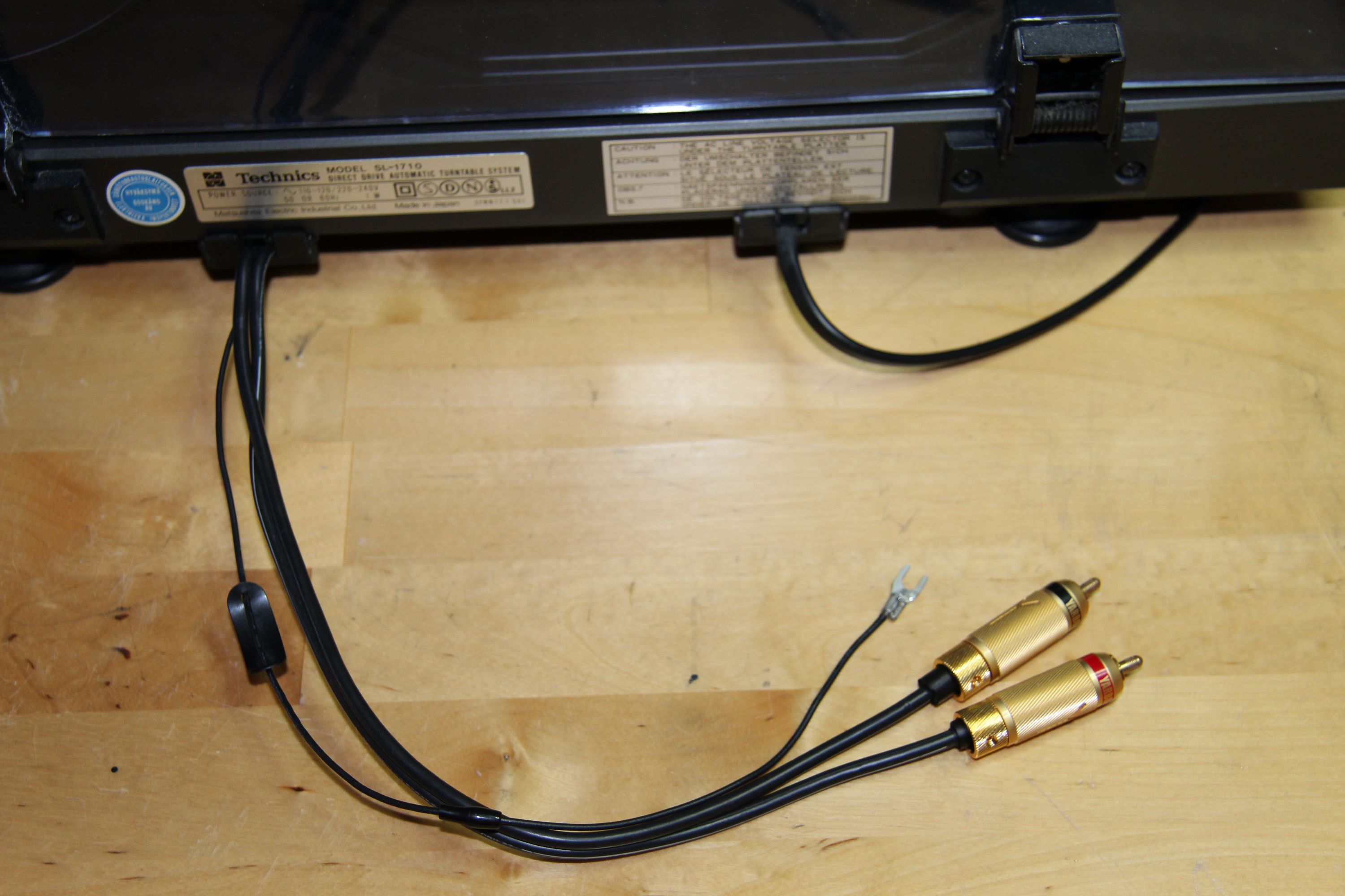

New ballz please:p
Ultrashort. Gonna change into 4-pin XLR and new cables later on. Gotta give those a chance so I can see if it makes a difference.
Joined 2011
I also rearranged things a bit. I turned the cablings to be the backside so now the internal signal cablings and amp-parts of boards is facing away from the poweramp. All hum is now inaudible with pot on half even with ear in cone, both channels. If i max the volume I can hear some very low hum.
Joined 2011
Is XLR better than phono for interconnects though?
I've never had a problem with Phono when using Neutrik phono plugs and sockets. Those cheap moulded Technics ones are terrible.
I dont think so. I just hate the technical concept, they always get stuck in narrow places.
I am neither a fan of big chunky metalparts acting as antennas for the signal ground.
Playing at some 3k2 load now. Sounds great.
